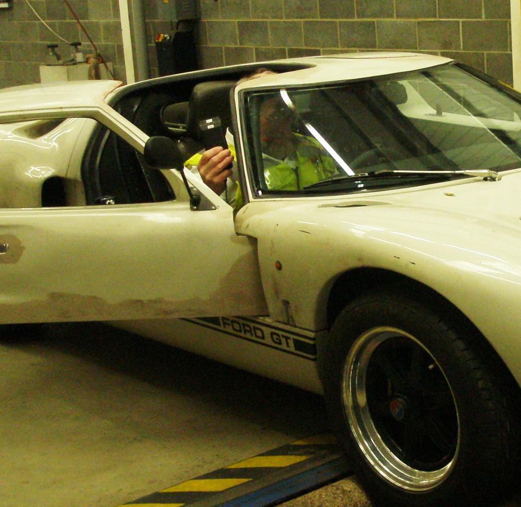

Thanks Andy excellent, probably on your build thread but where did you mount the mirrors.
Correct on the square nuts.
At least I know they should be very impressed with my steering wheel pad / cover ;)
Hi Nick
postion of mirror as below. The passenger mirror was mounted further back to give a better field of vision
Rgds,
Andy

Ah, I thought they were required to be adjustable from the drivers seat while driving, that will make life easier....
Ian Anderson
And if you do that you can be fined for driving without due care and attention as you are not paying attention to the driving part of the job in hand
