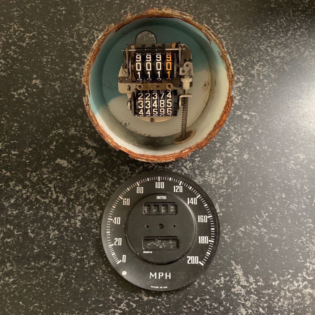

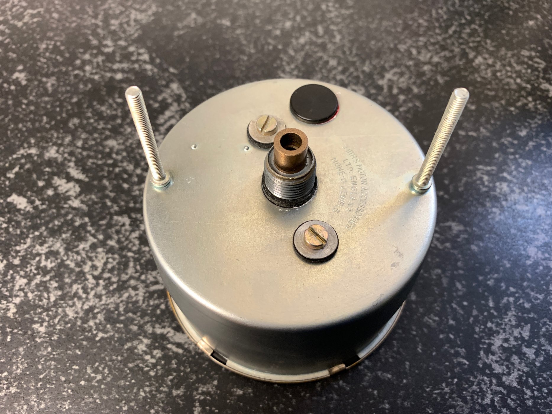

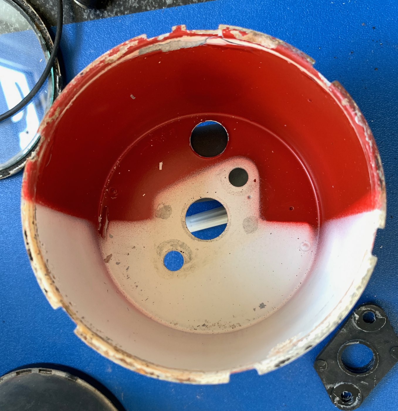

It has been a couple of years since I first opened up a couple of boxed NOS speedos only to find how badly the paint finishes had deteriorated even after being stored in a dry cupboard.

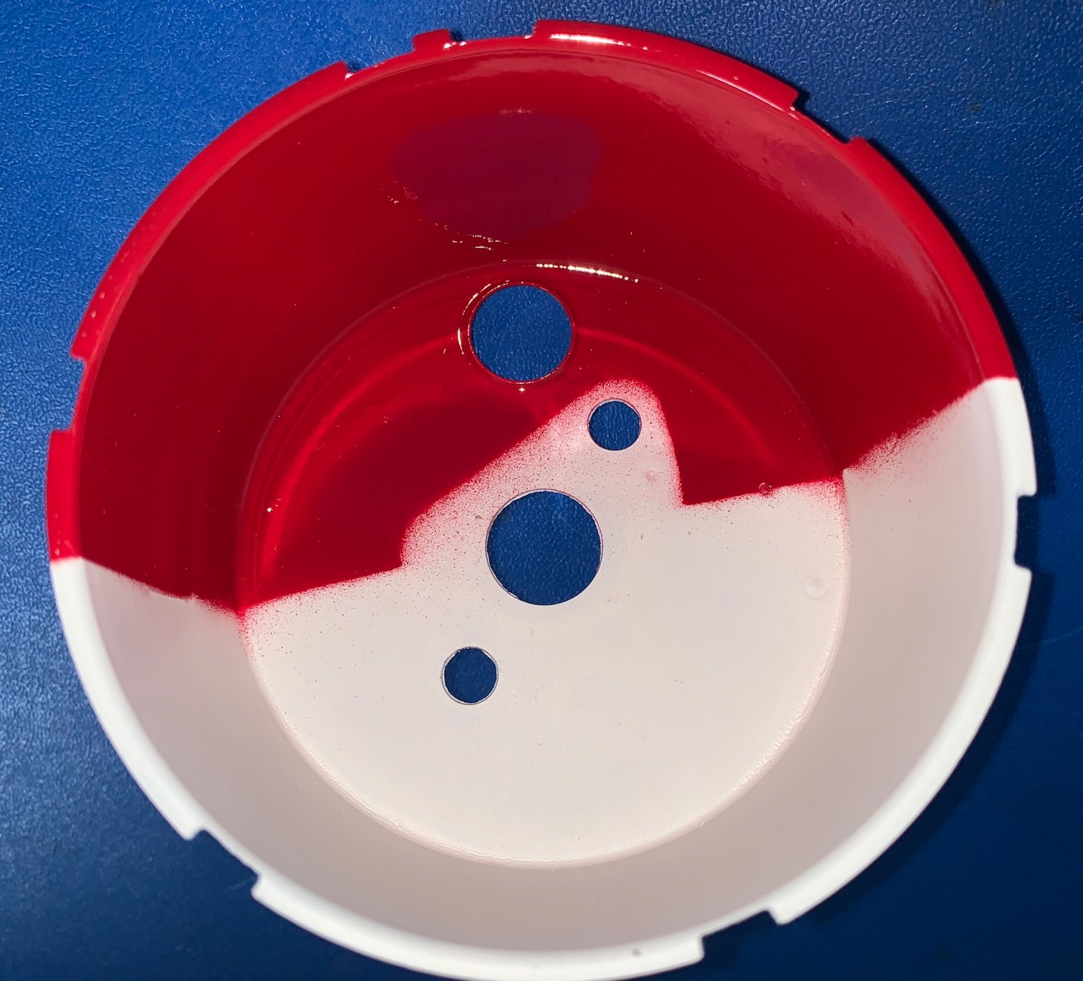

Anyhow, today I have finally restored what was a new unit to complete my set of gauges.
Sept 2020
Before stripping and re-plating
Today
Painted and ready for new bezels and gaskets
Speedos??? o_O :rolleyes:

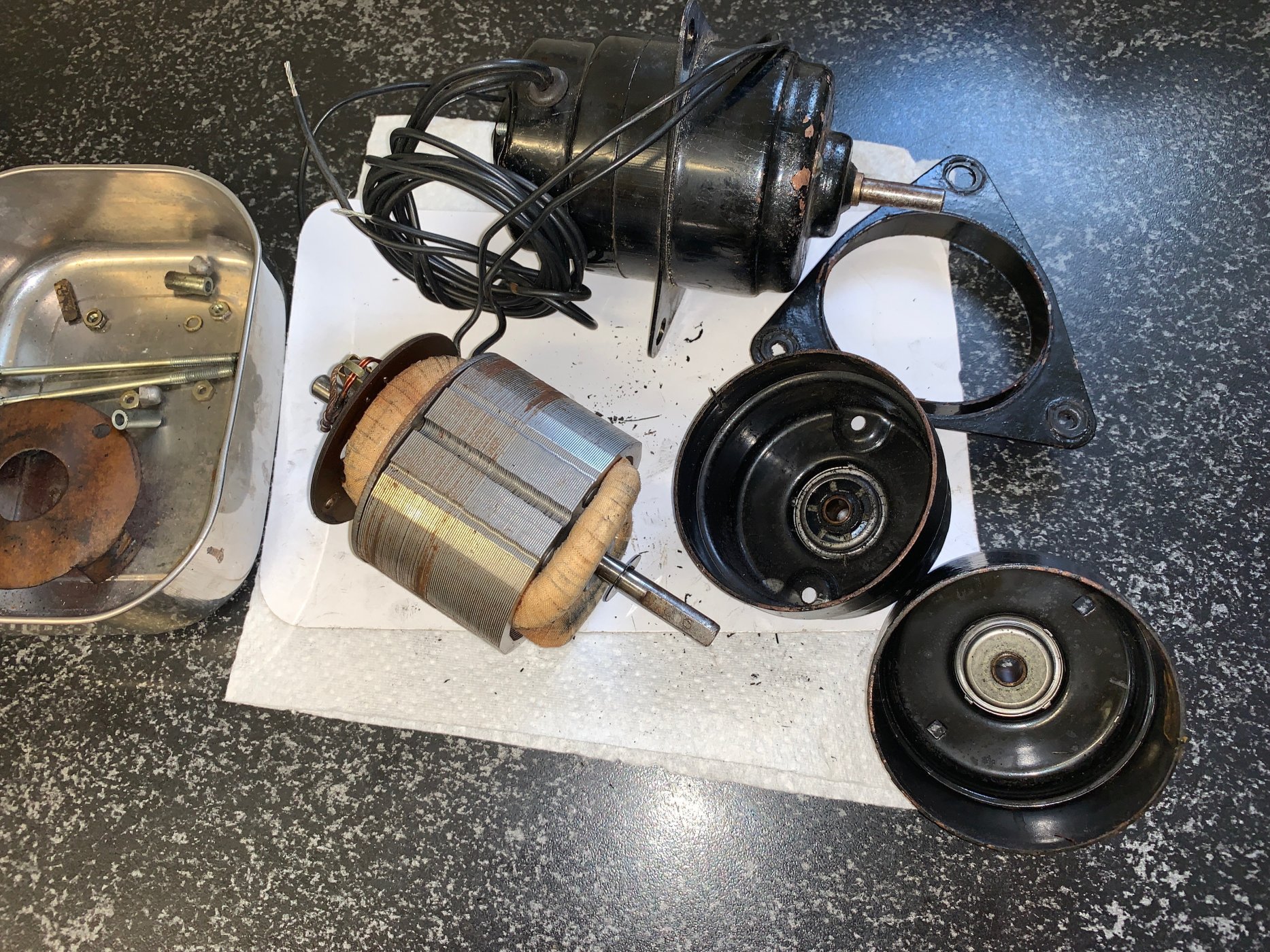

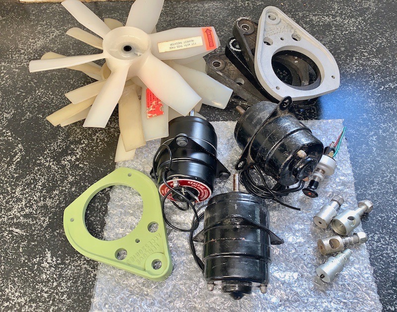

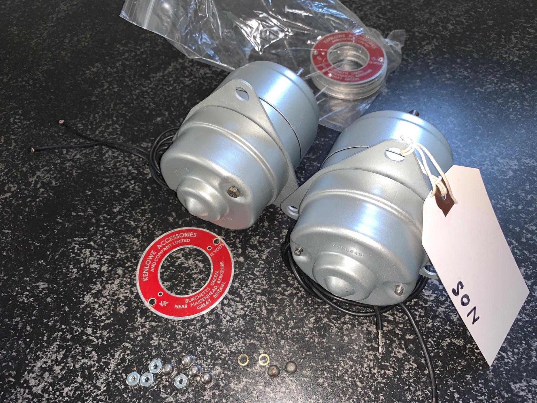

Working on some more Kenlowe fan motors which are good enough for restoration.
I will refinish two of the cases in silver.
The condition of the nylon props with the labels is evidence that they have hardly been used.
JimmyMac

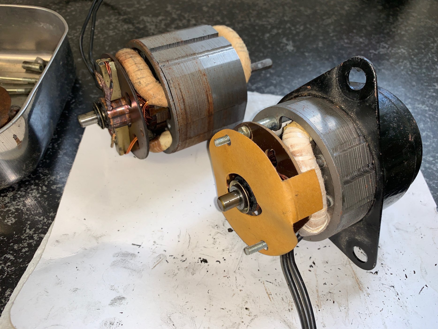

I opened up the two motor casings this morning and was pleased to confirm my hunch that these units have been little used.
The stator plates have no sign of corrosion which was a problem with others that I have worked on previously, because the cases have no seals to prevent ingress of moisture.
There is also little carbon black from brush wear so all things considered this is a nice pair of sixty years old fans.
JimmyMac
The second one is completely unused and unmarked internally with no brush wear. Not even with dry WD40 on the stator like the first.:)

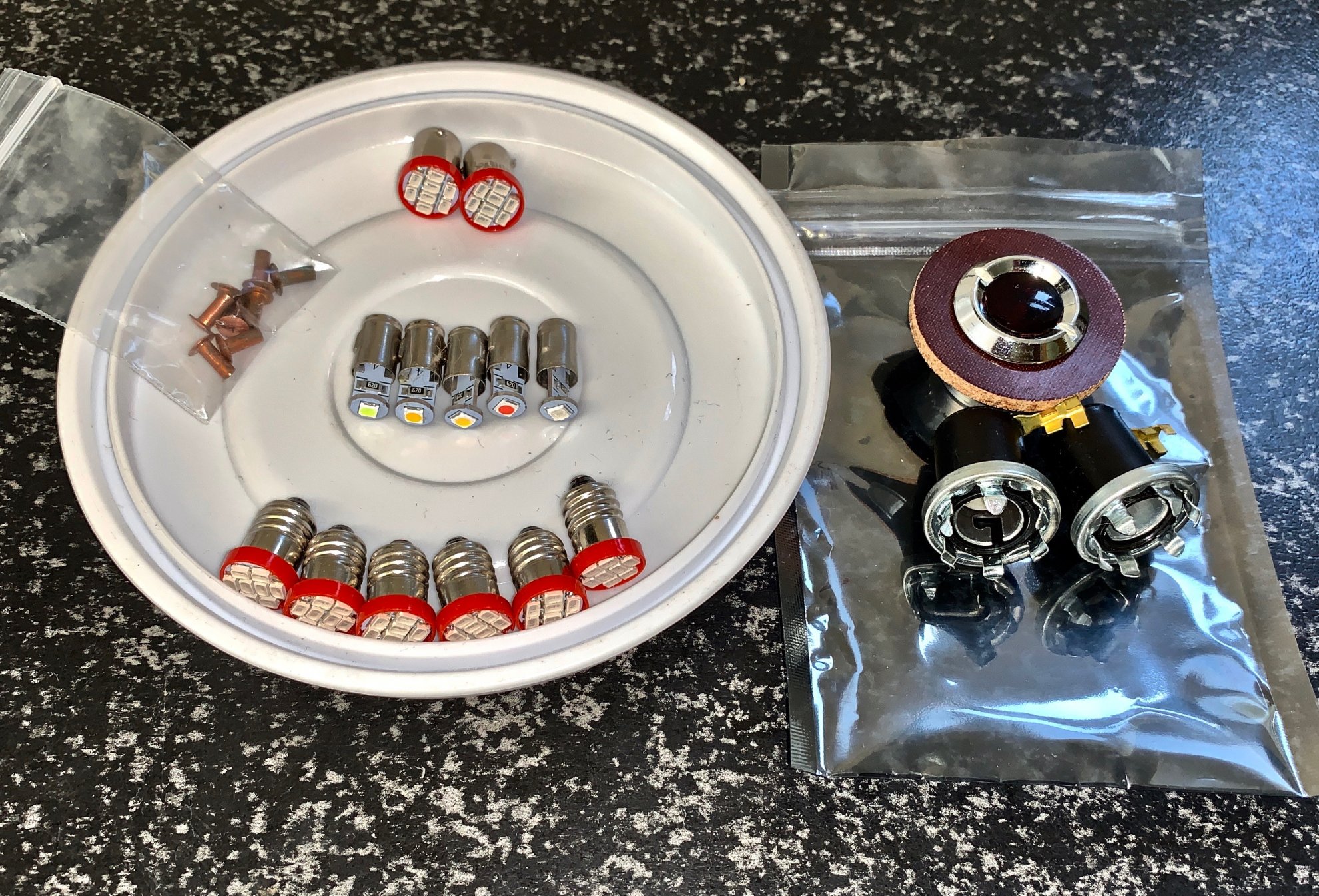

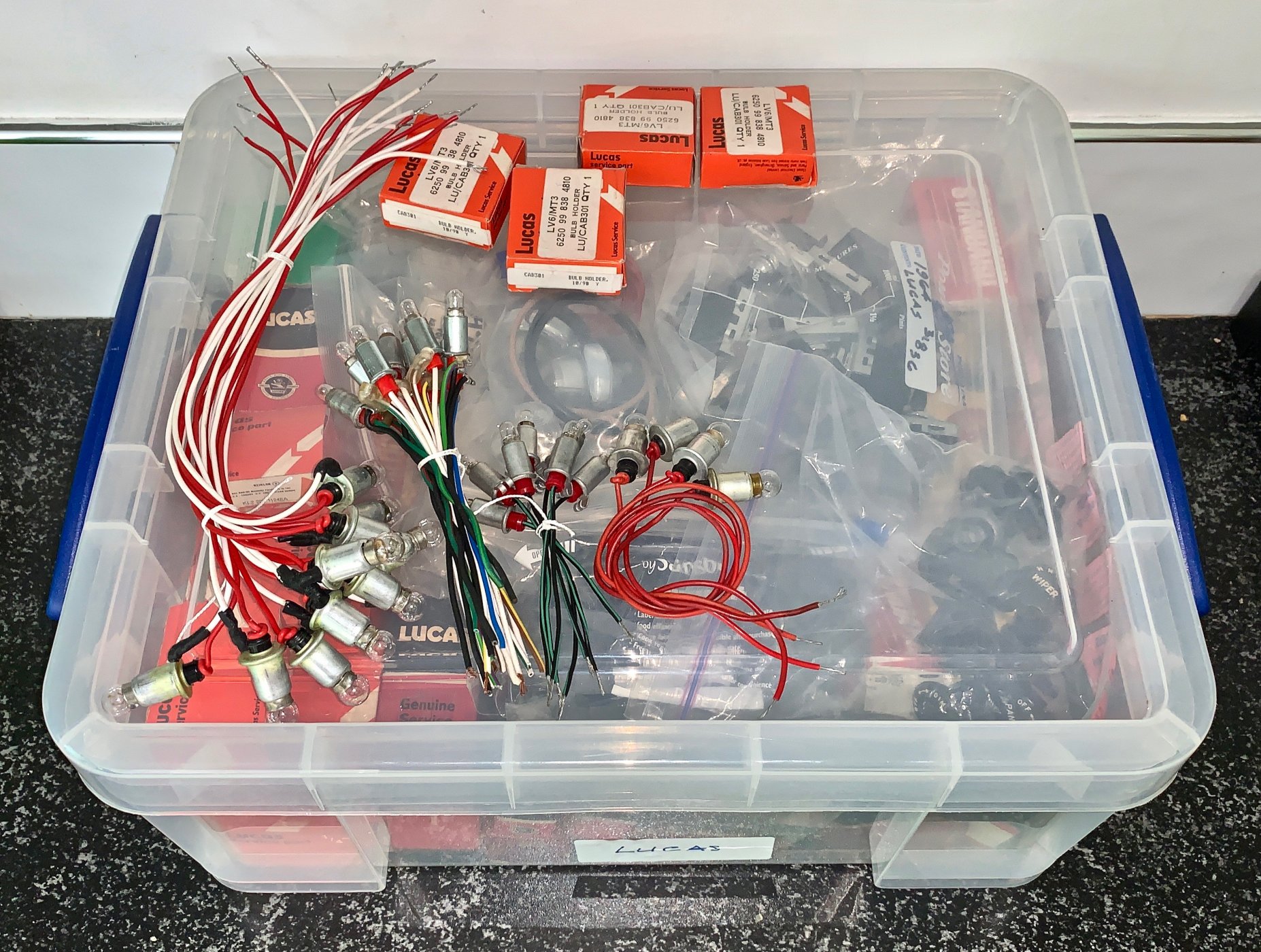

I am fitting my gauges imminently and have decided to go with red illumination in them as original but using LEDs to last.
So whilst my dash is off the chassis I will also make up new bulb holders with the correct coloured pigtails. (Red with White trace & Black earth)
The modern Lucas bulb holders now have skinny +ve contacts so I will also retrofit soldered solid copper contacts similar to the old 60's versions once made in England. These contacts should also improve the longevity.
Also fitting higher quality bayonet bulb holders for the 4" gauges and any other BA9s.
JimmyMac

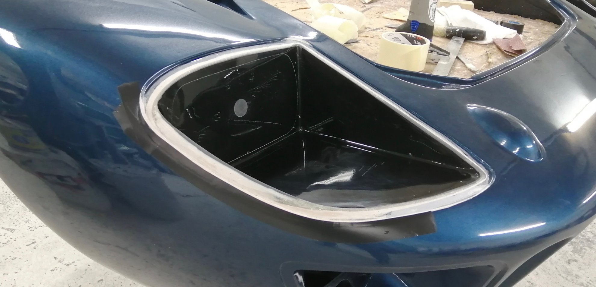

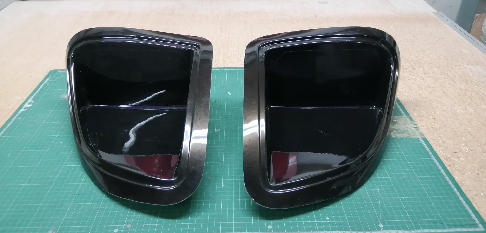

For years I never did like the profiling job my previous painter had done around my headlight cover recesses, the draft angle on the fibreglass mold work in the boxes was also too steep and restricted internal space around the light lens.
Anyway not worrying about destroying an expensive spray job I put off the decision to do something about it for too long.
I contacted Lee and he made me a pair of crisp new boxes and last week he retrofitted the complete assemblies for me. The Marchals now fit better and so will the plastic covers when complete. The black tape on the paint shows the extent of new cover shape.
Very happy now.
