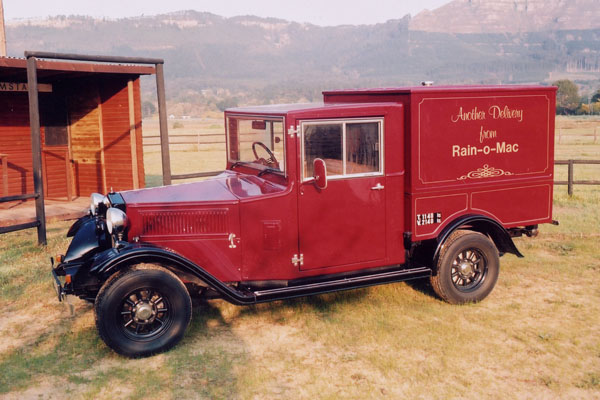

My friend Jeremy Kilpin, a perfectionist car builder, used to build the Brindley replica commercial vehicles at that time. They were converted Mazda B1600/1800 pick-ups whose massively strong chassis and reliable engines would outlast the bodies that were prone to rust. They were therefore ideal donor vehicles for the Brindley that was built in van, pick-up and station wagon forms. The vehicle was named after a forebear of Jeremy, James Brindley, a canal and mill builder in the northern part of England in the 18th century.
The Brindleys were so authentic in appearance that they could have been mistaken for original vehicles. Jeremy even had his own wheels made up. In fact Jeremy relates an amusing story when he and his wife walked towards their Brindley in a car park after having had dinner in a restaurant. He noticed an elderly couple in front of the van and the old gent was peering intently at the badge on the radiator shell. He said to his wife, 'Yes, I remember the Brindley well.'

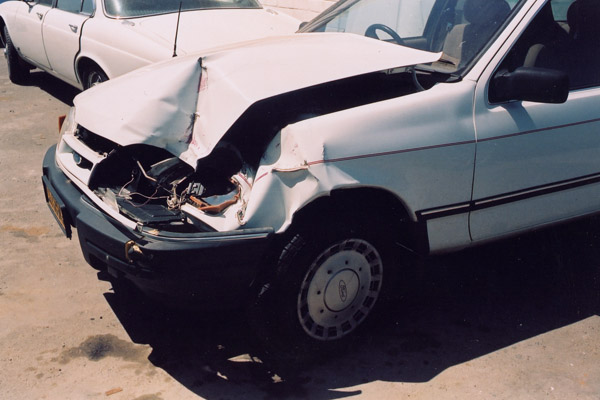

At the time I assisted Jeremy with the marketing of his Brindleys and one afternoon as I was approaching a motorway/freeway I noticed our friend Daphne in front of me turning on to the on-ramp. She then drove off the on-ramp and parked on the grass verge. Thinking that she had broken down I parked the Brindley van right under the overhead motorway and started running towards her. I had covered only a few paces when a white Ford Sierra appeared and smacked the Brindley full on without slowing or braking at at least 30 mph. Despite the fact that the van's hand brake was full on it was pushed about 30 feet along the road. It jumped the kerb and headed straight for a lone jogger running along the pavement. Bear in mind that we drive of the left in South Africa. The van was hit on the right rear corner and was pushed to the left.

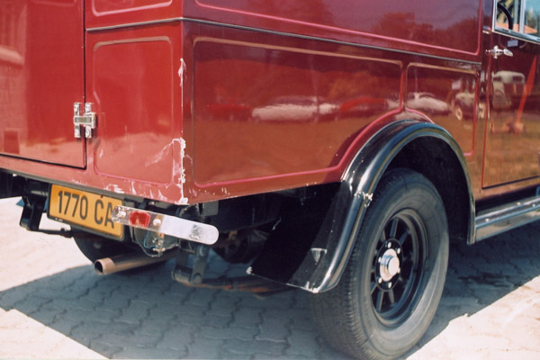

Anyway, now the point of the story. The Brindley's van body was a fibreglass shell with no steel reinforcing. The only steel component was the sub-frame which was attached to the Mazda chassis and this did not extend right to the back. The Sierra therefore smacked pure fibreglass.
From the photos it can be seen that the Sierra didn't look all that good. The Brindley only suffered some cracks and marks. The repair bill for the Sierra was R12,236 and to see that figure in perspective a new Sierra 3.0 GLX cost about R50,000 at the time. The Brindley's repair bill R1,590, nearly eight times less.
