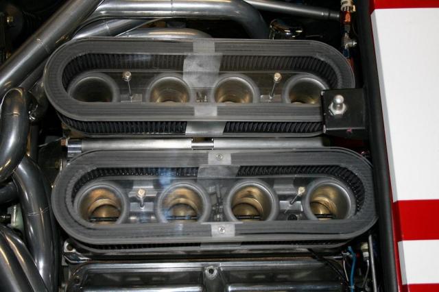

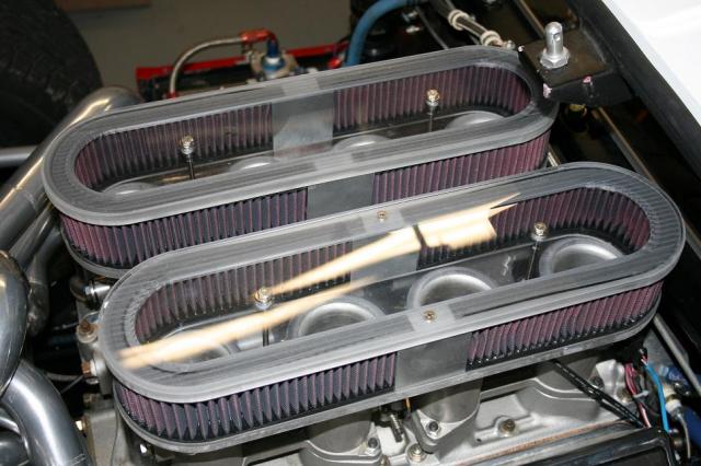

Our very own Jack Houpe (2164) here on the forum can provide you with filters using K&N elements with a lot more area than those that you looking at. Here are some pictures of his prototype. He new filters do not have the metal spacer in them.

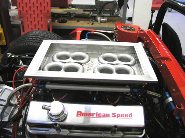

If space is an issue you can fabricate a flat bottomed air box similar to that pictured below that will hold a flat K&N filter. (I know the one pictured is a Chebbie, but not hard to do for a Ford with IDA's)

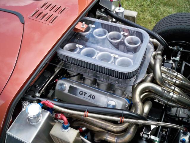

He can make them with as tall or short a filter element as needed to fit the clearance.
The bottom plate of the filter can be installed below the velocity stacks allowing for a taller element and actually better flow to the stack with them installed "inside" the filter assembly. This will yield more clearance to the hood yet have a large filter area.
The assembly can be a large oval "sorta" like the one he made for my GT.
Here is a picture taken by Ron McCall of my filter. Got to give credits these days or get in trouble.
Jack, you can chime in here anytime now and keep me honest.
