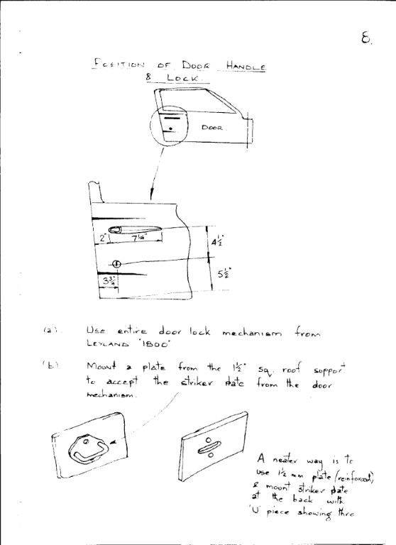

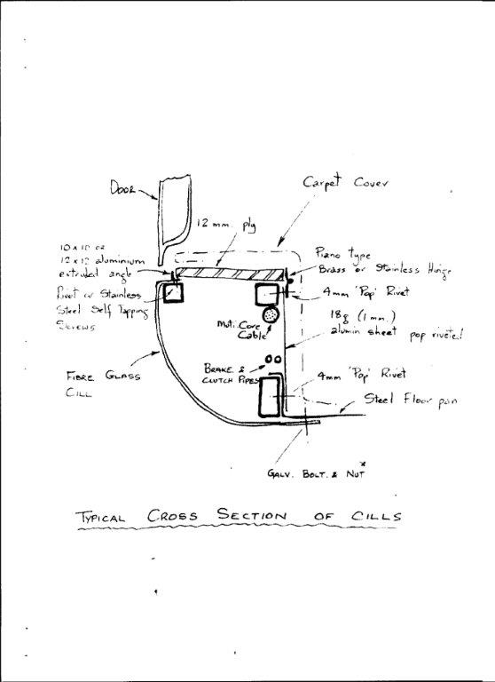

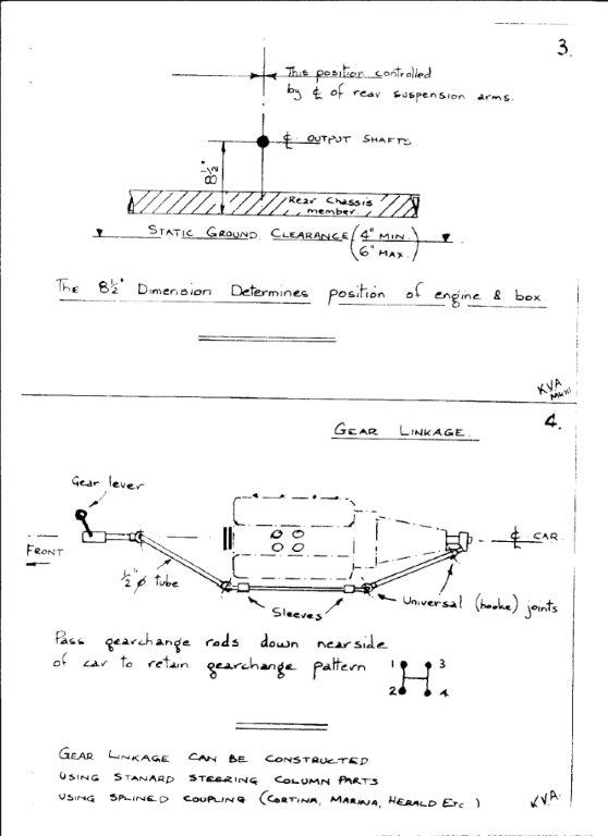

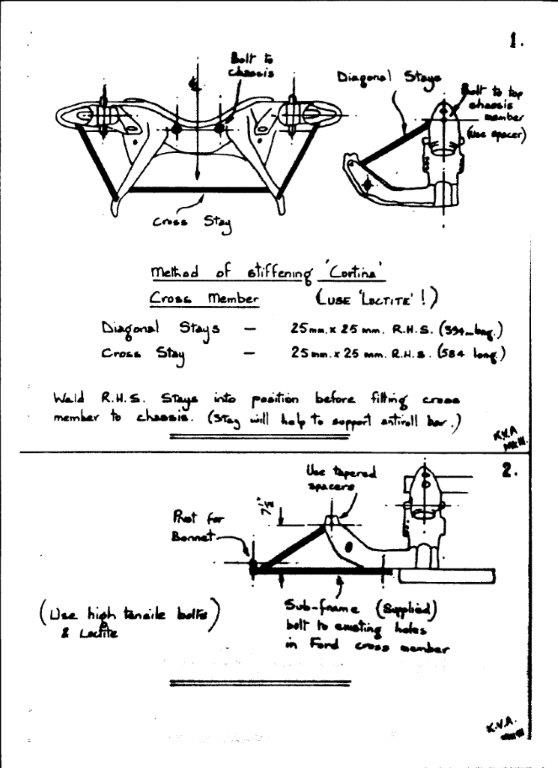

The first page reads:
Dear Customer,
These sheets are to help you to start collecting the parts.......
I have scanned it, but am having problems attaching to my reply.
I'll keep trying.

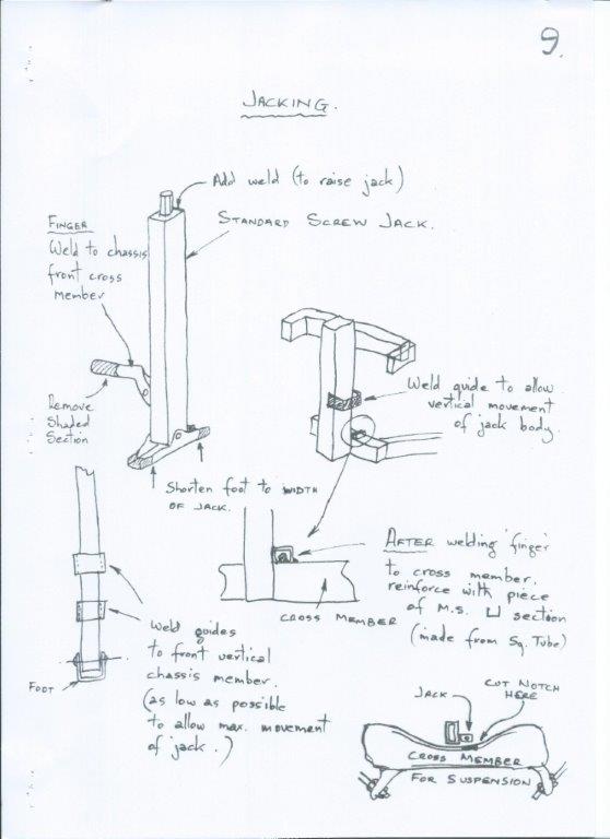

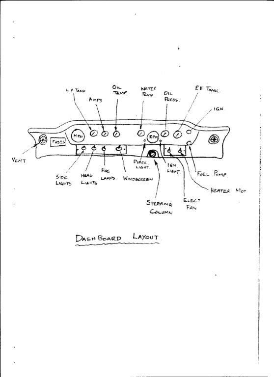

Right - Hopefully heres everything.
Good luck!
