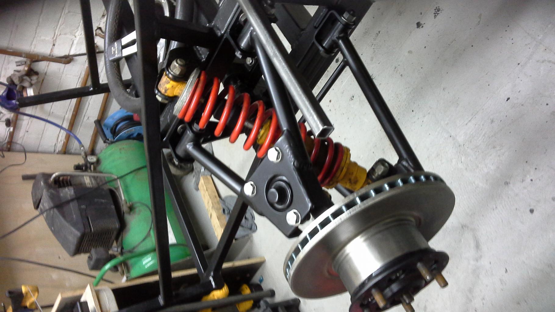

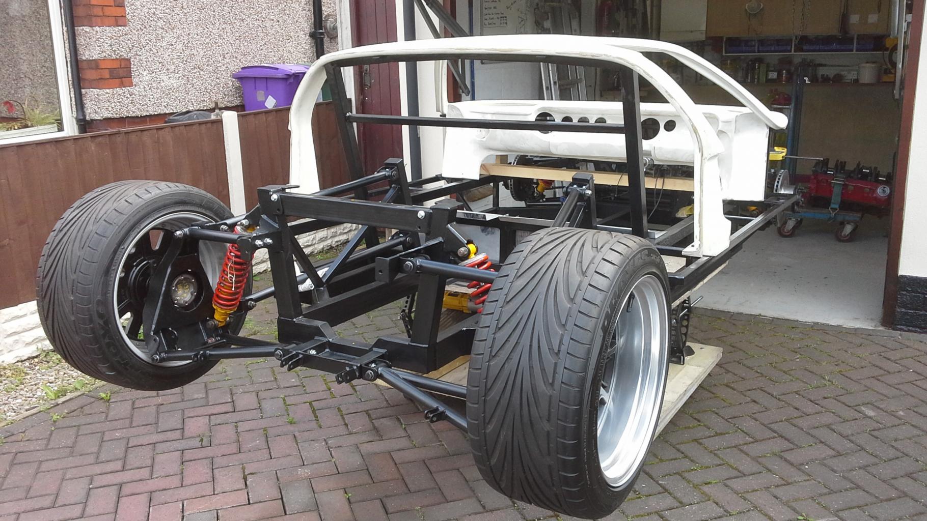

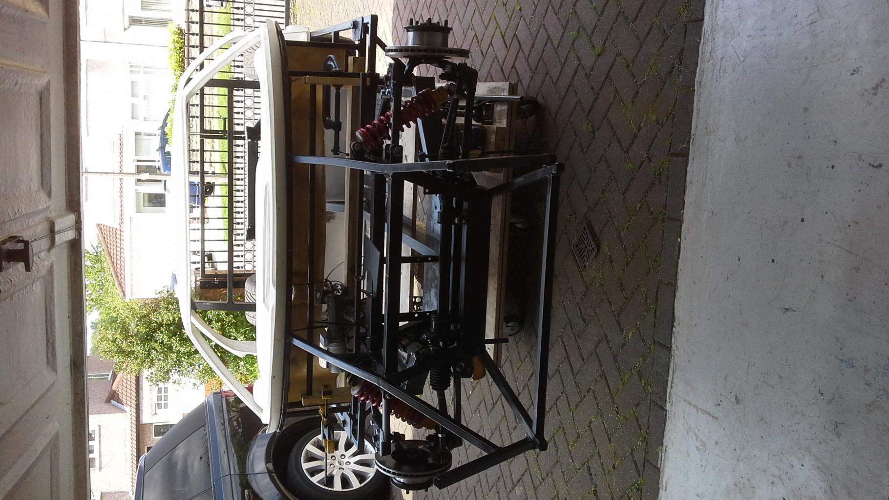

Hi John sorry its ages since my post. I will attempt to attach some pics. I would welcome your comments regarding my assumptions on the chassis type etc. Regards Patrick

Having looked at your pics there are some significant differences between what you have and a KVA C type chassis. The rear uprights are not like a KVA and look more like GTD. The chassis front is completely different to a KVA. The KVA chassis is tapered in at the front and therefore the front wishbones have a short and a long side. I don't know if your car was always like this or if it has been radically modified. It may be that it is a car that was intermediate car built by GTD between the KVAs built by GTD and the first GTDs. To me your chassis is far more like GTD than a KVA C type. A bit more investigation may help. Is there a chassis number anywhere?

The way the rear suspension pick up points are just kind of hung out there. Behind the rear bulkhead looks pretty weak. Looks like they made the chassis too short & just had to tack them on behind. Just my 2 cents worth but I'd sure be looking at that.
Hi the photos are of the early KVA with GTD subframes welded on which was how GTD first started making GT40s. They did a bolt on front subframe as an alternative if you preferred. My car is built using GTD suspension mounted on my own subframes on the same early KVA. Hope this helps, Kev Farrington
