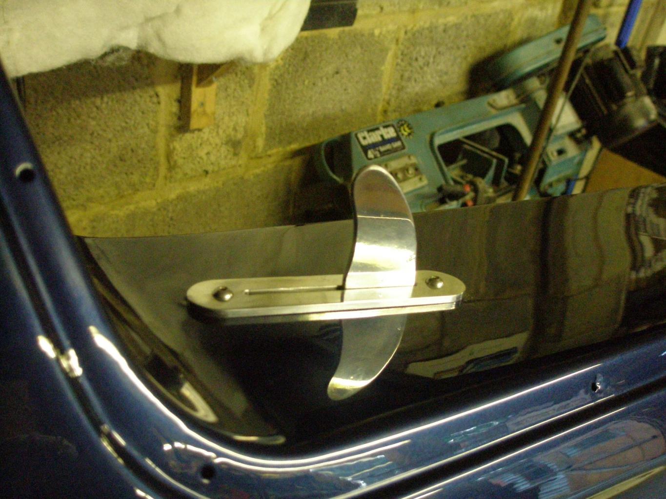

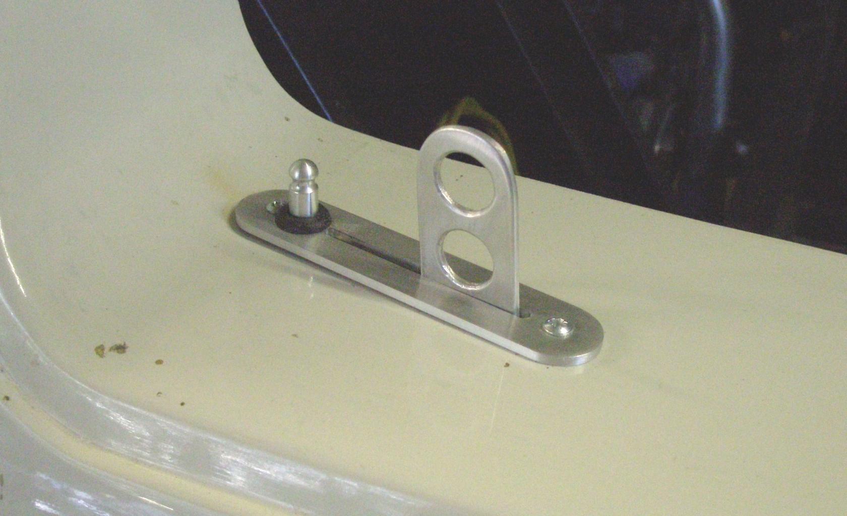

Hi Ant,
I originally planned to have an internal lock on the catch. I was happy with how it looked, but in the end changed it to a central locking system, so new cover plates had to be made.
I still have the external locks fitted, as a back-up.<?xml:namespace prefix = o ns = "urn:schemas-microsoft-com<img src=" /><o:p></o:p>

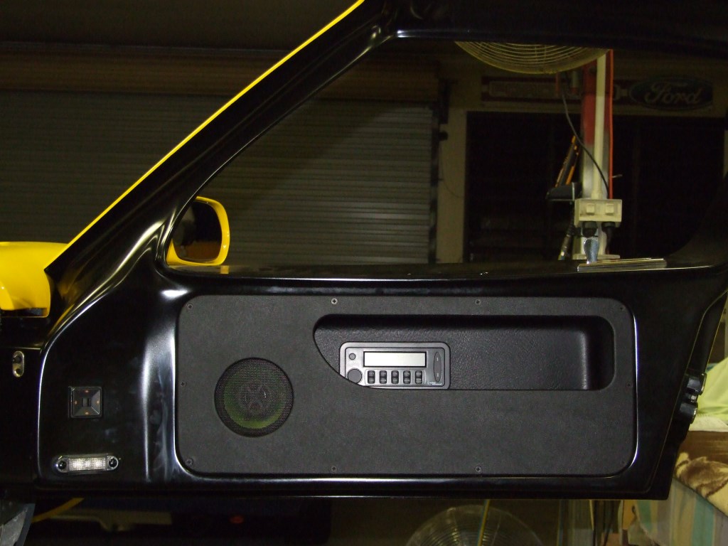

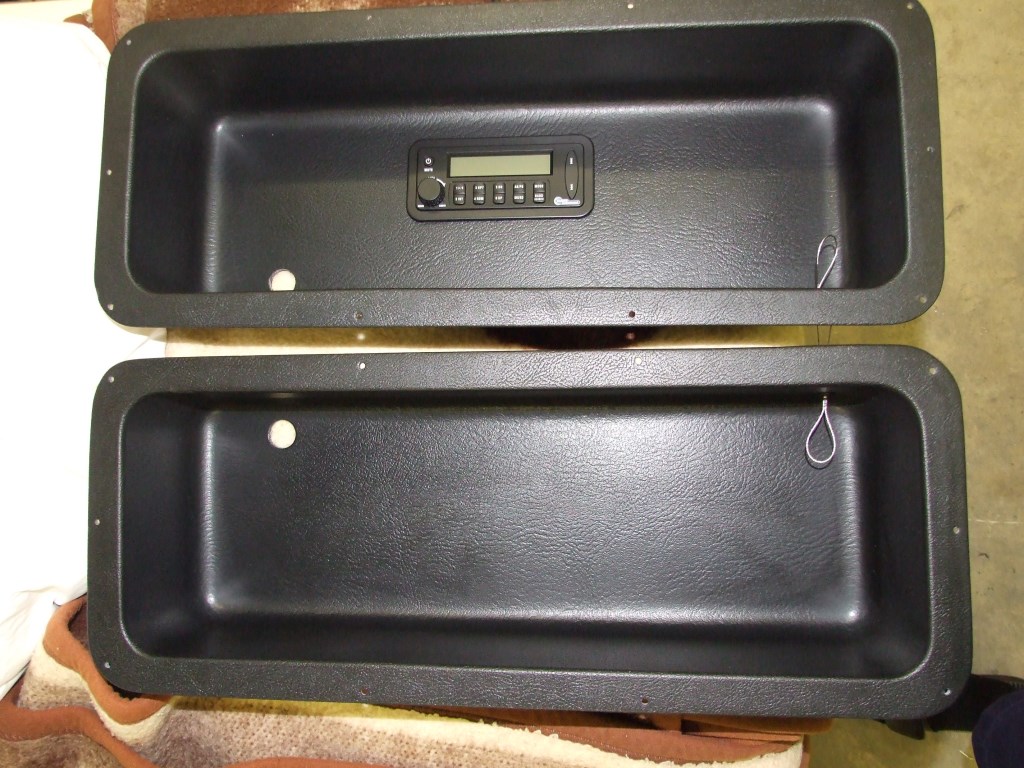

I also used remote centre locking for the clean look. But as a safety, I’ve got a pull cable in the door pockets to unlock the door if the system goes haywire. Fitted an external key lock for the same reason, haven’t had to use them yet.

@Andy, now i thought about that, i could machine 'knobs' too to make them look nice. Difficult to reach and operate but functional. exactly how often will i want to lock myself in the car?
@Clayton, i like that, a basic emergency unlock, keeping it simple. Have to ask, whats the LCD panel?
It's the remote control head for the hidden stereo, yeah yeah I know, but sometimes you need music on long drives....
The Australian ADR's require an immobilizer, so its not much more effort to fit centre locking. Otherwise I would have just used the external lock and the emergency pull cables inside.
