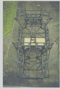

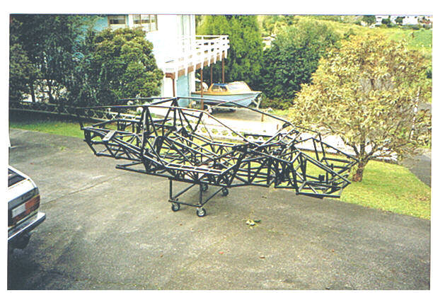

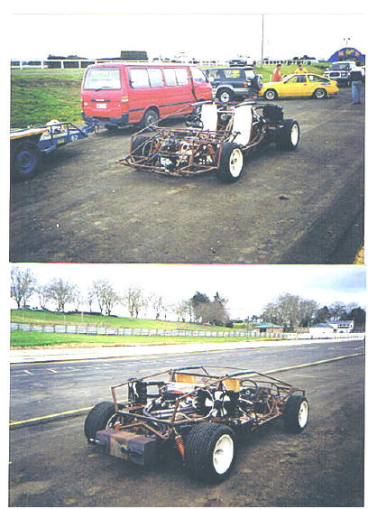

Well, perhaps not a GT40, but in the same breath I guess. I made the chassis for my Lamborghini Countach replica from scratch. Why? Well, I started looking at the so-called 'kits' in 1987. A trip to the UK and USA to view what was on offer just resulted in seeing some of the worst glassfibre and steel engineering I had ever seen.
So I bought a body shell from someone who couldnt build the thing, then set out to make the chassis.
I copied it off photos of the real chassis. Why? Because it is a proven design and it fits the body shape. I added just a few things here and there for mountings etc but that was about all.
I cast the rear bearing carriers, made my own suspension arms etc and it all works fine. I also made scaled wire models of the chassis and twisted and bent it and added and subtracted peices till I had what I wanted.
As for the suspension geometry, I talked to everyone in the know, read as many books as I could get my hands on then made my own decisions as to what I should do. After a few days driving just the bare chassis on a racetrack, and doing a few changes, it all worked out well.
This was all in 1989-1991. So the only thing that has changed since, is the availability of nice cast carriers and different brake technology, that has been adapted.
I could have bought one of the chassis already on offer from the kit manufacturers, but after seeing the very poor offerings of bad welding, bad design, excessive weight etc - I done my own thing.
Ive attached a few pikkies of my handywork.
