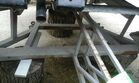

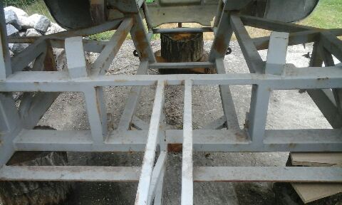

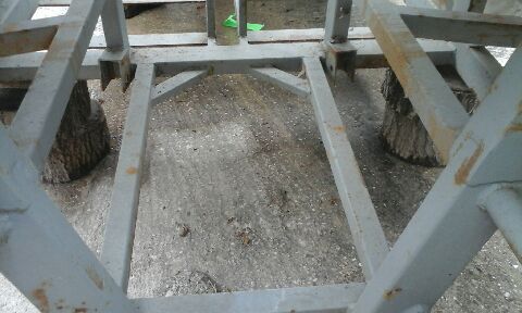

My thoughts were more along the distribution of that force through a small triangular gusset (or thin plate as you've noted) connecting the two longitudinal tubes, with the heavier lateral cross bar. I've always attempted to place the point of force at the joint itself, and if displaced off the joint (as done with the two longitudinal tubes), then reinforce that area to re-distribute the loading. Photos don't show it all, so you may be fine with what you've got. Perhaps I overbuild too much.
Got it. I wasn't sure what gusset meant but now I understand and that's what I'll do. Here's a photo of the both shocks in position. I'll have v to grind everything off though cause I'm not completely happy with the weld quality. I'm using some shitty 170 mig machine now and I'm getting my Fronius back soon so I'll redo the whole thing then and do the reinforcing plates as well.
Marko

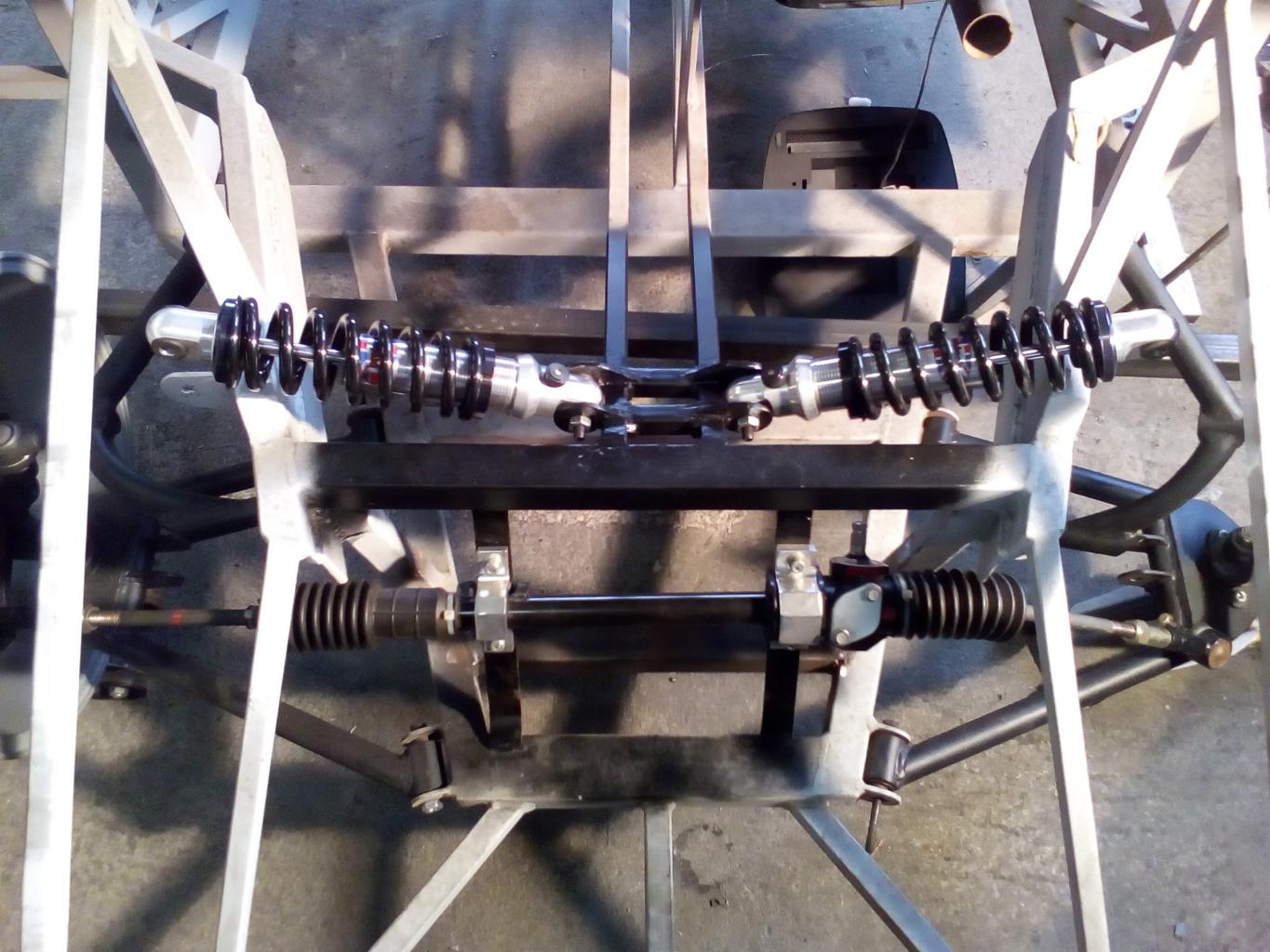

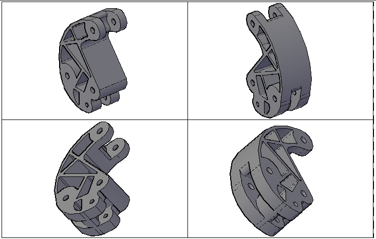

I was working some more on the rocker. I added one more bracket on it for the anti roll bar. Each rocker weights about 280g if the math is right.
I was thinking about the shock mounts and other modifications I've done and will do and how it all effects its integrity and decided to make a CAD model of the chassis. Today I managed to finish the front end. It's not completely right (some angles are a nightmare) but it's more or less within one centimeter. When I finish the whole thing I'll use it to do a stress analysis on the complete chassis.
Marko

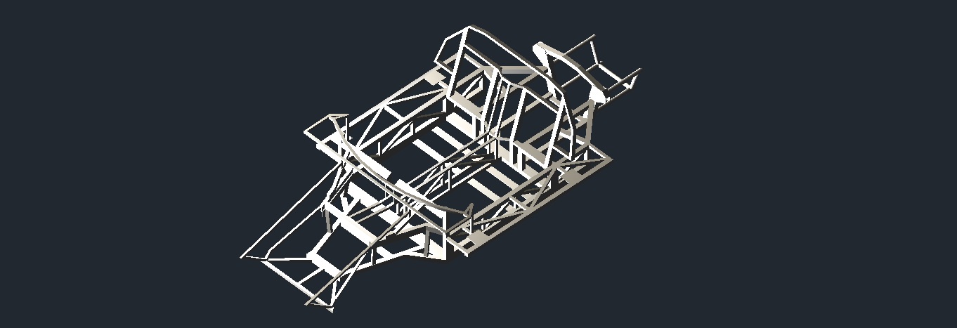

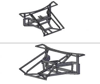

Hi guys
Finished with the modelling of the chassis. Well I have to make a few changes to the front end and confirm the height of the bulkhead but other than that it's done. Now I have to add the mounting points and apply all the forces and materials in the FEA software and hopefully then I'll have a baseline for all the future (and past) modifications. I'm thinking about modelling the suspension as well. I was planning to replace the Granada wishbones anyway so I might just model em first before fabricating.
If someone needs the model feel free to ask. I'm all about sharing :)
Cheers,
Marko

Mike Pass
Hi Marko,
Maybe add some angled struts from the end of the engine bay to support the rear bulkhead frame in event of a roll over. After all it's your head it is protecting!
Yup they're definitely going on there. First time I've seen the struts on other people's cars I decided to put them on. Thanks for taking care of my scalp :)
Marko
