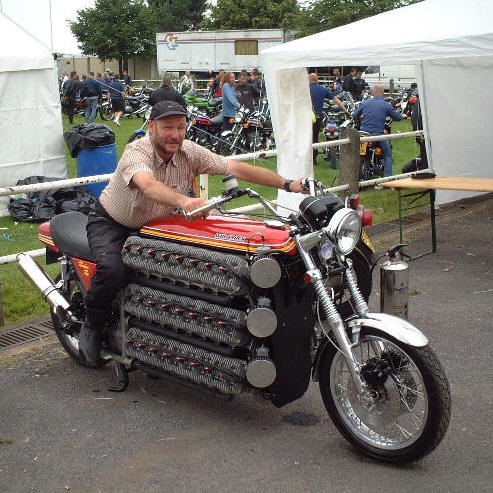

Oh yeah? Well u just wait until I finishing building my Mk V. It's got an 8-speed Lexus transmission with carbon fiber shift knob. I haven't installed the engine yet cuz I need the bike to get to school:

Alan only if it were that easy (more hp = faster), and lol at that bike.

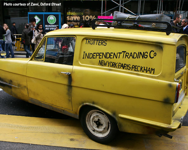

George,
Forget your exotic european machinery, too overblown.
What you need as a build base is something more understated.
Couldn't you fulfill your dreams using this as a base starting point ?
Imagine a 427 in this ??

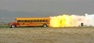

Oh no, the guy that built this bus is getting me my chiznit valve and it's like 6 feet tall. I know all about buses because I ride one every day. They're the best vehicles because they have the most seats. But the one I ride is shorter.

Alan - can you picture that rocket on the back of a GT40? Im sure nobody would beat that. Maybe I should stick a rocket in my build rather than a tank of Nitro with rocket fuel. Press the button on inside (like the Aventador start button) and An afterburner kicks in, can even call it the "emergency need to win" button, yep sounds plausible.
