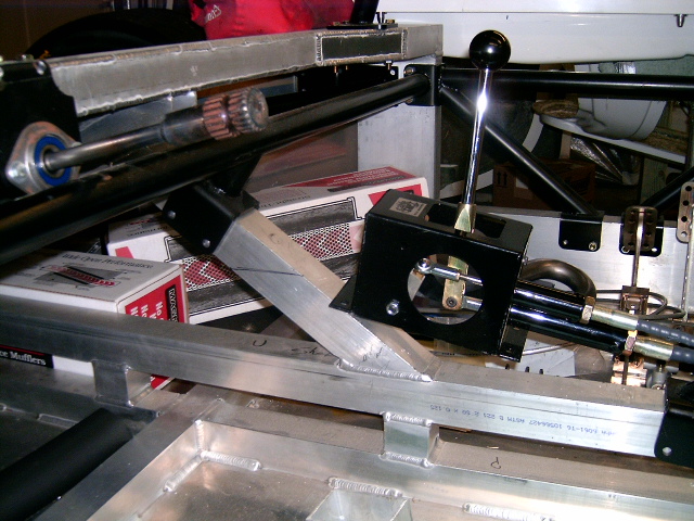

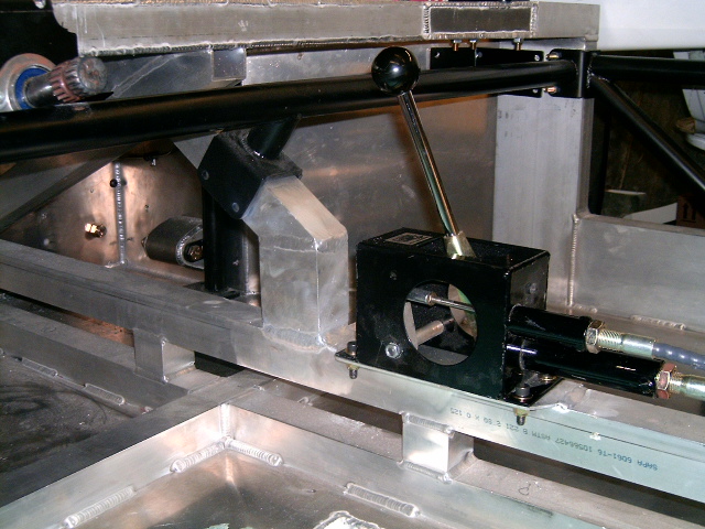

Howard Jones
Here's what I did along with shorting the shift lever shaft..............You can't just take it out..........

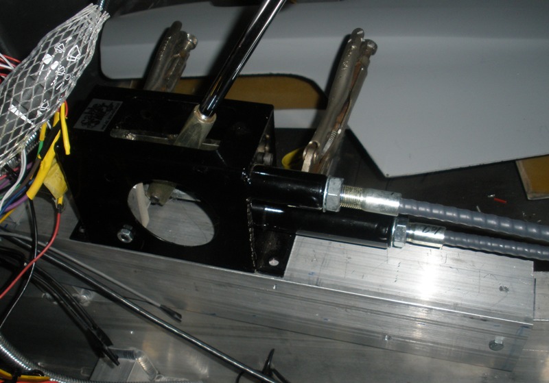

I just bolted on 3" angle at an angle and called it a day. I agree with Alex, the shifter is much better angled back at you, than flat,. Then chop the gear shift lever about in half, die it 1/2-13 or whatever your geashift knob needs. Then grind a slot so you can tighten it with a flathead screwdriver.
