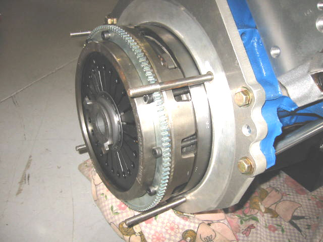

need picture of assembled flywheel/pressure plate/ring gear for G50 transaxle
I think that i received the wrong pressure plate in the package I ordered as nothing seems to bolt up correctly - so if anyone has a picture of one bolted to the engine prior to transaxle assembly it would greatly help me to identify the mis-matched part(s)

Not sure what your problem is. I have to assume the flywheel bolts to the crank flange no issue. The ring gear fit the flywheel as it should. The Pressure Plate mount holes do not line up.

Bill, no I did not get it all from kennedy - the flywheel came direct from DRB. Ring gear from porsche dealership (wow was that expensive!), pressure plate (turbo model) came from a vendor (Sachs - sp?).
at this point I'm not sure if i'm even assembling this $#@! thing correctly at all - -
flywheel correct for 289/302 ford - it bolts to crank and has been balanced by my machine shop.
Problem is that the ring gear appears to "float" on the flywheel. there is a small lip on the flywheel that holds the ring gear but there is ~ 40 thou of radial motion = way too much to balance.
then the pressure plate mounts to that - - i assume, but this looks wrong as I dont think the starter can mate to it. if I assume the ring gear goes on the back of the pressure plate (never seen one like that - but don't knwo crap about porsches) nothing seems to self "locate" and everything moves.
at this point i don't know if i got the wrong ring gear/pressure plate or I'm being just plain dumb and can see the forrest for the trees.
anyway - a picture would be worth while for me now.

Maybe this helps?
Here is a picture of the clutch/ flywheel assembled. Does it help?

LEE - YOU ARE A GODSEND!!
thanks for the picture - it appears that my pressure plate is, indeed, wrong as it does not set down into the little raised lip on the flywheel - it slides around on top! So, that's my problem - - - -
Thanks a million!!
now - to find out just what pressure plate they sent me!!!
