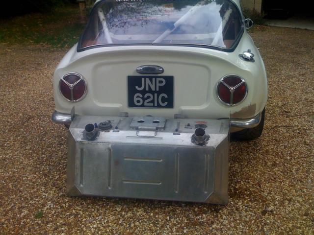

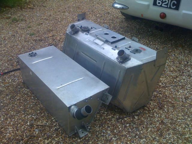

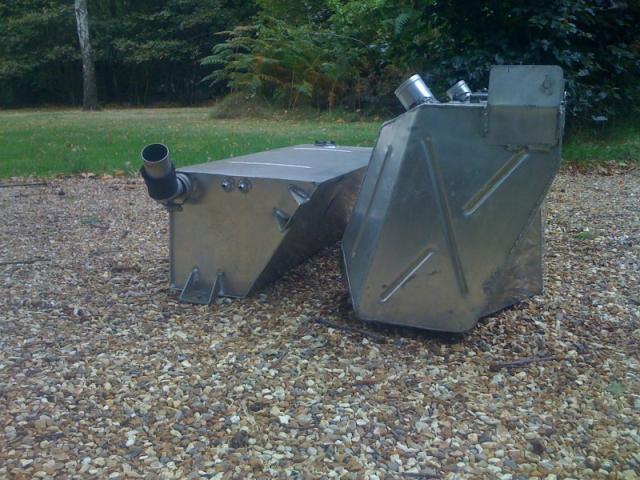

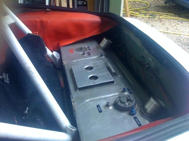

Currently I'm awaiting delivery of a replacment Rad and busy sticking in a bigger tank, i.e. 100L instead of the 47L as standard, which should enable us to run with just one stop and fits in well with the intended driver change midway so busy busy busy.

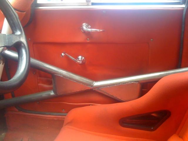

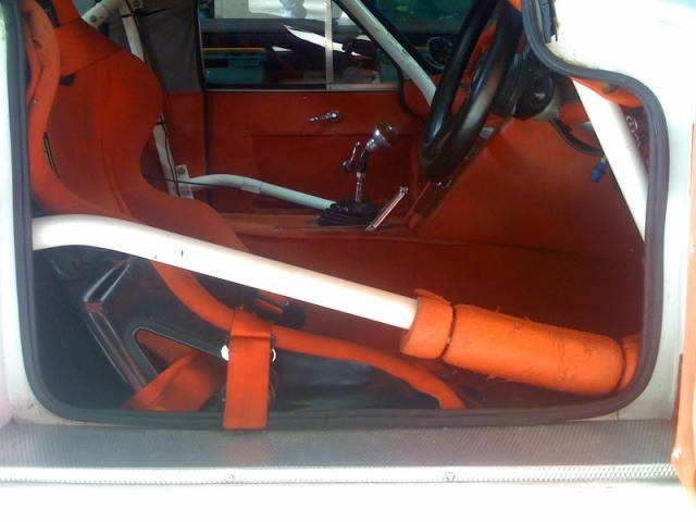

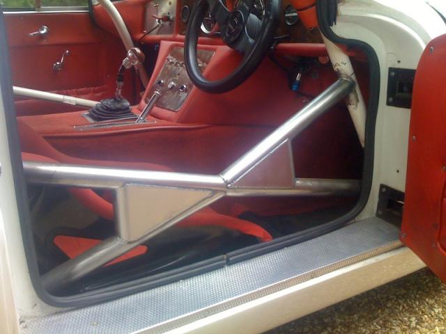

Also had to replace the single drivers intrusion bar with a double one complete with gussets to comply with the German entry regs. (Wish I had Tig gear!)

Good luck with the running! I like that larger cell, good stuff. Tig gear is for wusses, you did just fine, looks strong and safe.
