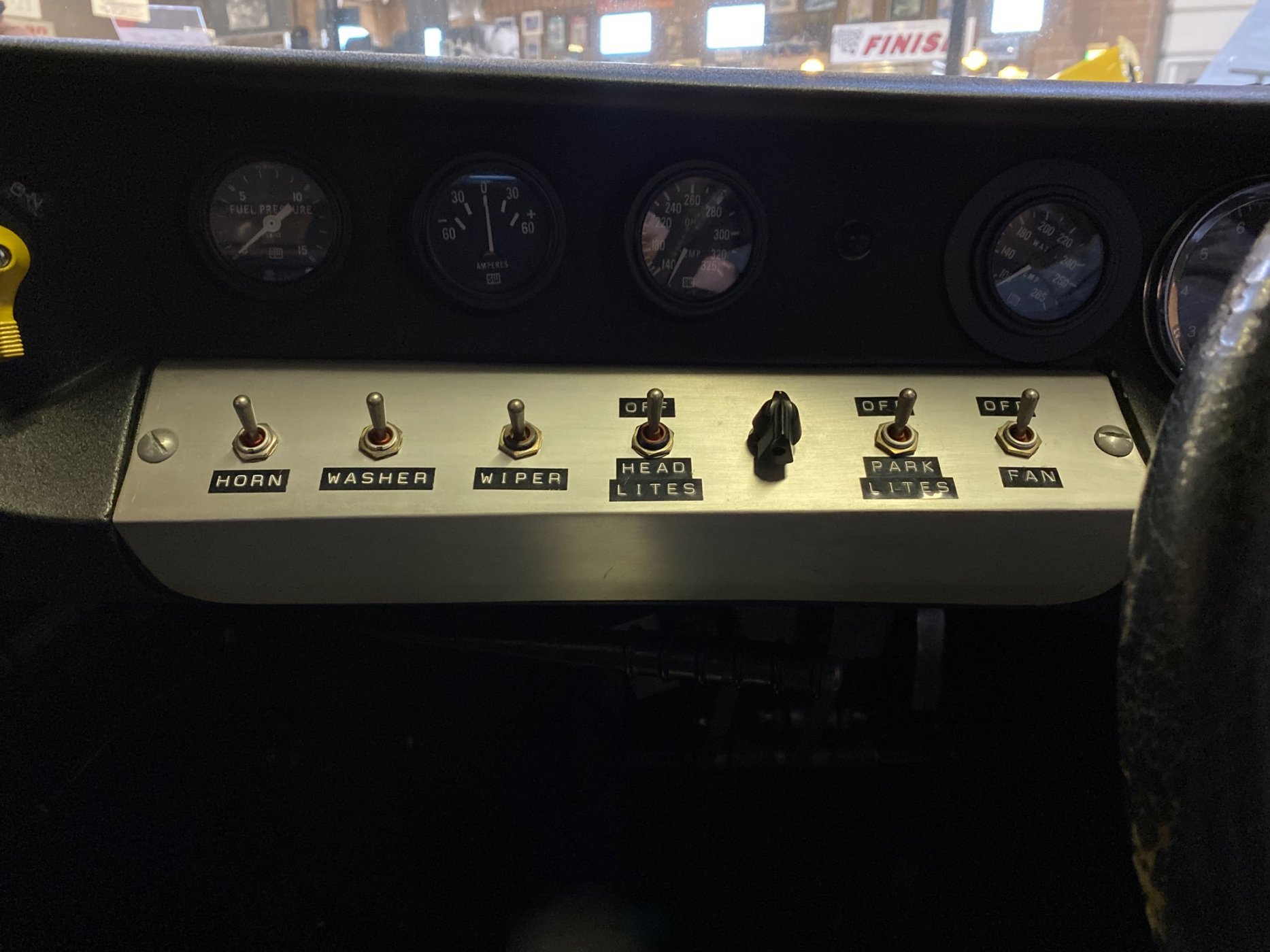

Hi All,
This attached picture of the original dash in the P1015 has a switch between the toggle switches. Does anyone know what this switch does?
Thank you!
Louis
RCR GT40 MKII
no idea
possibilities
Roundel lights?
indicator?
dash lighting
interior light?
switched fuel senders between tanks so the driver could check what was left in each tank?
Toggle switches are aircraft spec ones and not Lucas 57SA type though.
no idea
possibilities
Roundel lights?
indicator?
dash lighting
interior light?

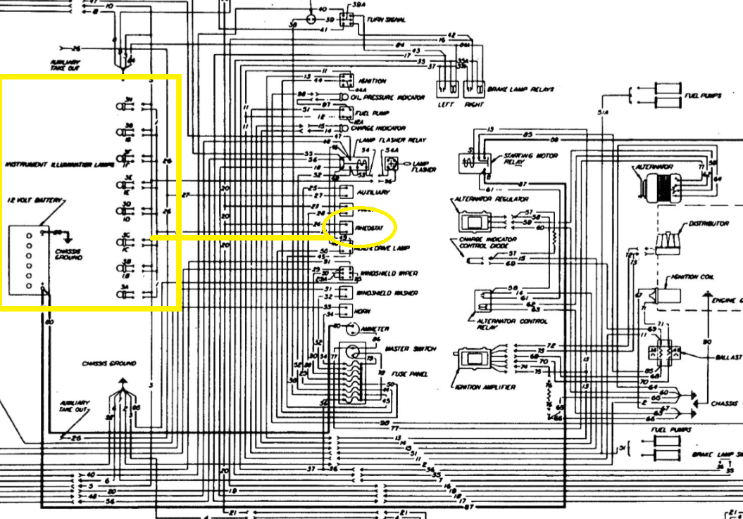

Reostat......used in aircraft etc to dim/brighten the dash lights. Primarily if panel is back lit.
