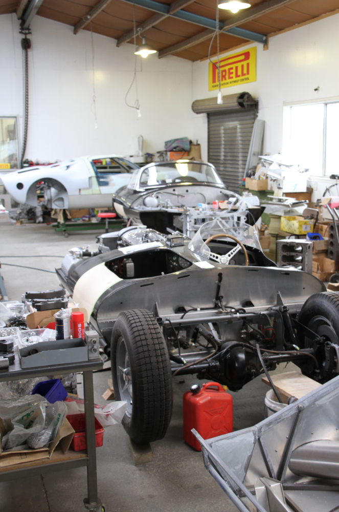

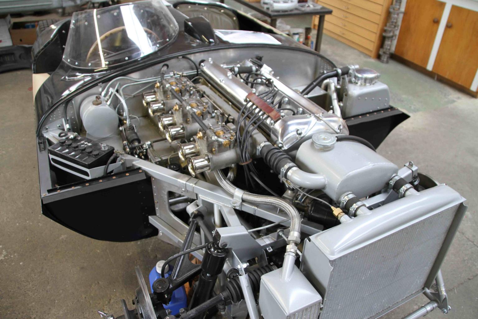

It's a D-Type destined for the UK Jim and almost complete. Dave has had it running. He's also working on an XKSS. It's an interesting workshop at the moment with the three 40s and the two Jags. Sorry for the thread drift Andrew.

"Welcome" to George and "Hi" to Jim & Brian. Please don't worry about hijacking this thread, it's had worse before!!! More photos of my car would be nice as I'm right around t'other side of the World and although David is a great gentelman and unbelievably good engineer, I don't always get too much information about progress, as I would hope for. The better the work is described to me by you guys, the better, as most of you will be aware I am totally blind and use a talking computer, plus my very patient, but non-expert wife Debbie, to describe the progress. I therefore "look" forward to updates please. I do need a pair of 15"x10" magnesium BRMs for the rear as my 12" rims are too wide for the old standard wheel arches. Regards to all.. Andrew

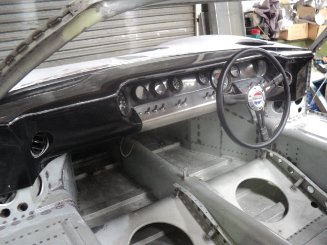

P/1042(1001)

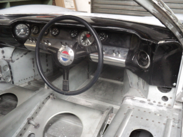

David & team have been busy since Christmas. Original-style and period-original dials believed from GT40P/1045 and steering wheel from GT40P/1027 pictured here. Note the single fuel gauge as GT40P/1001 was a "cross over" car, meaning it had two tanks interconnected, but only one right hand fuel cap. This was the result of competing in the 1966 Le Mans, where refueling was only allowed from the right. Makes sense as the other side was an open pit lane in those days, with no retaining wall. Refueling from the pits side, meant the mechanics were safely behind the car and not in the passing traffic.
Hi Andrew
Le Mans always had the pits and refueling on the right. Luckily being a right hand drive UK car the GT40 this meant the drivers change and refueling was accommodated easily. Indeed by 1967 both the MKIIB and the MKIV had done away with the need for cuts in the roof for the passenger:- as no passenger was carried and none would of taken part in the Le Mans start.
By 1966 all MKII had their passenger side fuel filler caps blanked off. The 1967 MKIVs had their filler caps under a cover so I do not know if they used a crossover system. The MKIIB followed the previous years MKII's and had only drivers side fuel fillers But I do not think they had blanked off fillers. They were new designs and had only the drivers side built in. The same applied to the 1968/69 Gulf cars although their filler cap was magnisum and painted Black.
Does the cross over switch have anything to do with the switch on the bulkhead I think on the drivers side that was (?) taken from a Camberra bomber?
Good luck
Regards Allan
Charlie Farley
The Gulf car magnesium fuel filler caps were not painted black.
Thats the natural colour magnesium oxide adopts.
I have a few sets.
The fuel switch over valve was a Vickers product, fitted to both many military
and civilian aircraft of the period, but rarely of the bore and output configuration, to work in a 40.

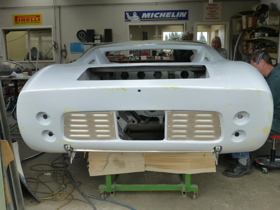

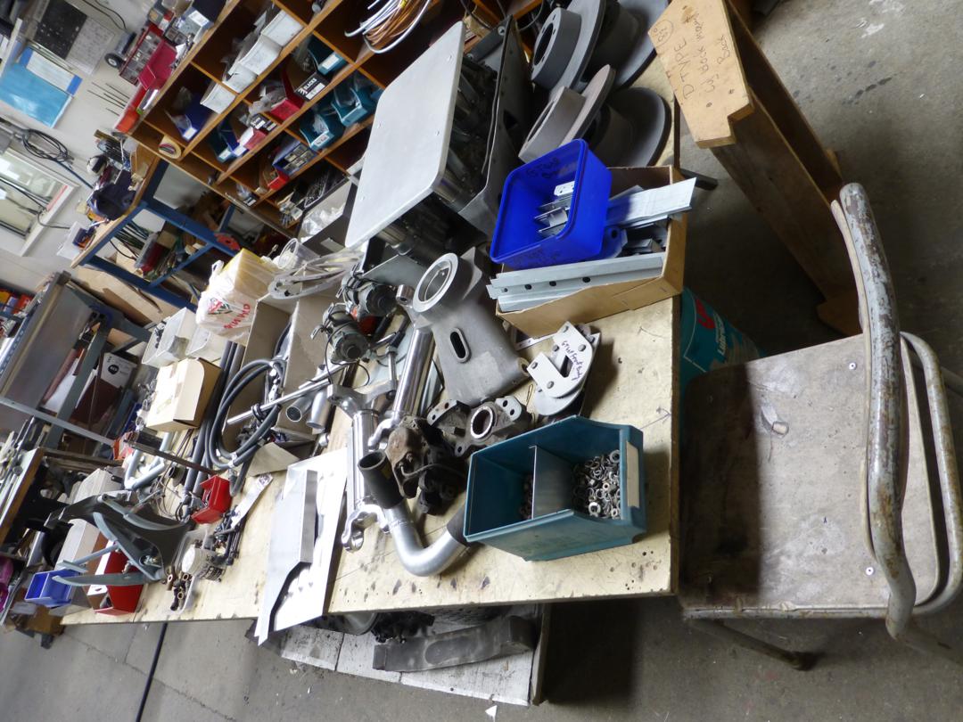

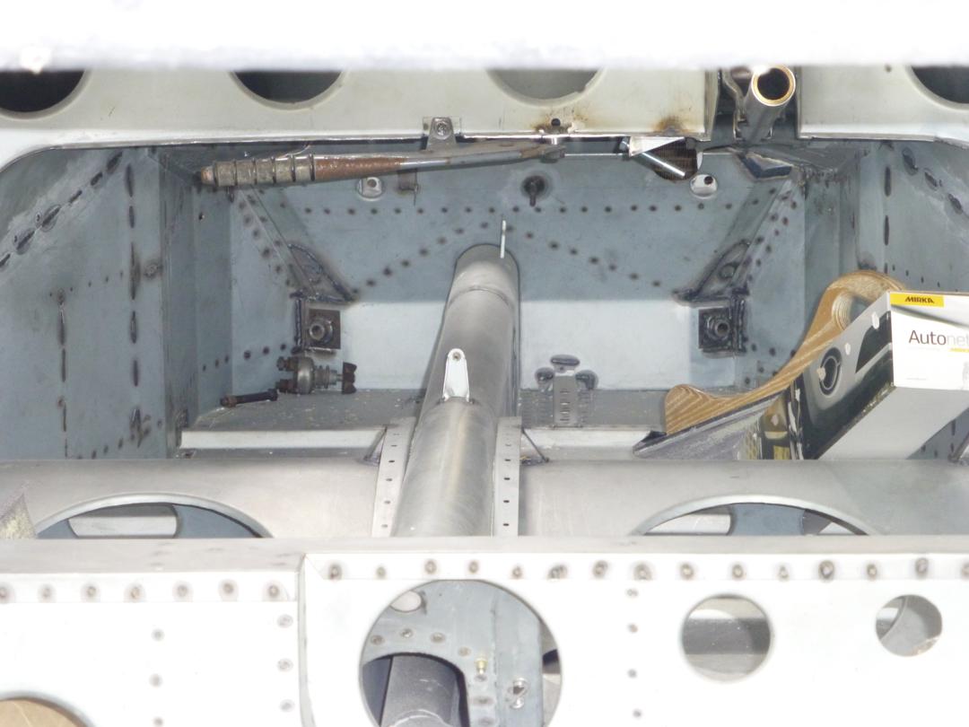

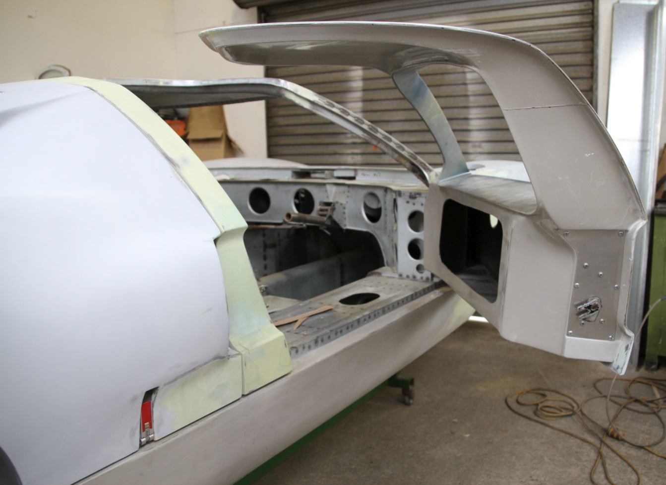

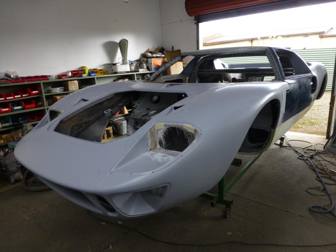

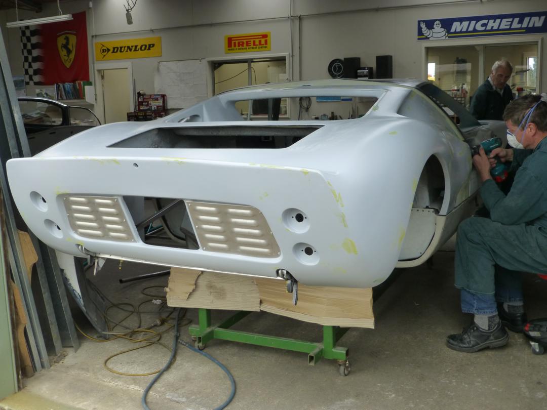

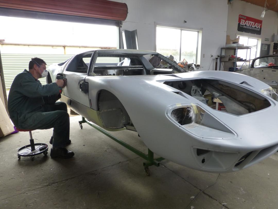

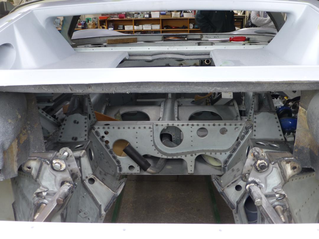

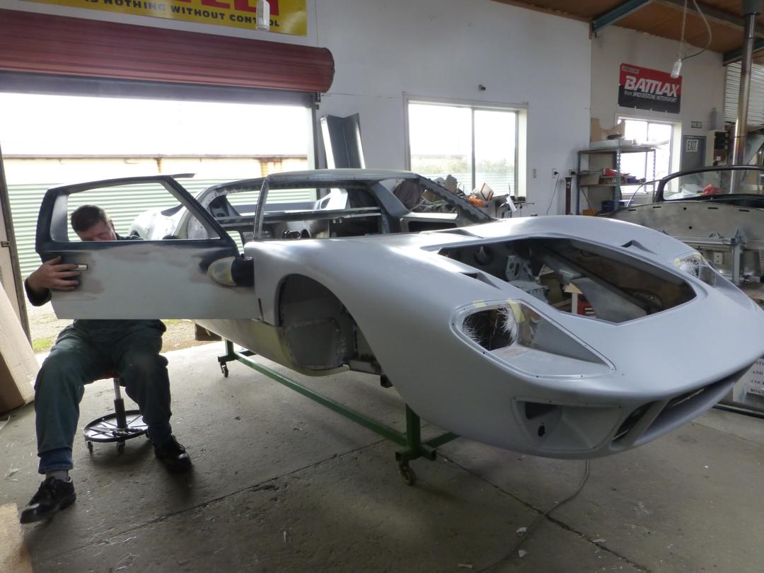

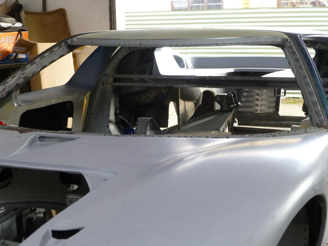

"Hello Gents". My friend, a fellow Club Lotus member, Tim Arnold, visited New Zealand recently and dropped into David's workshop and took these candid shots. This is over six weeks ago so, naturally, the car is less progressed than now... Andrew
