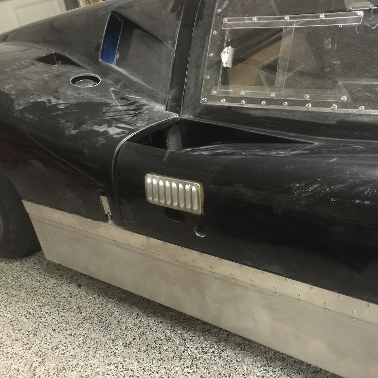

Progress on the car continues with more body related issues. One is I finally got the door louvers installed which I don't think I shared. The size and number of louvers agree with the original HM car.

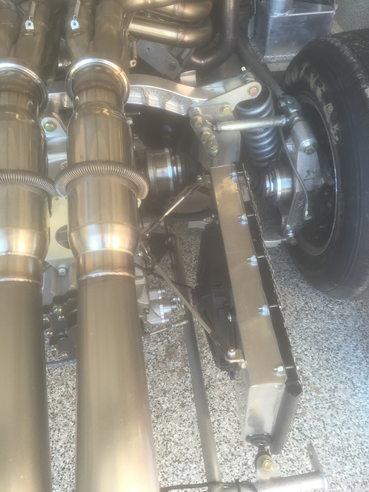

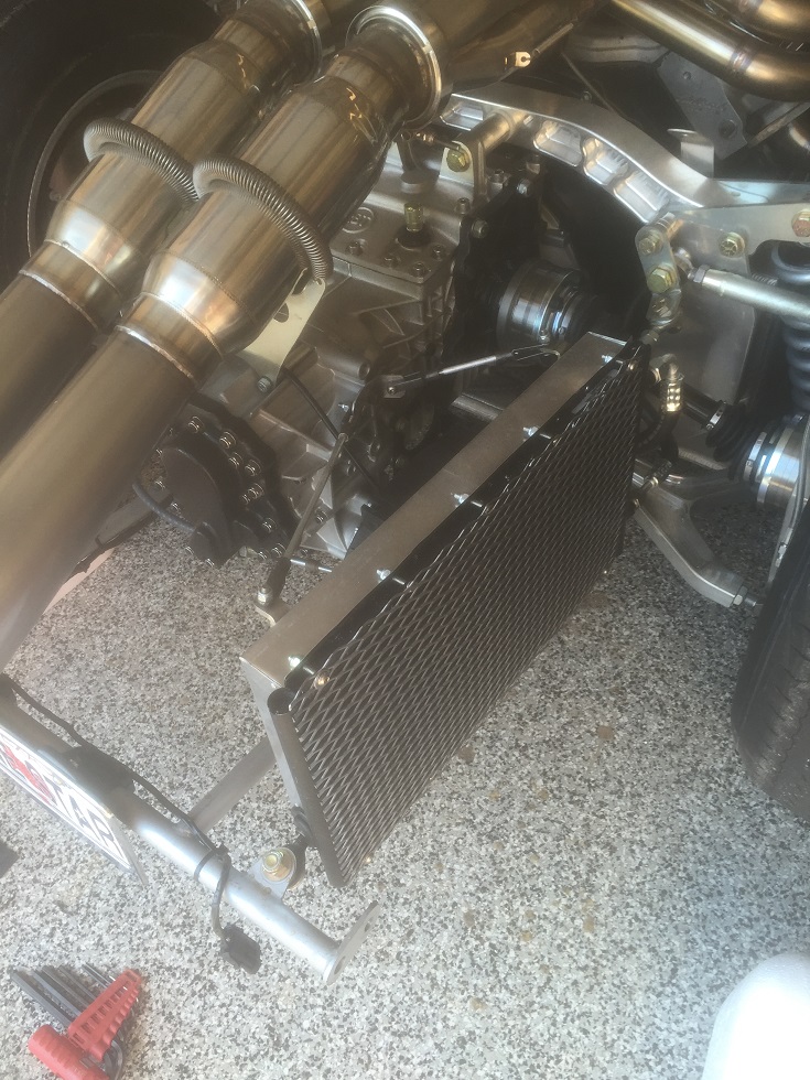

The car has AC and I took an idea from a Pantera that had the condenser mounted at the rear of the car. In my case it worked out and fit where the FIA trunk would have been. It's working well although the weather has now turned cooler.

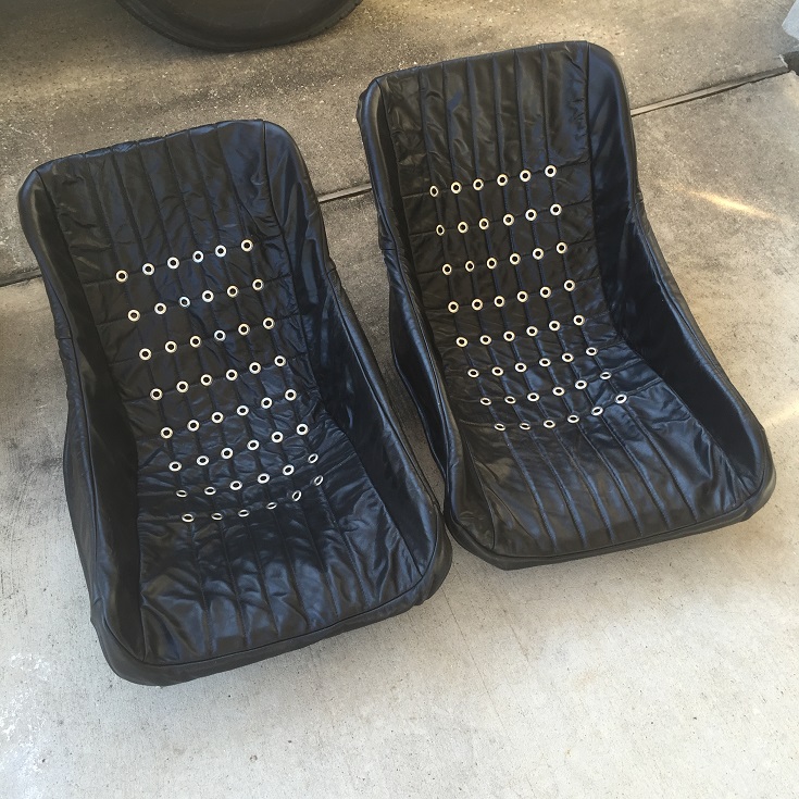

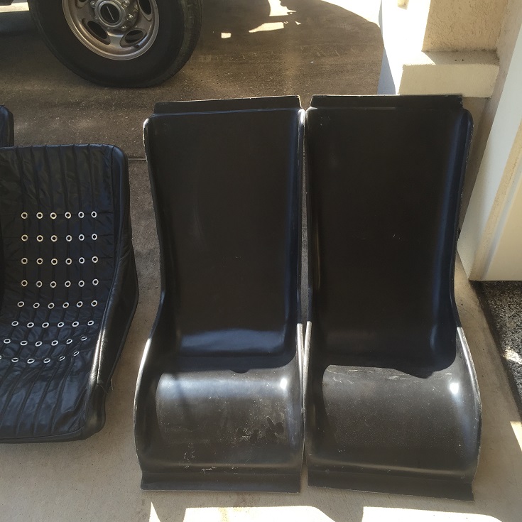

Seats, I have seen so many people on this forum try different seats not only for the GT40 and SLC's. The seats that came with my car are very nice and have the nickle rings but I was looking for a higher backed seat like the original. Bill Hough makes a fiberglass shell GT40 seat that fits very well. You basically have to seat on the floor so your head will fit without a bubble being added and of course laid back.

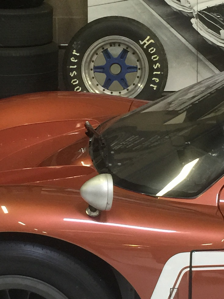

I have mounted my mirrors and I have tried to follow the pictures of the HM car before the crash, the first picture. I can tell you that when setting in the car you can not see the right hand mirror unless you move your heat towards the steering wheel. So I may want to make the car look like the original I also want to be able to see the mirror so it is now mounted where many of the replicas have mounted it and where the mirror now lives on the car in Boulder CO.
Just the way it is.

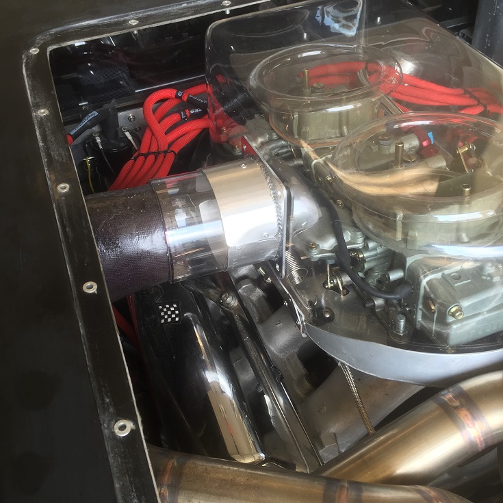

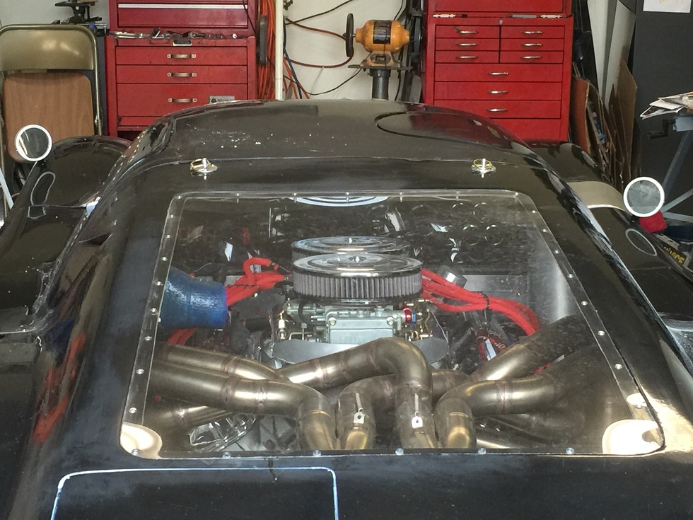

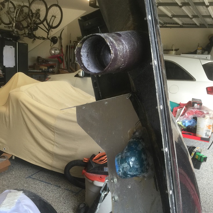

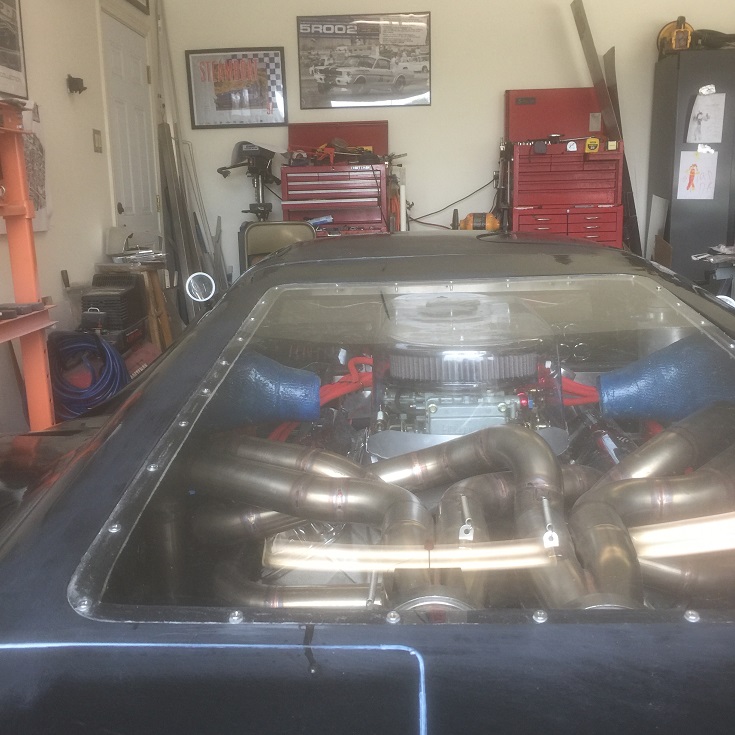

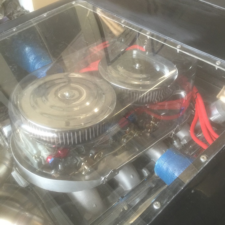

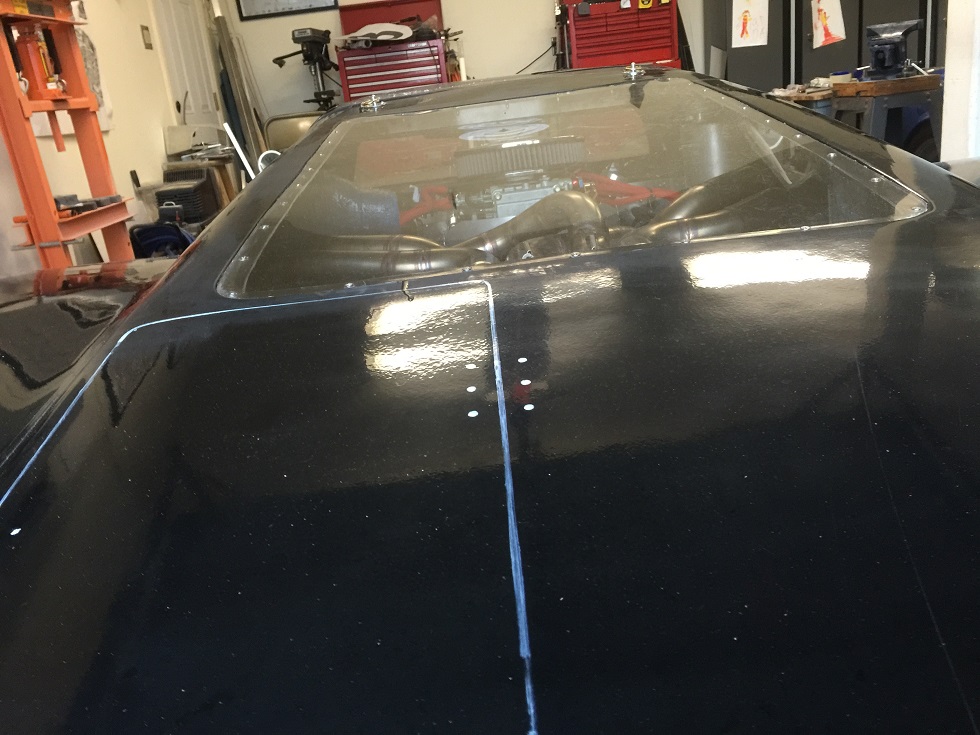

Case and point was the air box. I have always planned on installing a clear plexi air box over the carbs just as the HM cars had in 1967. After having the car in one piece and motor and rear clam shell installed I found the air box was about 1" to high to not touch the rear window. So the last month I have reworked some things to make it all fit. Remember space is a minimum on these cars so if you move something you will need to move something else that effects something else and so on. That's why it take so long.
After that was fixed my air ducting I made to the box was to low and must be remade which is my current project. While doing all this I decided to install the rear clam hood pins and that moved on to a small project of making the rear glass have a small arch as it should. I made a 1" angle with a curve, installed it on the underside of the lower rear glass and got my results I was looking for. The rear fiberglass body is so wide and flat in that area it wants to sage under the weight of the rear glass. That was my solution to the problem I'm sure there are other ways to do the same thing.

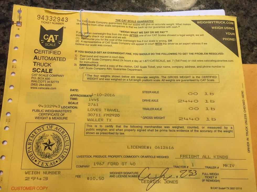

Registration and Tags; What a mess! My custom tags came in so I made a trip to the downtown Houston court house thinking they would have the most experience with titling a custom car, wrong. First trip they told me the Certificate of Origin was not filled out correctly (Fran you did it right they just don’t know what they are doing). Seconded trip they told me I must have a certified weight from a certified scale. The C of O has the weight listed but that does not matter it seems. So Saturday I’ll load the car up and get it weighed. This maybe a good thing because I’m often asked what it weighs so we will have the certified correct number for everyone to know what a RCR GT40 Mk IV weight is with Ford FE fully loaded with fuel etc.
Wish me luck next week when I try once more to make this thing legal.

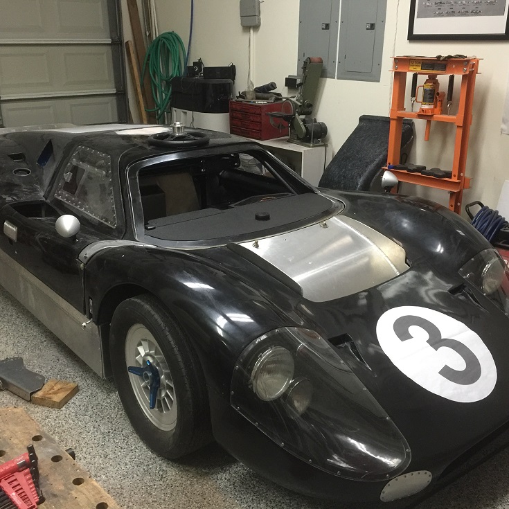

It's official the car weight is certified at 2,440 lbs with half tank of gas and everything mounted.
This is going to be a fun car! A twitch of the gas pedal should give me a chance to change lanes.
John, the air box is going on the car, it's just taking a lot of work to make it happen but worth it.
I'll report later if the court house will make this thing legally street-able.

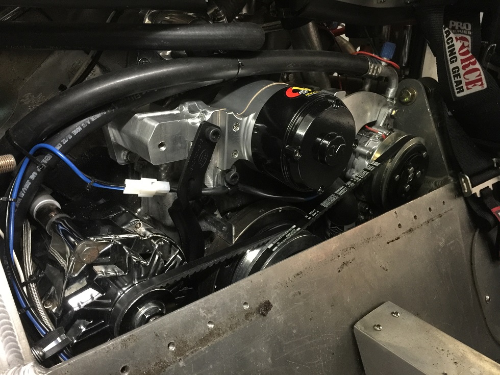

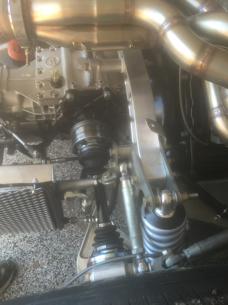

It's a slow day on the forum and I got the new water pump and belts mounted so I took a picture to share.
Just more HP for me to enjoy!

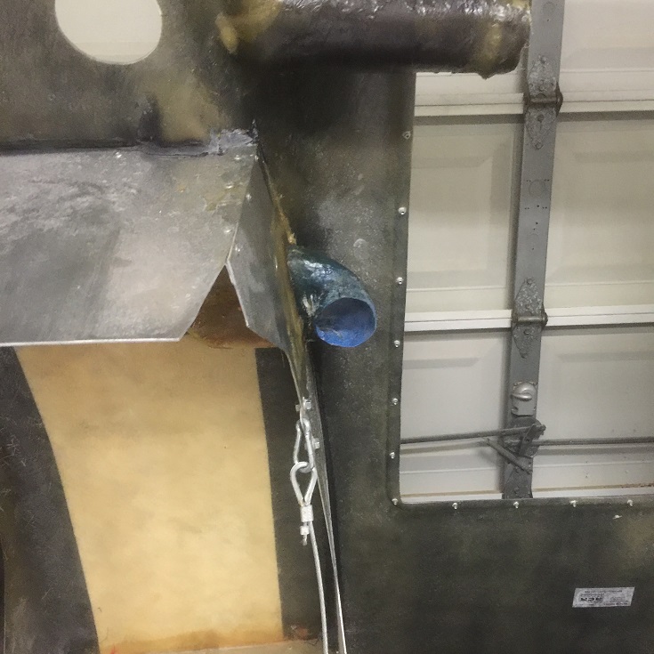

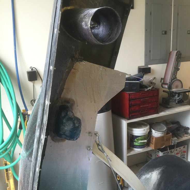

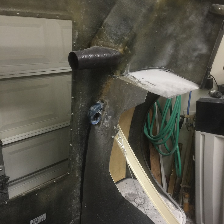

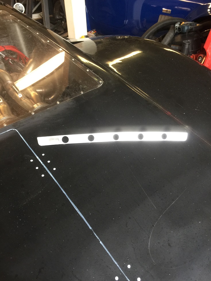

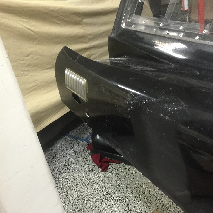

<!--[if gte mso 9]><xml> <o:OfficeDocumentSettings> <o:AllowPNG/> </o:OfficeDocumentSettings> </xml><![endif]--> I know it’s been a while. Sometimes you just have to put the tools down and walk away to solve problems. The last month I have gone to Sebring for the 12 hour race and I have got back to the Mk IV and been working on the rear air ducting. The air box intakes are re-glassed in along with the rear brake cooling ducts. I’ll wait to make the final connection to the air box once the car is back from paint. Just a few days left on the rear and I will be moving to the front and install the ductwork there.
I have found a good painter so hoping color will be soon. Let me define “soon” in car building language, “hope to have it painted this year”.
