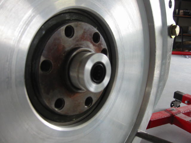

Chris - This is what my (your design) pilot bearing looks like as installed in my crankshaft. It is driven all the way home inside the relief of the crank;

Oooops! you're right Randy, your pic of the installation is correct (my pic was for the photo shoot --apparently) .
Tom, the pilot brg. should hang out the same amount as the thickness of the adapter plate (approx 12mm )
