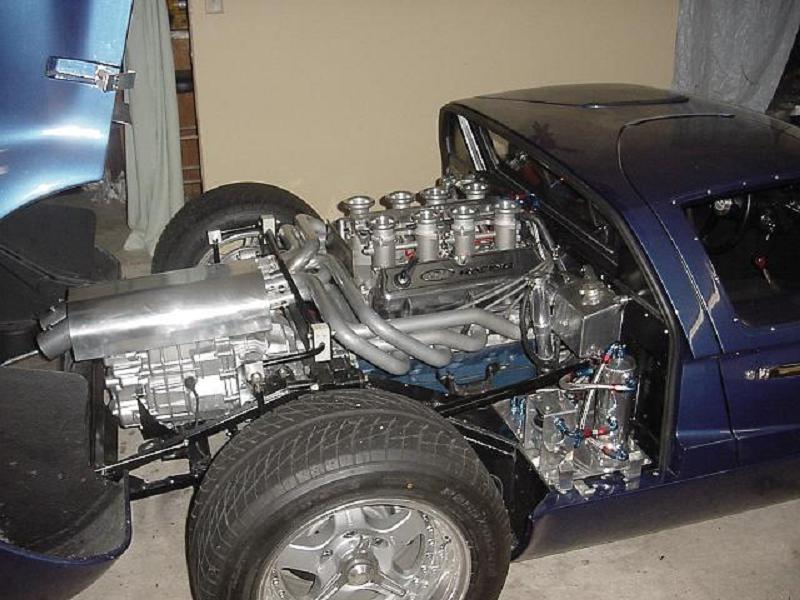

Applications with an inverted gearbox(eg. G50) and a 351W,
don't suffer the aforementioned clearance problem, and have
other benefits as well. I still have good clearance between
my oil cap/breather(1/2") and the back deck around the
induction hole. The lower CG ain't so bad either! /ubbthreads/images/graemlins/wink.gif

Bill,
Thanks, just what I needed to hear. My G50 is getting the "once over" right now so I am shopping for 351w builder with the hopes that chassis mods will be the only issues. I didn't want to upset the body fitment. I see others like yourself are getting the 351w's in so it is possible.
Thanks for the pic, looks great /ubbthreads/images/graemlins/cool.gif

Tim,
I get 11 3/4" from the block to the rear window. Don't bet the bank on that number, but it's pretty close. It's difficult to get an exact measurement around headers, heat shield, etc.

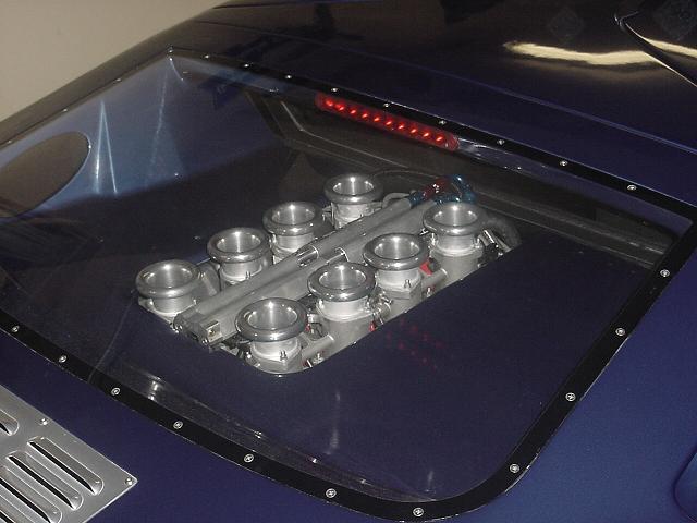

I have 4" from the window to the rear edge of
the induction hole, and then 7 1/4" to the block.

Bill,
Pleased I am /ubbthreads/images/graemlins/smile.gif Thanks alot, beautiful work. It will become my reference picture /ubbthreads/images/graemlins/grin.gif
