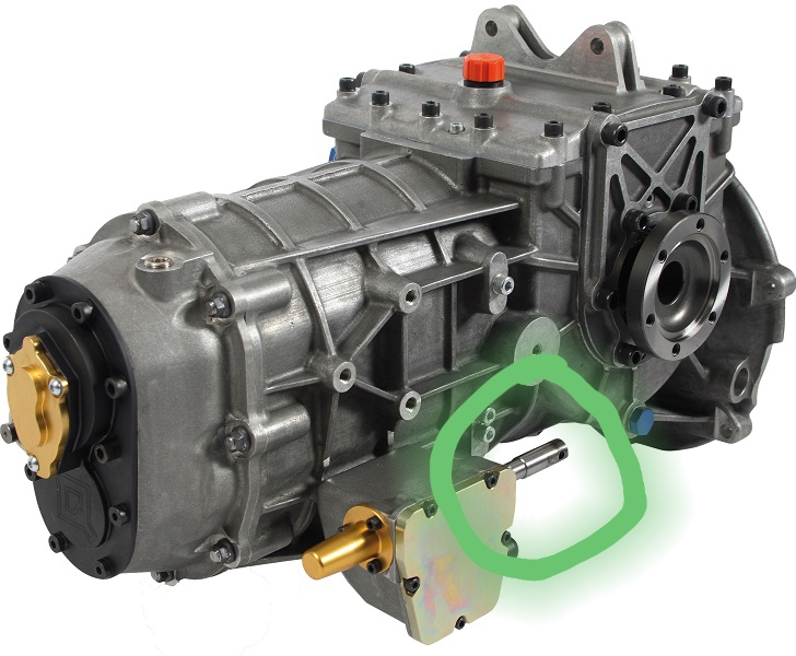

How do I get to go into gear? I don’t have any linkage yet. I also have not put any oil in yet. Cheers, Randy
Randy,
You should be able to operate the shift rod by hand - See circle on pic.
Imagine shifting a manual car > shift rod goes in and out and turns left or right.... turning the input shaft might help - don't use ans tools, be careful.
As for no oil??? There should be some corrosion protection on the gears - turning by hand should not do any harm - my 2 cent
Standard GT40 gear linkage would require you to turn the rod clockwise when looking towards the front of the car, to select the 4&5th gear selector, then pull the rod forwards to engage 4th. Pushing the rod backwards would get you 5th.
