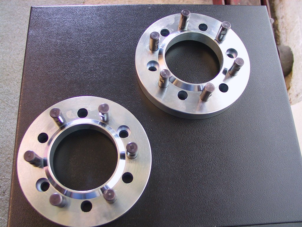

Re: Quick Change Wheel Spacers
Yes there is - see below, Frank

Rick, have you photos of the offset?
Is it a simple process of adding and removing the offsets - a 10 minute process?
What Frank has posted will work. I am not aware of anyone with a Superformance using that system, but no reason it will not work as the wheel and spacer are being held on by the wingnut and the pins are only transferring the driving/braking forces. The limiting factor is the length of the treaded hub so that you have full engagement of the nut on the threads. Wih a wheel of different offset that is not an issue as the wheel center is the same thickness (generally) and you have full engagement of the spinner. The "offset" of a wider wheel should be by the relationship of the center hub to the outer rim edge, not due to a thicker center hub.
