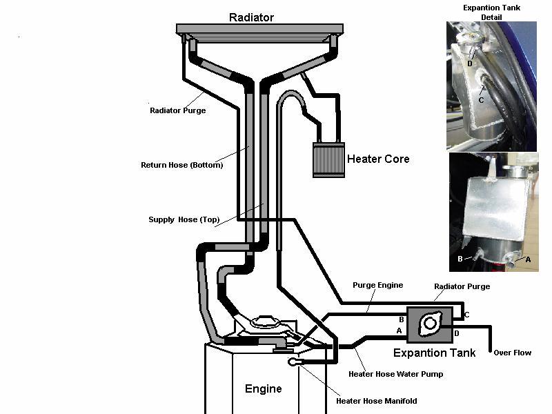

BTW, I installed a lower temp thermoswitch and the fans still don't come on.
Have you verified it's the thermoswitch that's at fault? IOW, how do you know that the thermoswitch is not closing at the specified temp? BTW you can test them in a pan of hot water with a thermometer and an ohm-meter. Or to test in reverse, with everything running if you pull the two wires of the thermoswitch and connect them, the fans should go on.

Good suggestions Alan, yes I did both although I forgot to test the new one before I put it in (assuming new it'll be ok). I thought the old one was bad but I did the water\thermometer test as you mentioned and it worked but at well over 205 deg F. And the fans do come on if I put the wires together.

I just don't get it. Mine comes on exactly when i would expect it to with the supplied switch. I wonder if we all have radiator flow in the same direction...
<later>
In answer to my own question we probably don't. Mine is hooked up backwards from the "official" layout, IOW the thermoswitch is on the same pipe as the thermostat (the supply/hot side). So that at least explains why my fans come on sooner.... :)... one more thing to fix...
