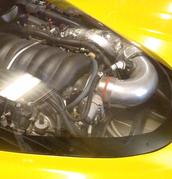

I guess its personal preference but i think it looks pretty tidy with countersunk black on black border paint. I tapping straight into the F/G I can get my windows out in about 1 min flat. I bet they have been in/out 50x and still not a single problem with the lexan or with the F/G stripping out.
True - but air pressure works to hold the windshield in place while the dramatically reduced pressure in the rear works to suck the window out.. How is your rear window retained? Have you had the car to speed without any issues?
