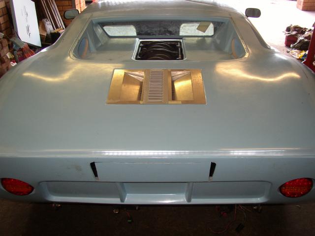

Iain I made a different rear louve but it is at the paint shop untill the new year,(found crack just befor painting) I cannot find a pic of it, I did send a pic to Peter Delaney some time ago he may still have it. I will send some photos ASAP it is styled on the new ford GT rear louve. I think it looks much better but I would say that.

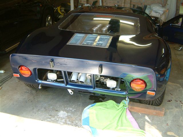

Iain, here's a scrappy old pic of a standard aly DRB louvre panel - available as a spare part from DRB.
Mine is ceramic coated & has stood up to nearly 10,000km without any sign of being affected by the heat.
It would be interesting to know whether this panel is in a high or low pressure area, and whether the louvres are better at extracting hot air than the simple holes (which I suspect is true).

Found this old pic of my rear louve. I will put up some more when it is fitted to my car it will be painted to match the car colours.

Thanks for taking the time to reply to my post, your design seems completley different to everyone else, is that standard to the new GT 40 or did you design it yourself.?

I am hoping that the "regular" louvre panel will help to extract hot air from the engine bay, but I have to say that my initial fears about heat in the engine bay seem (to date ) to be unfounded

Iain I have made a number of changes to my car to make it appear less like a sixty's car,this is one of them. I designed it after looking at the new Ford GT it is made of thin alloy sheet tig, tack, welded together and boged (bondo for our US friends) over, the bog cracked while it was being sanded for painting and is still at the paint shop. I should have welded it up fully but I am always learning by my mistakes. I will put up some shots as soon as it is painted.

Hi Peter,
Iain
Iain, heat under the clip is an issue with CAT's, but not much of a problem without them - do not ask how I know !!
