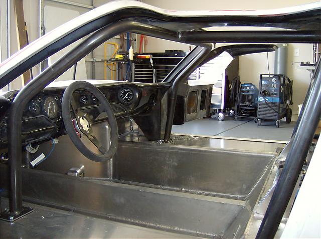

I had this for a cage:
attachment.php
After sitting in the car (once I got it together and running), I was not fond of how little space there was between it and my noggin. I snipped out the front hoop and connecting tubes and haven't thought twice about it. Now I just have the roll bar. When you sit in the seat and are confronted with it, it's easy to see it'll do more harm than good in the most likely situations.
At this point, the only way I would consider caging the car is if I removed the inner liner of the spider and tucked the bars up against the interior of the roof panel.
I assume certain risks when I choose to drive the car. I feel removing the front hoop reduced the risks to which I am exposed.

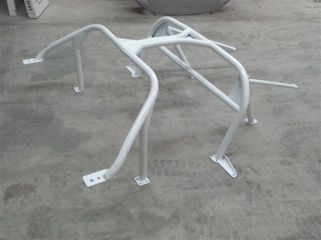

I have this cage made by RF which I was going to fit to my car after rego...maybe not such a good idea now....I must say that this a race only option from RF.
