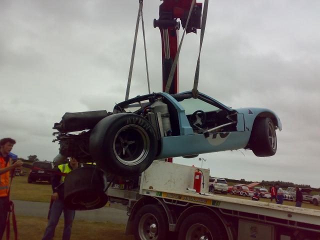

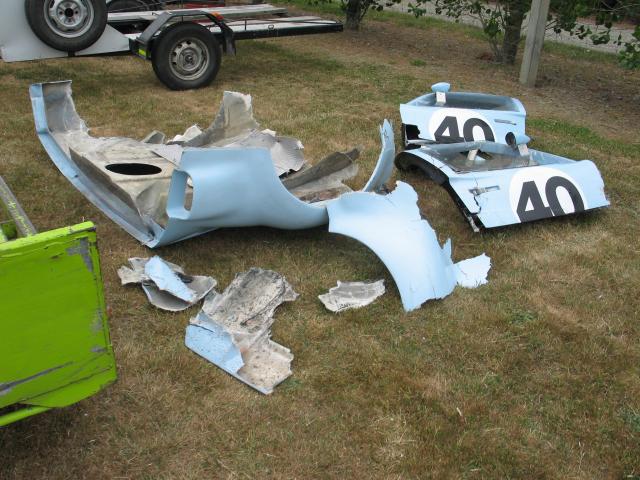

Ive spoken with Lim this morning, Russ will have a few bruises etc, it appears that it happened at end of main straight @ Levels Timaru, fastest part of track, not sure of exact circumstances, but in practice & dont think any other car involved, sounds like it might be due to an unforseen 'outside' factor which Russ had no warning of..dont mean to create conjecture, but best we wait for further info on that.

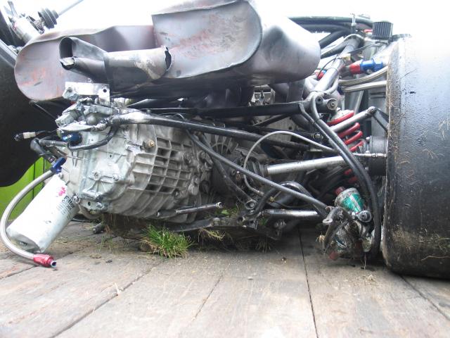

Going by middle pic, if you enlarge it the bell housing is broken & shifter mechanism has taken a hard hit into the embankment along with a lot of other collateral damage.
