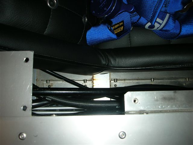

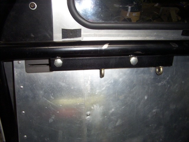

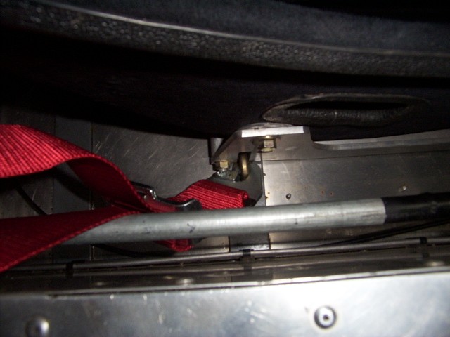

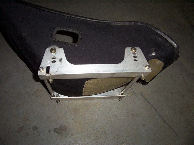

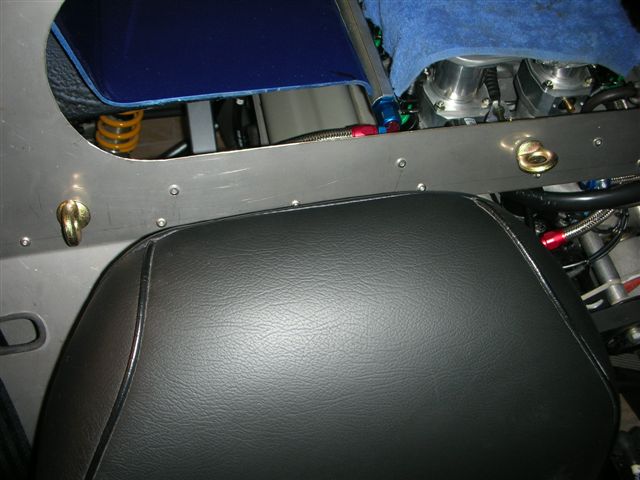

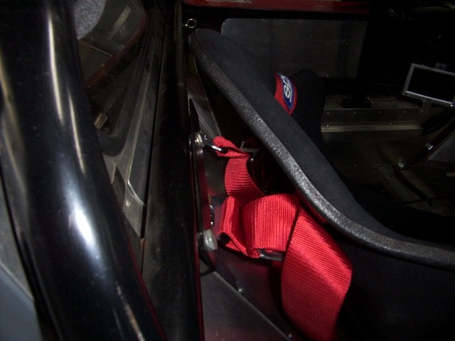

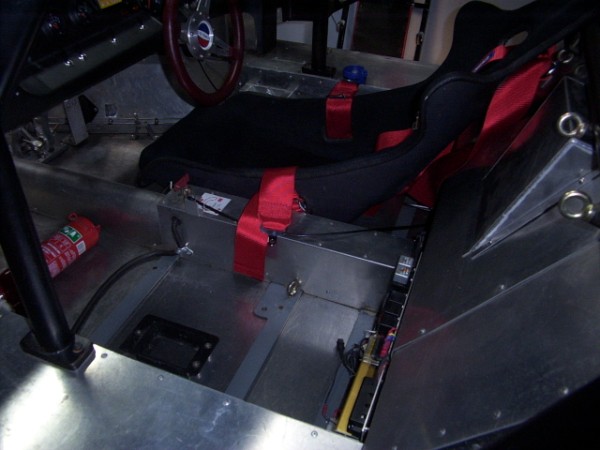

When I put my drivers seat in, I did intend to fit the gearshift panel and I have only tonight removed the aluminium angle bracket from the floor. So I did indeed have the space problem for the harness eyelets. I actually checked
the eyelets into the seat mounts and it worked really well. I will include photos of this later tonight when I post the promised seat photos.

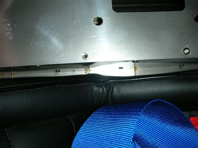

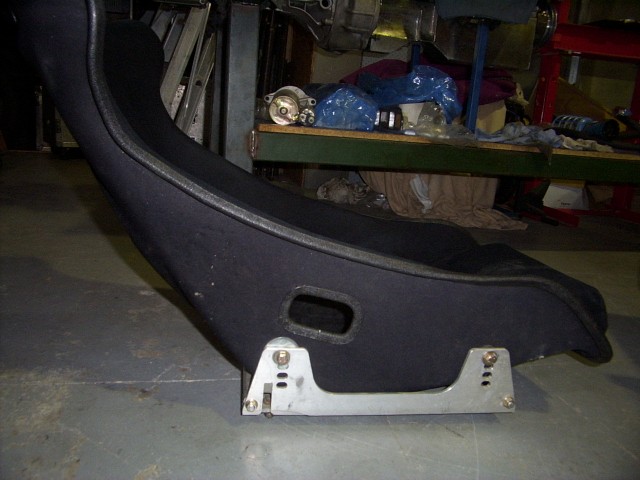

Photos of Ross' seats and mounting including belt eyelets.
