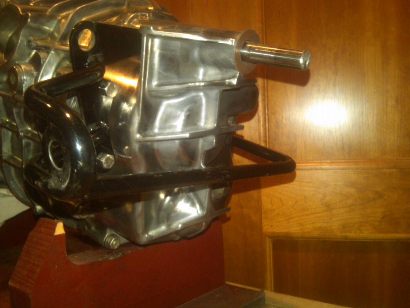

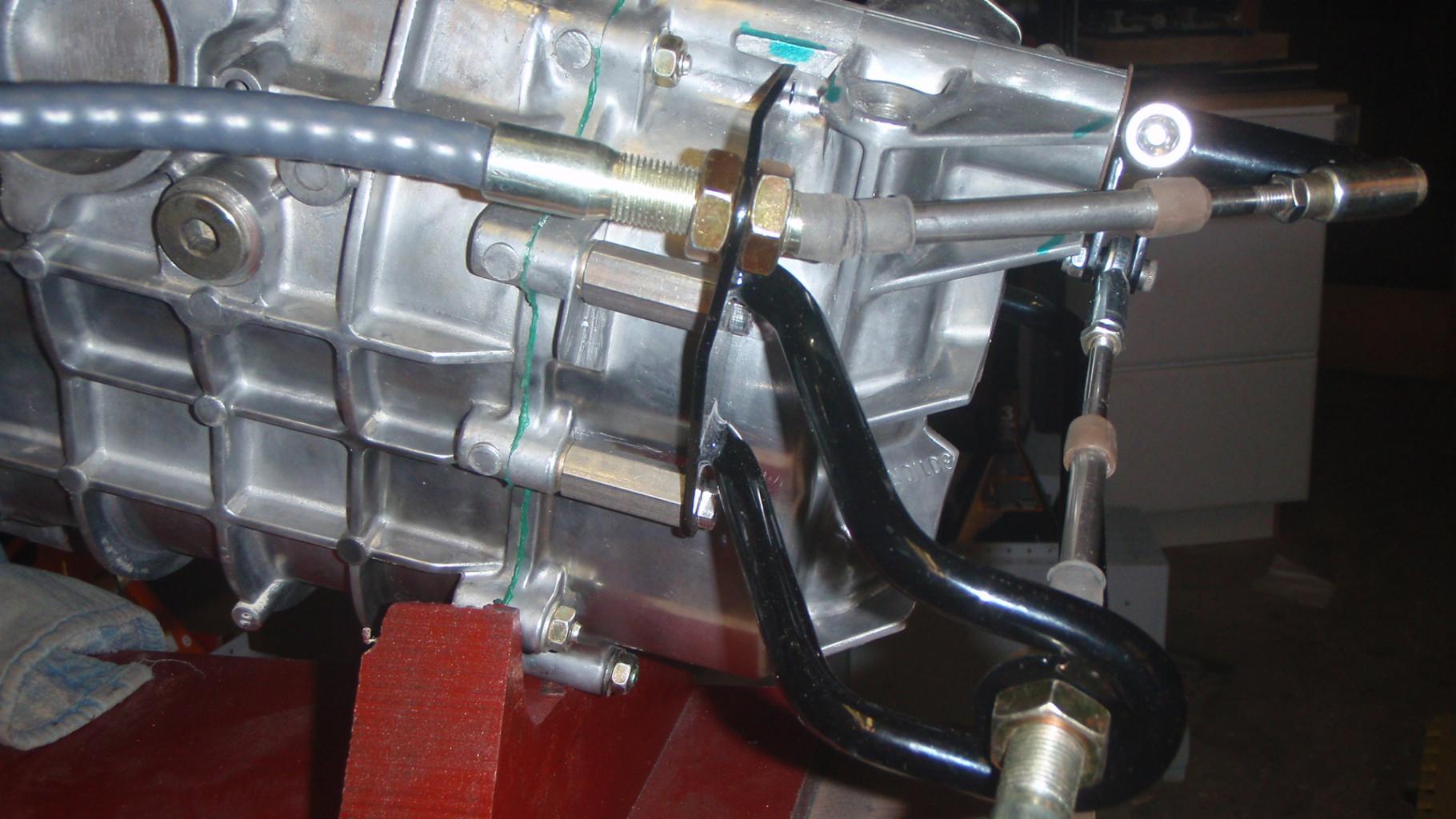

I bought a G50 off the “other” forum and started playing with that while waiting for my kit. It was a long tail and needed to be shortened, which I was told would be easy to do. Easy is a relative term. Wasn’t easy for me… With some help from a post on this forum (Thanks Randy!), I had some pictures/drawings to help me get started.
I sent the transmission over to a local Porsche specialist and he cracked it open to check and see how it looked as I had little history on it. When I got it back, I cut the case with a hack saw and file and had a local shop machine in the bearing race/seal on the tail (the original gets cut off when you shorten the case). He also helped me swap the vent/fill plugs. I replaced the front input shaft seal and installed the rear seal/bearing.
Some pictures attached. A before picture of the long tail, one showing how filthy the transmission was, another with it cleaned up a bit and the case cut and shift cable bracket installed. You can see the nut extenders I had to use. Even with the case shortened as much as I could, the bracket wouldn’t line up. Big thanks to Jim over at Cable Shift. He helped me figure out a solution. Really helpful and patient guy. He also sent me a new part – the sleeve that fits over the shift rod was machined too small and wouldn’t fit. When I got the new one, I had to tap a tread into it to secure it to the shift rod. Last picture is showing the shortened case and the cables installed. I bolted the shifter to my work table and was able to adjust everything and get all the gears.

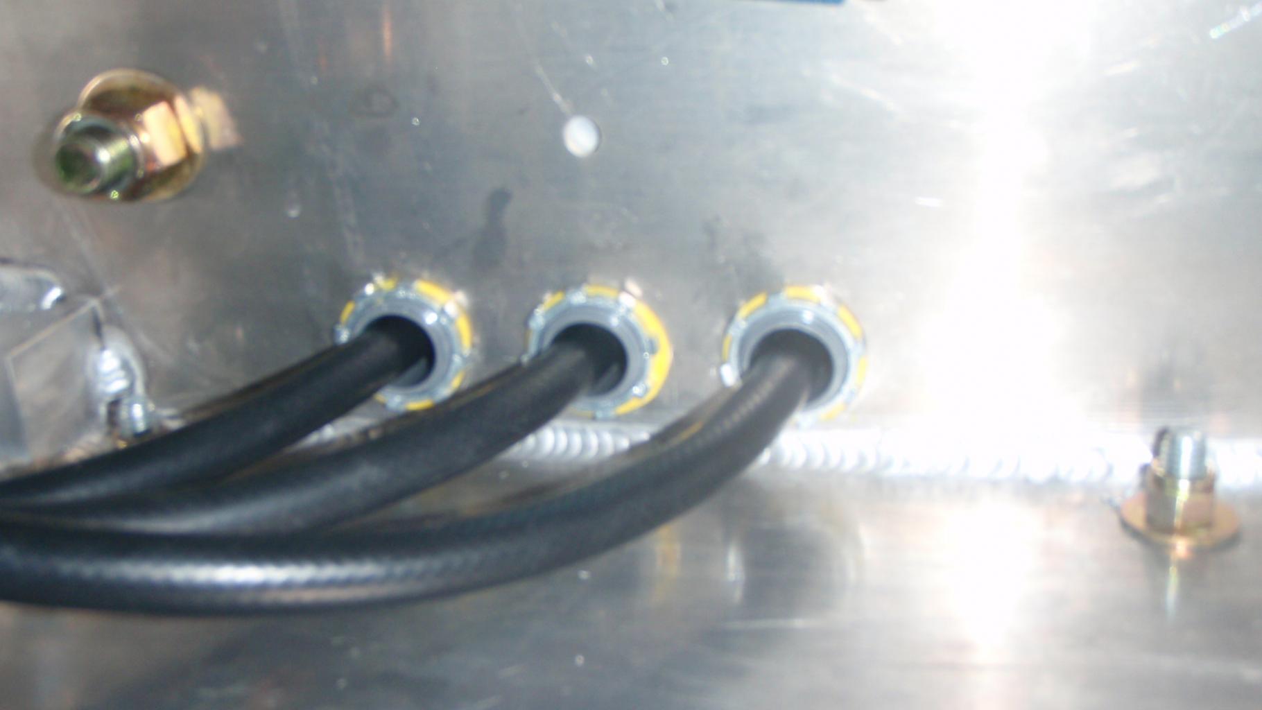

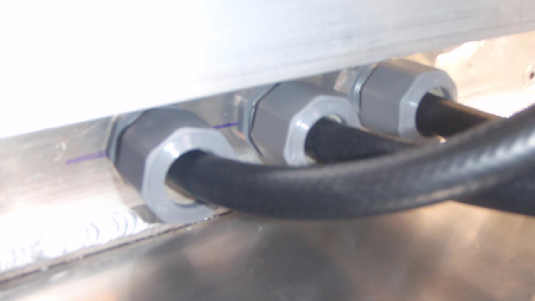

Mounted the reservoirs, drilled the holes in the front foot well and found some cable glands the perfect size to secure/protect and waterproof where they go through the foot well. Torqued down all the suspension (anything which won’t need adjusting later), secured the brake/clutch lines and connected everything up to the calipers/residual valves.

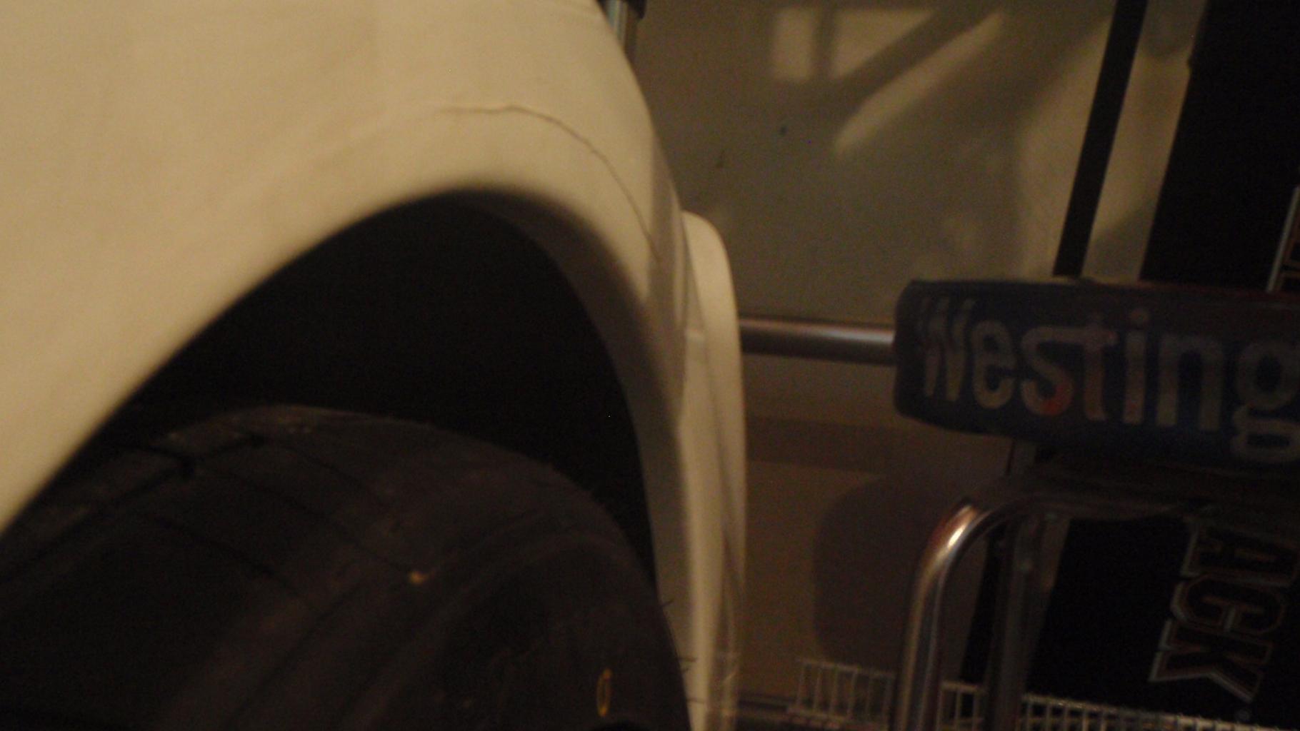

Some more cutouts, the rear deck, hood, trimmed all the fender returns, got the gas filler mounted. I had to get longer screws. The fiberglass was thick here and I think the cap assumes your mounting it into a steel body. Last pic (a little fuzzy) shows how small my workspace is. My wife already warned me she is NOT giving up her side of the garage. I did some major remodeling and got all my windsurfing/kite boarding/kayaking/cycling gear stored in other places so I could have room for tool boxes and parts.
