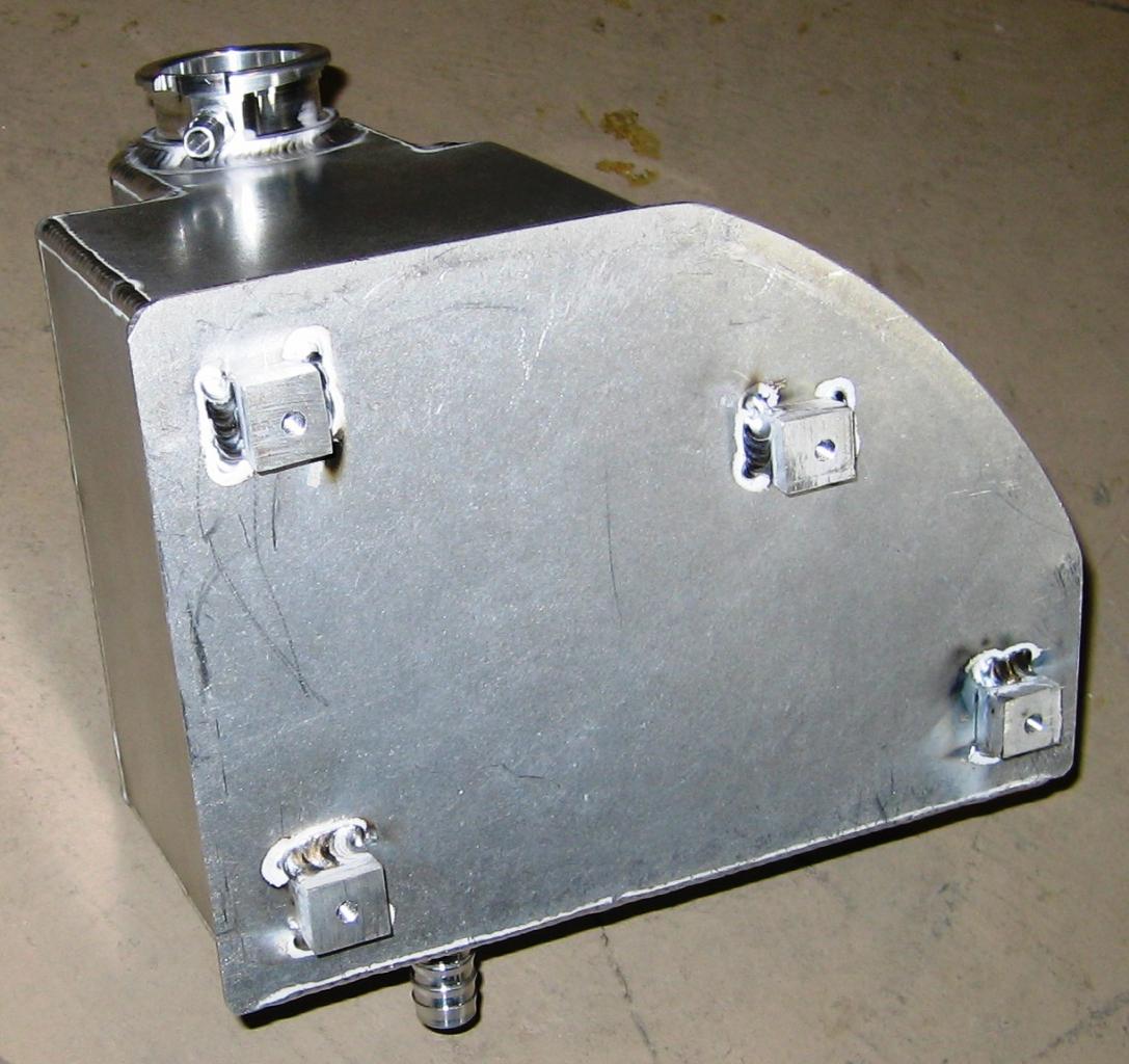

Standoffs like this???
If there is any flex in the back panel. A simple x-brace weld between the stand offs or to the entire back with mounting tabs on the side if you are not using stand offs should fix it. It is the same reason you put beads on large flat panels as it adds strength and helps to stop distortion or flex in the panel.

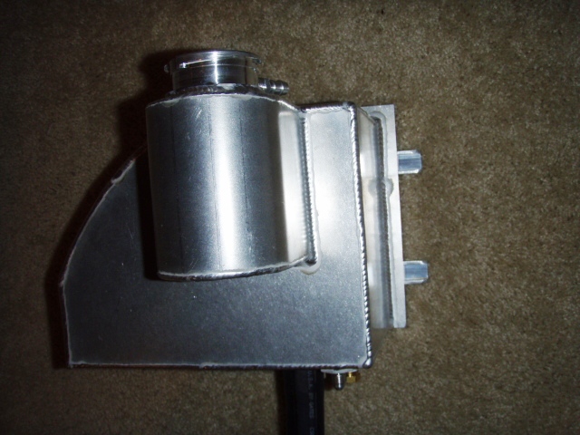

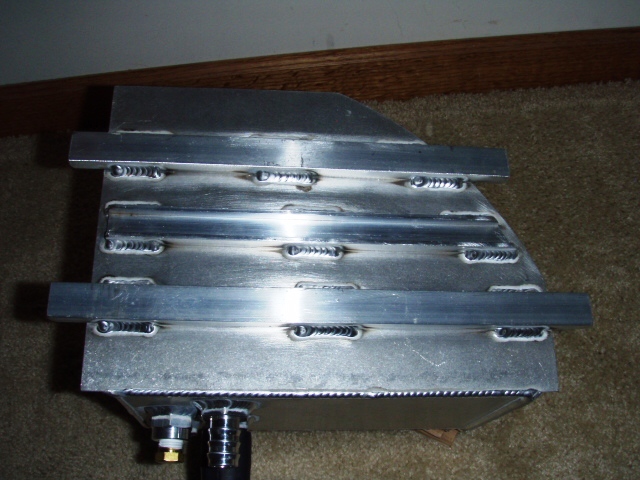

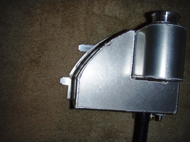

Dave Lindemann
I haven't heard back yet regarding the pressure test of the installed tank yet (the pressure tester would have just arrived today) but I just picked up my tank from the welder. I had them reinforce the back plate using 6061 aluminum channel (1/8" wall by 3/4" wide by 3/8" tall). We ran 3 strips across the back of the tank as shown in the photo. I won't be able to pressure test it until my tester is returned but it certainly looks and feels very stout. The U-channel provides 4 mounting points and a stand-off from the firewall.
Dave L
