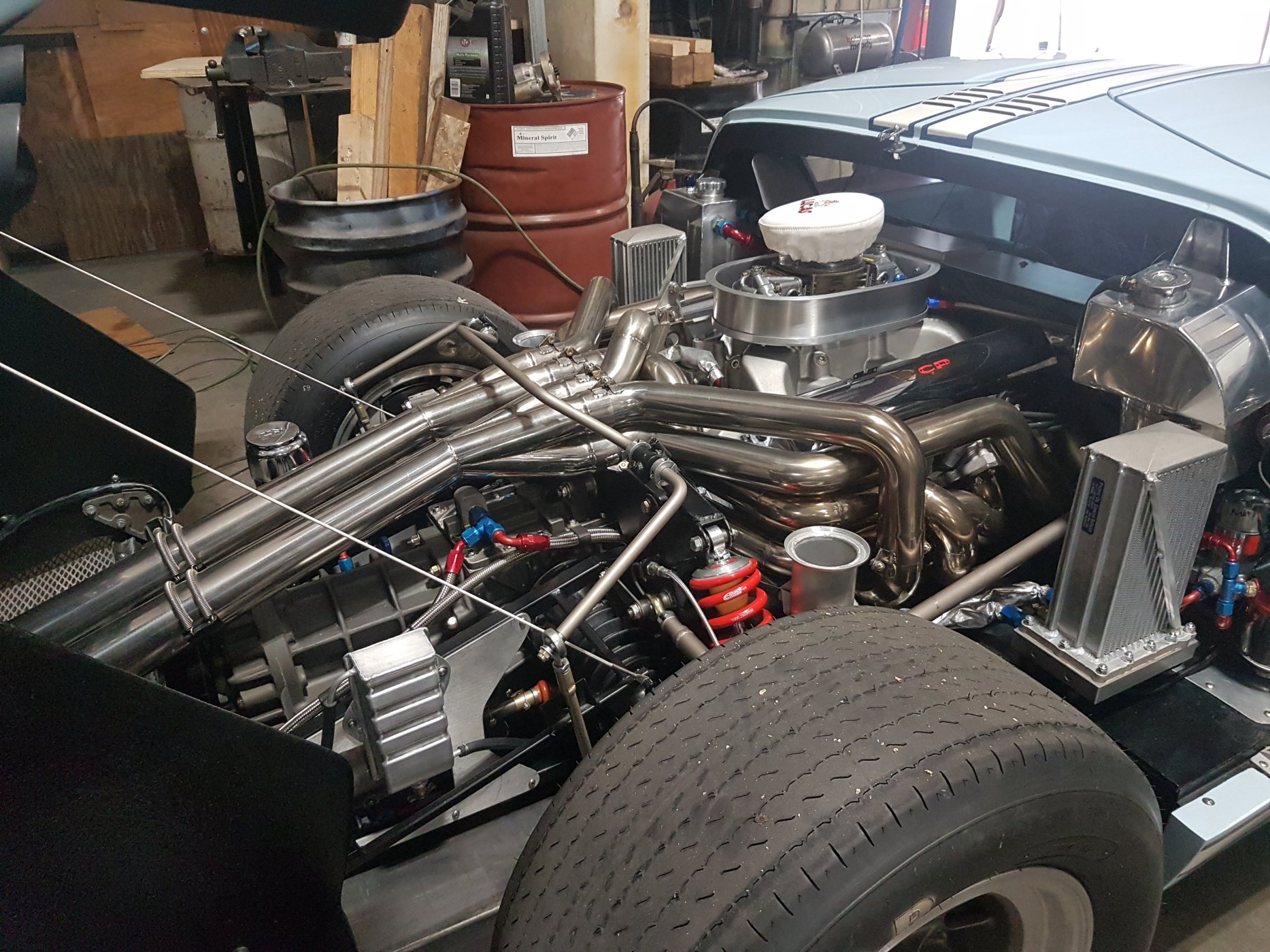

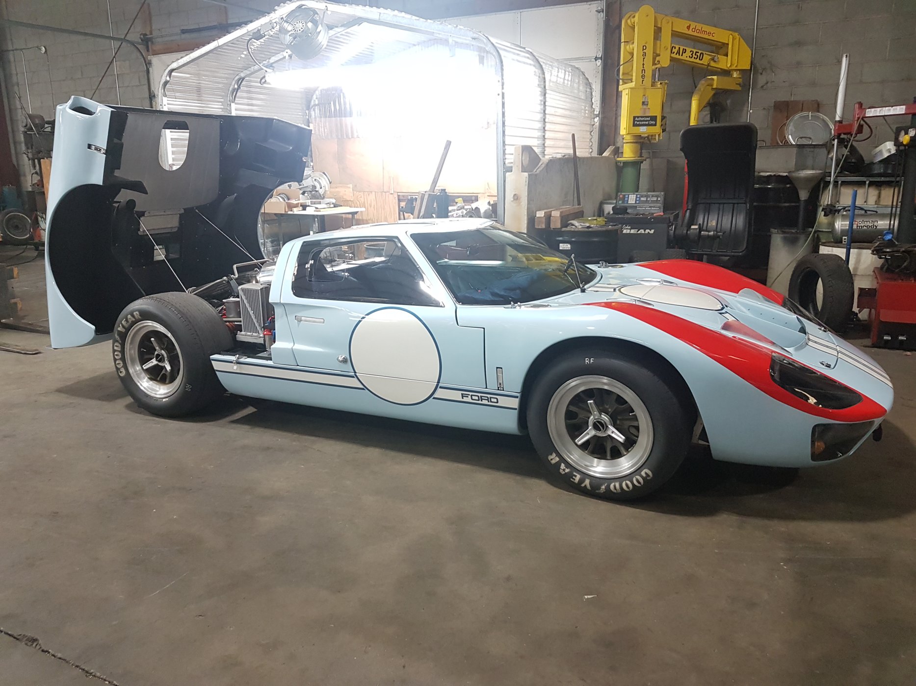

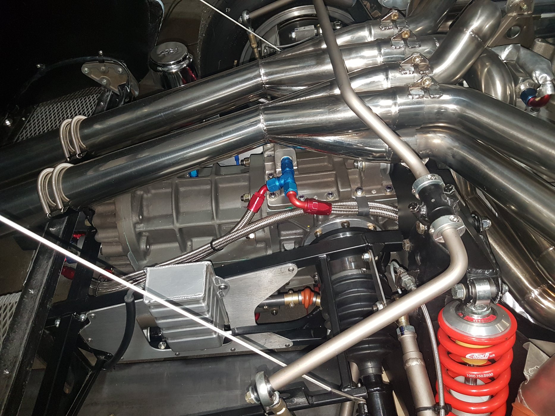

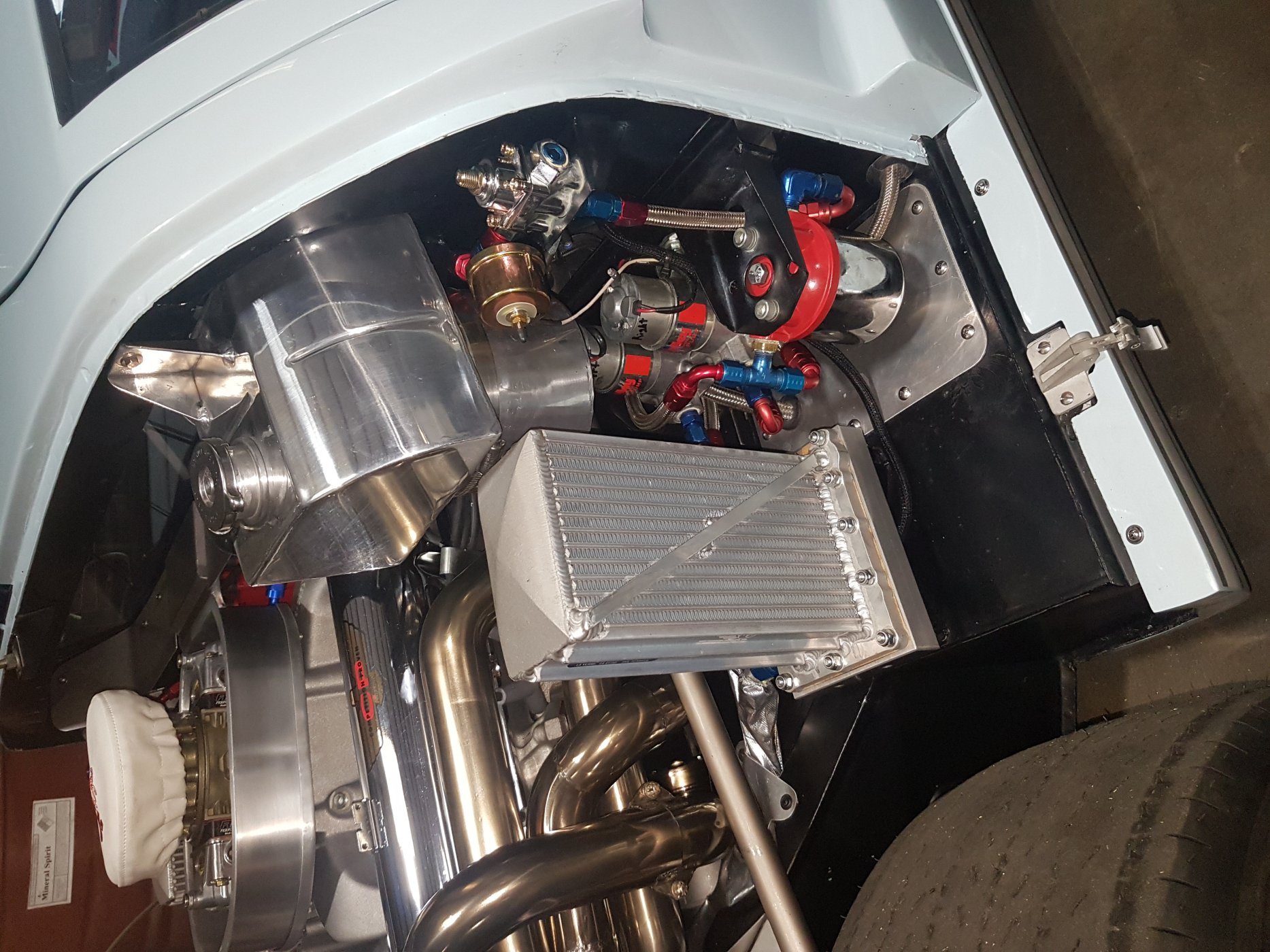

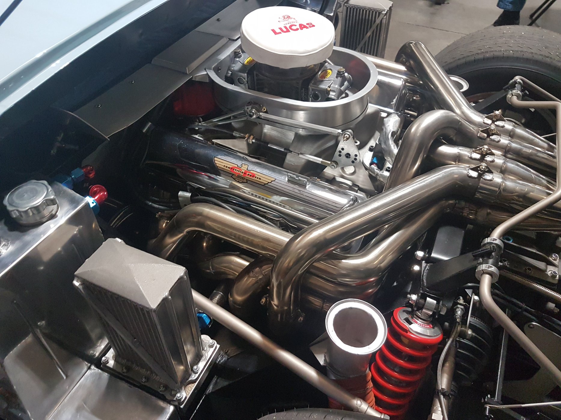

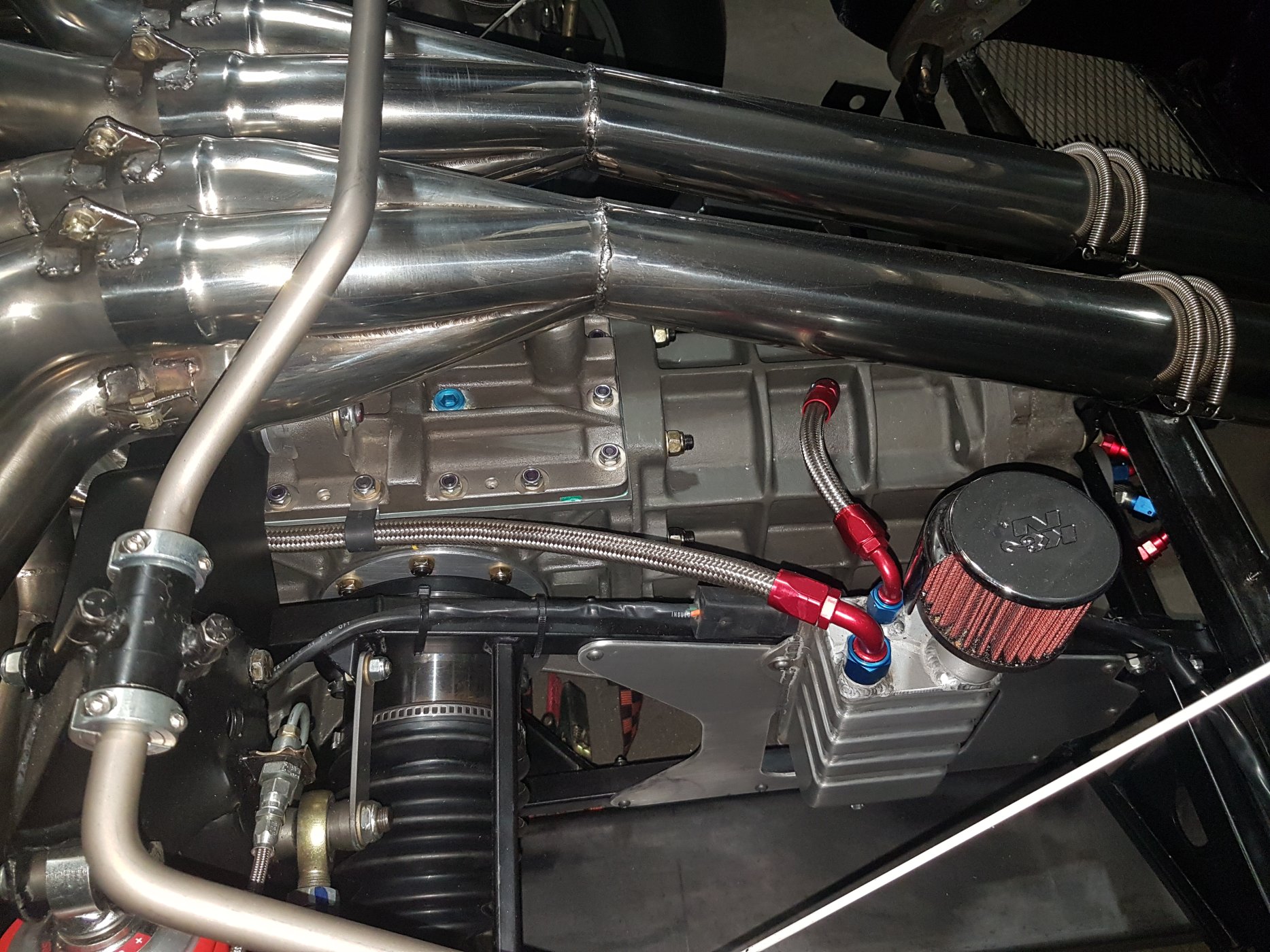

The install of the drivetrain was completed by Paul Whitlock at Holman Moody. The car's owner had very specific specifications for the setup. I was at the shop a couple weeks ago and had a tour of the car. It looks even better in person.
