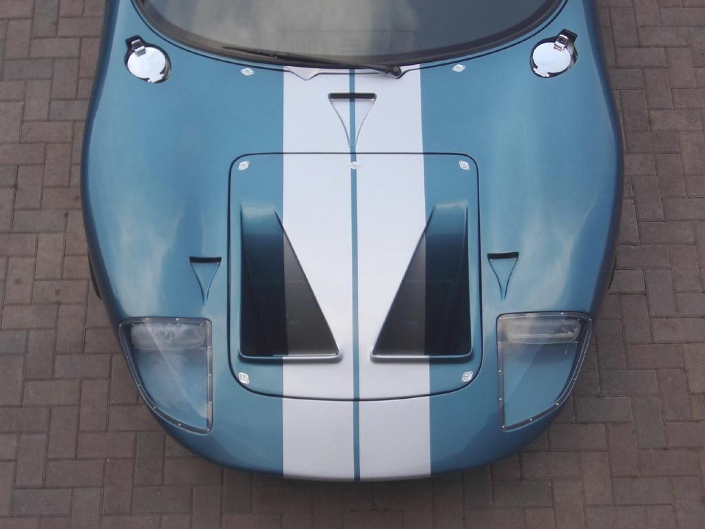

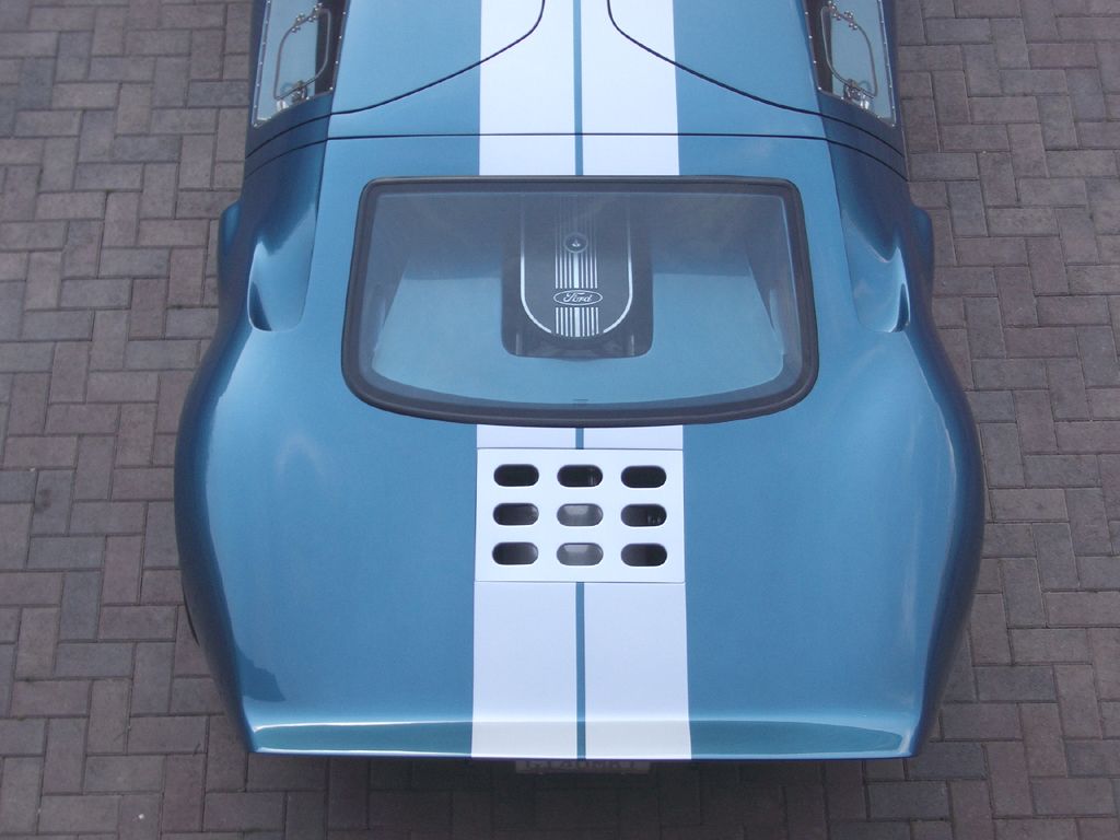

I am not sure if example pictures of stripes will help or not but here are a few of my car. The top stripes are painted on and the side rocker panel stripes are vinyl.
Note that the outside width of the stripes have been set to exactly match the width of the oval vent plate on the rear clip (18 inches).

Likewise the space between the stripes has set to match the nose width of the NACA duct just in front of the windshield (3/4 inch).

Note that as the stripe dips off into the nostril, the side of the stripe continues to appear straight and square. This is an optical trick. To make the stripe appear straight, the side line was actually angled to compensate for the compound surfaces of the car.
