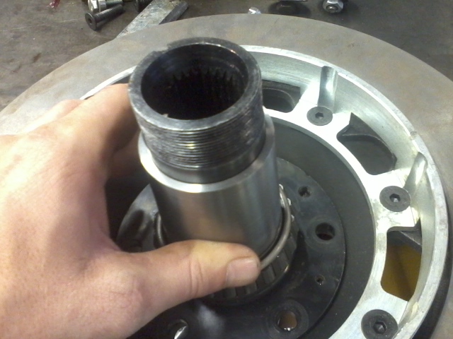

Holman Moody installed my crush sleeves to keep the wheel bearings in place. Paul Whitlock, who used to work for Dennis Olthoff, is now at Holman Moody. He would be the source for information on this. Whether or not you could get his cooperation is a question, however.

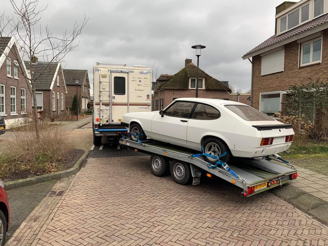

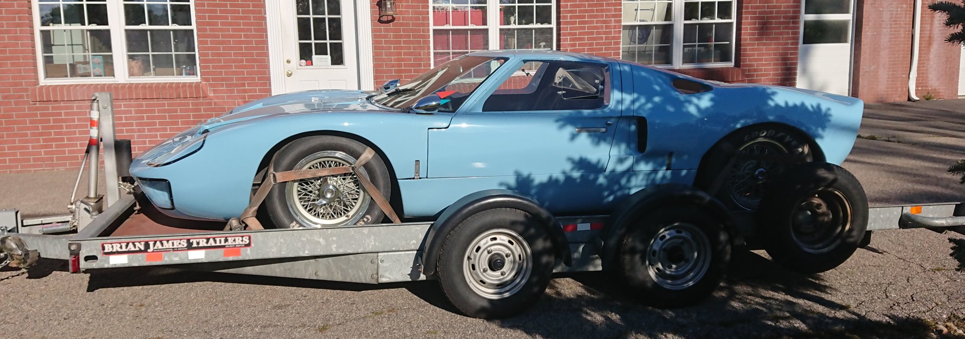

Depending upon the nature of your trailer, I recommend either tire straps that go over the top of the tires (along the tread). This requires a trailer with holes in the bed of the trailer that the straps' hooks can go into so the straps are inline with the tires (I have a 30-year old Brian James Trailer with the appropriate holes). Otherwise, you can use a ratchet strap with a "dog bone" or short strap that you can wrap around the top portion of the tire (see below). Both of these methods will let the car's suspension move naturally as you go over bumps.
When buying tie down straps look for the Working Load Limit (WLL), not the breaking strength. Breaking strength is for a static load. WLL is for a dynamic load (such as slamming on the brakes). WLL is usually 1/3 the breaking strength, so a 10,000 lbs. breaking strength strap is probably good for 3,333 lbs.
Going through the wheel can risk the strap damaging the wheel's finish.
Do not use tracks for securing a car unless they're certified to hold the weight of a car, most are limited to the weight of a motorcycle.
