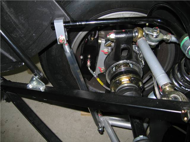

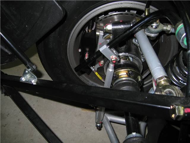

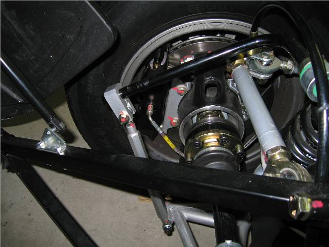

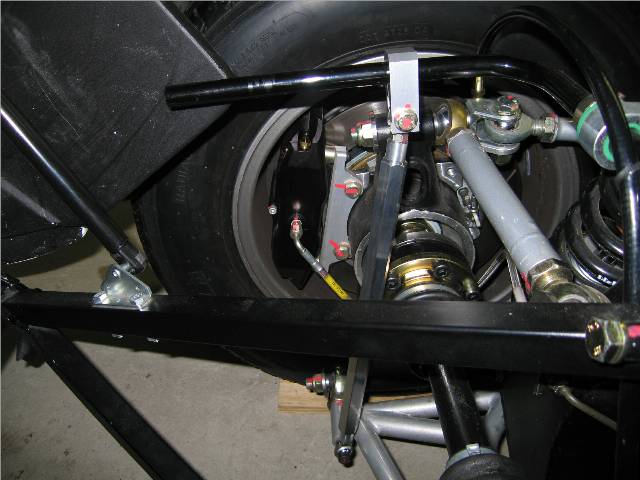

The sway bars on the SPF cars aren't like the originals. Some of the original manufactured parts will work and some won't. One of those parts that doesn't, is the rear links. I have made longer rear links. Attached are pics showing both the stock and the longer links in the forward and aft position. The longer links definetly allow for more adjustment and a more linear motion. There isn't as much angle between the upper mount and the links. This might even help transfer the load better, less side force. As I mentioned before, if anybody is interested getting some made or has any comments, please let me know.
