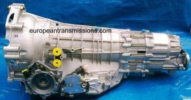

The zf 5hp24a is one transaxle that can handle serious power and will run a flappy paddle gearchange. Its used on all the big 4ltr plus V8 and W12audi`s . I am not sure of the implications of running one of these without the 4wd connected.
Bob
Yeah, it looks like it was AWD only. Has anyone run these before with a disconnected tailshaft? Is there an LSD inside between the front and rear outputs, is it directly linked, or is it completely open?
