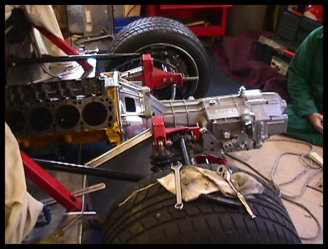

This is what I mean.....
6 sp sequential sounds nice. Sounds rather expensive. Quaife > i can afford /ubbthreads/images/graemlins/tongue.gif
