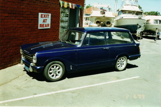

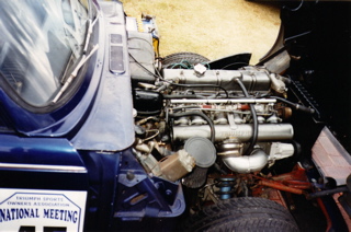

You've gotta love the old Triumphs. It's fair to say that I have collected a few!
Here is a special one, 13/60 Estate, 2.5PI motor, converted to EFI (XJ12 Injectors), Motec, Eaton M90 Supercharger, 3.9LSD - Nissan IRS, big brakes, was 300hp and road licenced!
I got a bit bored and pulled the Triumph motor in favour of the RB26 GTR Skyline engine. Ditched the twin turbos and went for the same Supercharger again! 400hp now. Last race meeting she tipped in at 801kgs wet.
I've had several Mk3 Spitfires to, just begging for a 2.5 and 4 speed + OD.
Go get your GT6!

Skyline engine, swing axle rear suspension and a cardboard formed thing that covered the gearbox and start of the prop shaft
Now that sounds scary!
BUT FUN!
No swing springs, yuk! I used to get the inside rear 12" off the ground in autokhanas.
Just cut a K Frame from a saloon / TR6 chassis and weld it in to a herald one. A bit harder for a Spit / GT6, but still very possible. Then mount your coil overs off the shock mount on the trailing arm into the ridge in the floor (for the axels) and you're off.
Change the front brakes to saloon / TR6 as well to match stud patterns and get bigger brakes by default.
Go one step further and drop the triumph diff for a Nissan / Subaru R180 LSD (3.9:1) and with the weight of these cars, get yourself an unbeatable autokhana racer!
