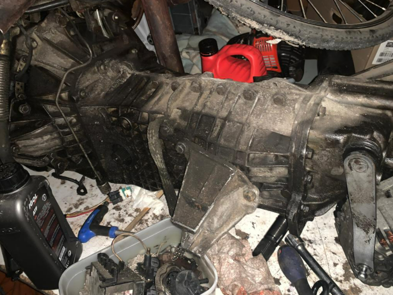

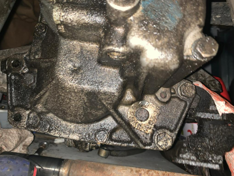

Hello,
Can anybody help me identify this transmission? It was offered to me but unsure if it would fit on a 302 v8 with adapterplate and if I have to change the direction? It's supposed to come off a Renault R25 V6, but I cannot find any info on this particular type online.
Many thanks for the help!

Hi,
here you find some info
Paul
  • Renault_Alpine_A310_V6_-_Manuel_de_reparation_-_Boite_de_vitesses_mecanique_UN.pdf

A bit hard to read the tag with all the crud on it.
Renault box data
Part No. Ist 2nd 3rd 4th 5th Rev Diff
20 369.00 3.36 2.06 1.38 1.06 0.82 3.55 4.11
369.05 3.36 2.06 1.38 1.06 0.82 3.55 4.11
20TX 369 3.36 2.06 1.38 1.06 0.87 3.55 3.778
20LS/TS 369 3.82 2.18 1.41 1.03 0.86 3.55 3.778
30TX 369-01/06/017 3.36 2.05 1.38 1.06 0.82 3.55 3.89
30TS 369-01/06/014 3.36 2.05 1.38 1.06 0.82 3.55 3.89
21Turbo UN1-013 3.36 2.05 1.38 1.03 0.82 3.54 3.44
25GTX UN 1-03 3.36 2.05 1.38 1.04 0.82 3.55 3.89
25V6 UN 1-04 3.36 2.05 1.38 0.96 0.76 3.55 3.89
Alpine GTA UN1-05 3.36 2.05 1.38 1.04 0.82 3.55 3.44
25 UN 1-06 3.36 2.05 1.38 0.96 0.76 3.55 4.11
AlpineTurbo UN1-07 3.36 2.05 1.38 0.96 0.76 3.55 3.44
25V6 Turbo UN1-08 3.36 2.05 1.38 0.96 0.76 3.55 3.778
Chris Cole is the guy to speak to with anything related to Renault boxes, upgrades, LSDs, rebuilds etc. He has been ill lately but hopefully he is OK now. He will know all about your box and its suitability.
Does not do internet so ring him on 01952 416051
