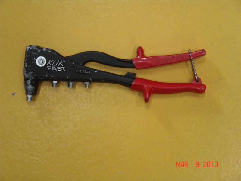

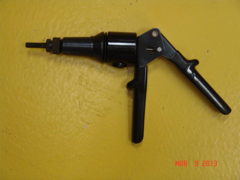

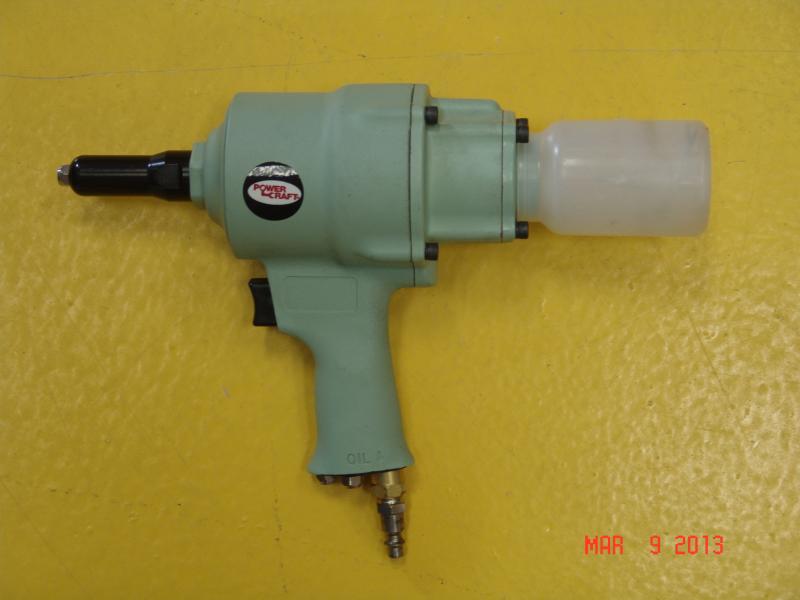

Assuming you're talking about blind rivets... the type of riveter you'll need depends on the type of rivets that you will be pulling. Are these cheapo hardware store type "pop" rivets or something else? Huck and Cherry both make a very high-quality rivet that retains its stem and is a bit expensive but reliable- the CherryMax and Magna-Lok. AVEX rivets are a good compromise- "semi-structural", a wide grip range, install with ordinary pop rivet tools, ans are inexpensive. Then there are the aircraft blind rivets that require a very complicated and expensive installation tool. On top of all this, there are different rivet body and stem materials. Avoid cheap steel stems & bodies- they rust!

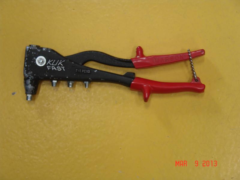

Think about the purpose of the rivets you will be using. Are they just to hold a panel on to keep out dust & dirt or they to add structural strength & stiffness to your chassis? Here is what I have in my shop. I also have a huge long-handled manual tool that's not shown.

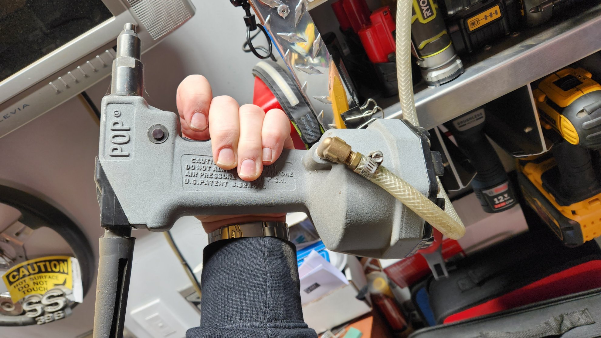

I have the Pop prg510 pneumatic and it's really nice. The down side is having to fire up the compressor for a few pops. Lots of the on ebay as well in the 200 mark. I got off my a$$ and ordered the Milwaukee 12v and should have it tomorrow if what they say is true about quick delivery :) will report how it works if anyone interested. One thing the Milwaukee had was an option for a long snout to get into tight places

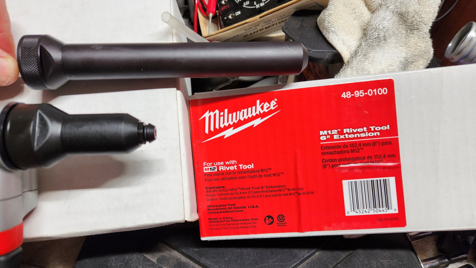

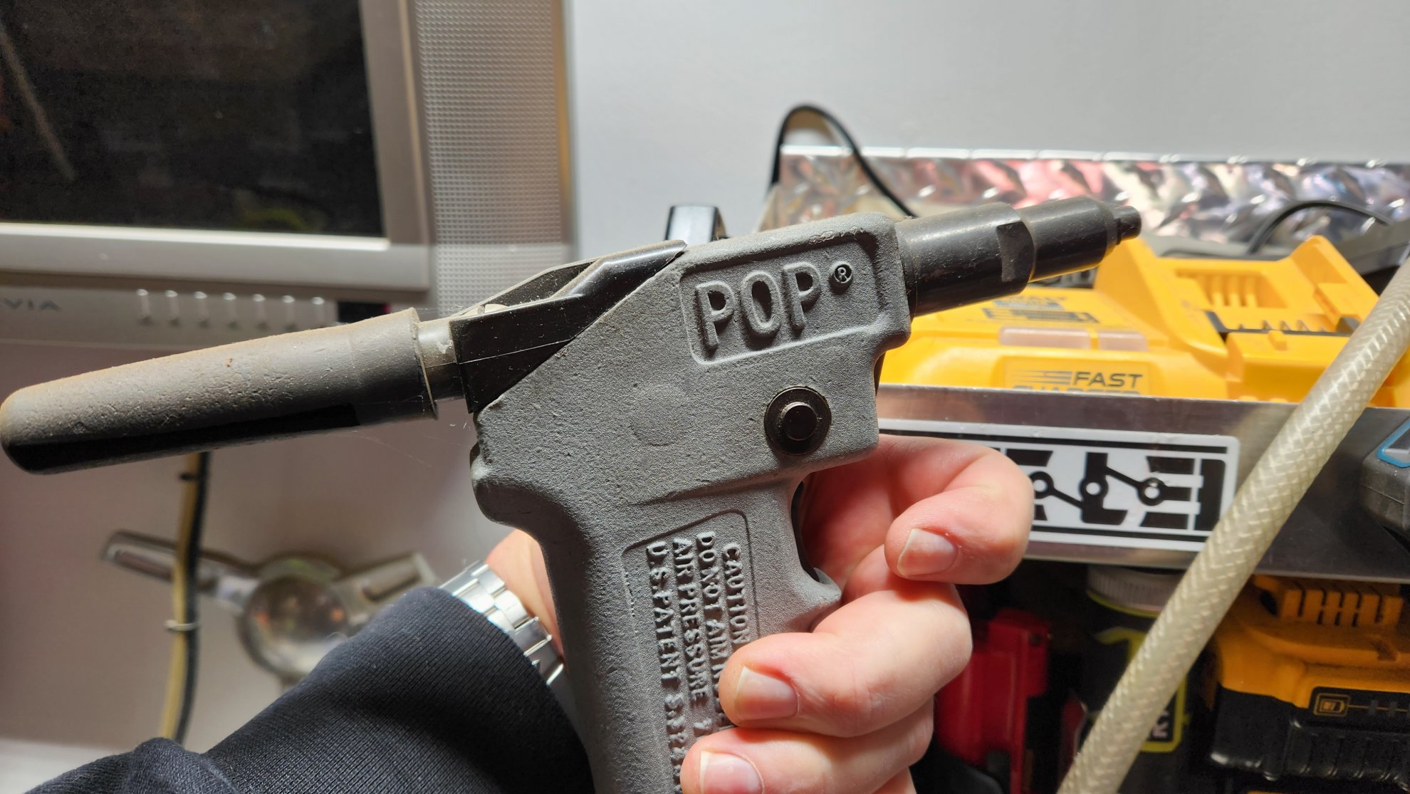

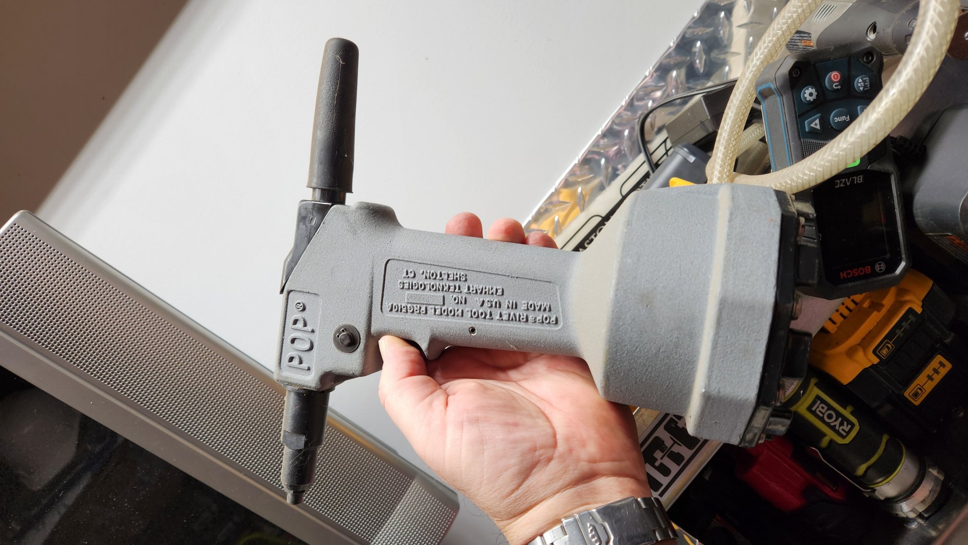

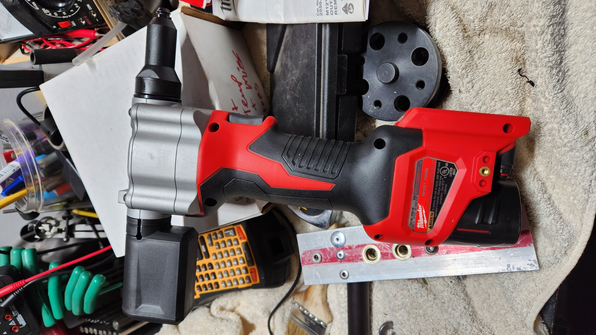

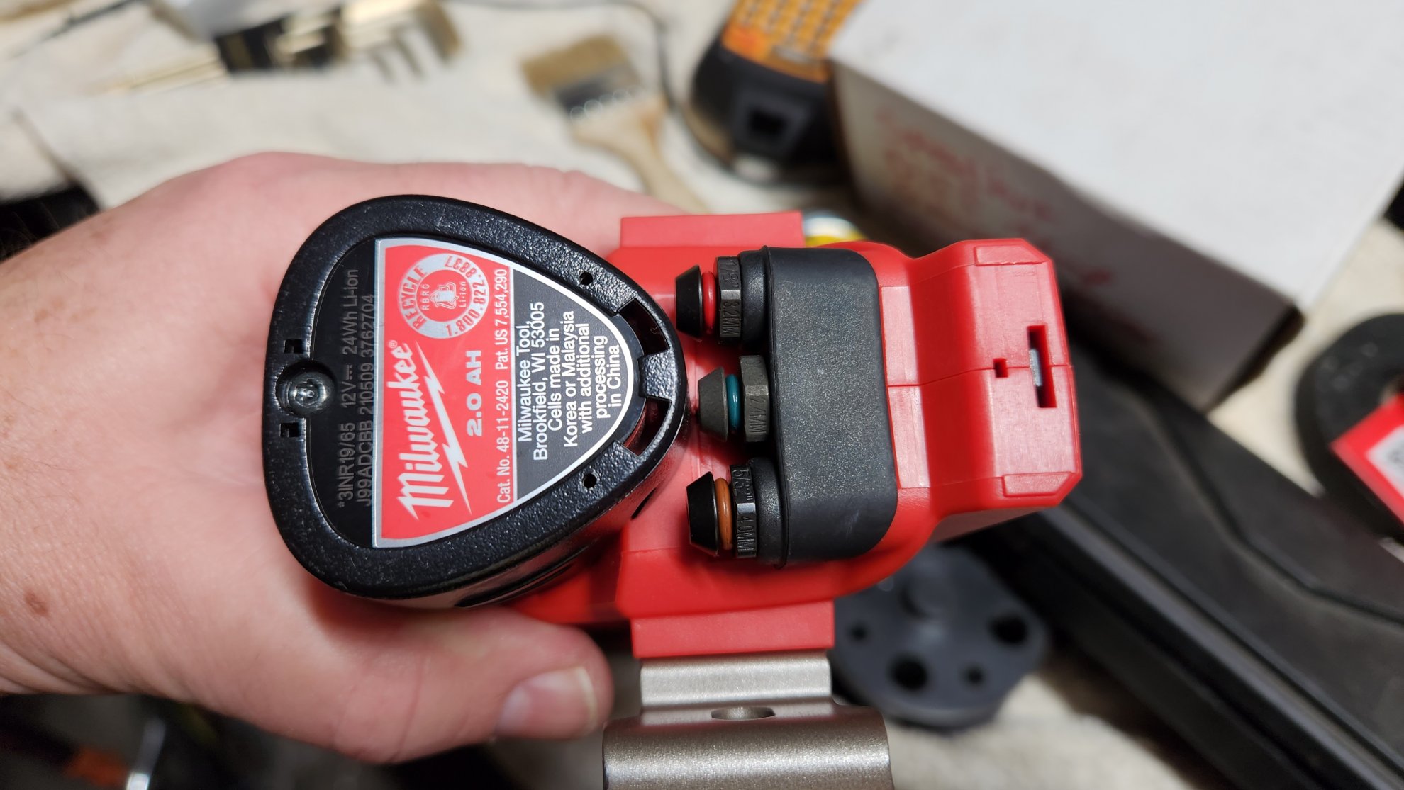

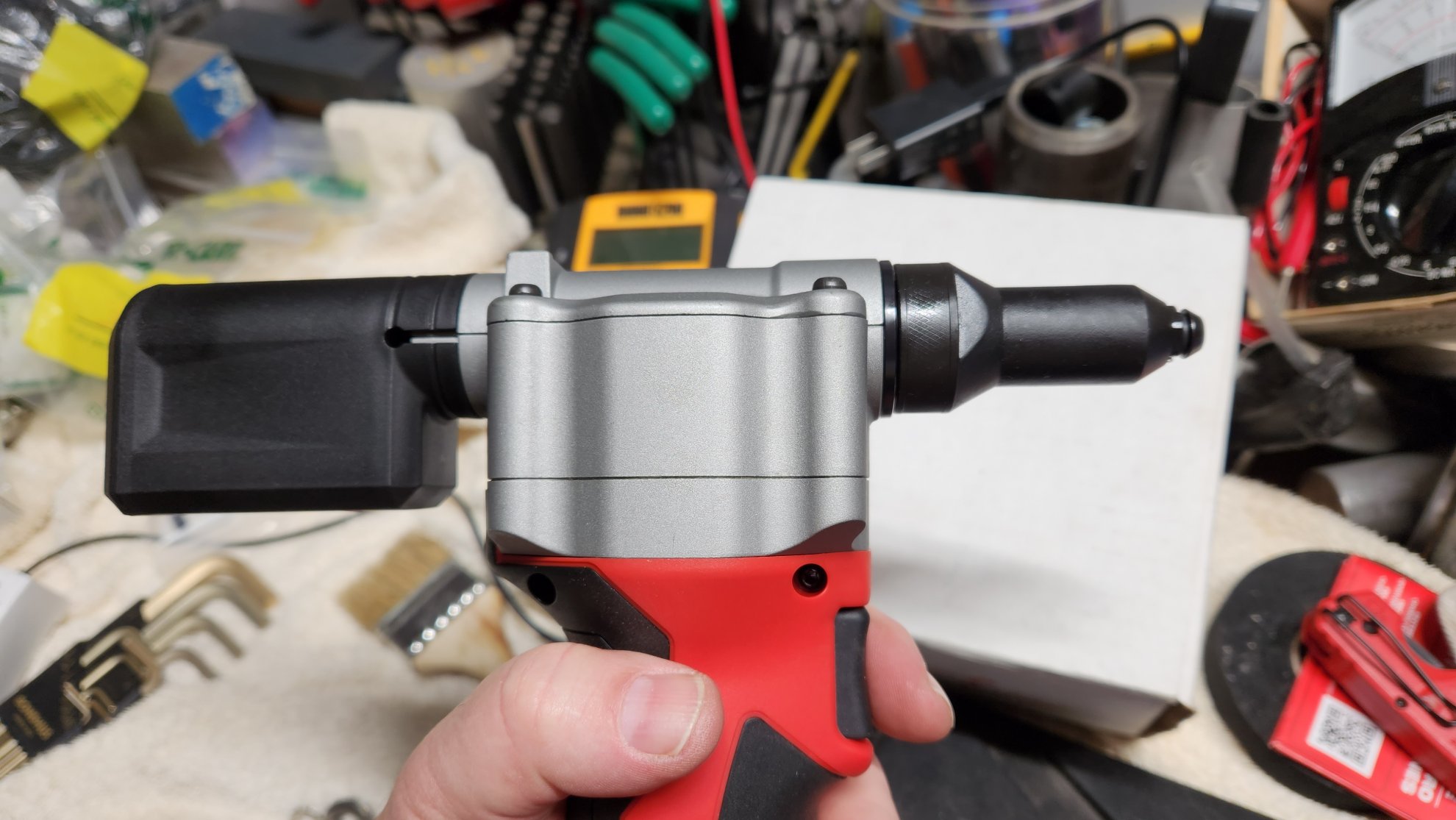

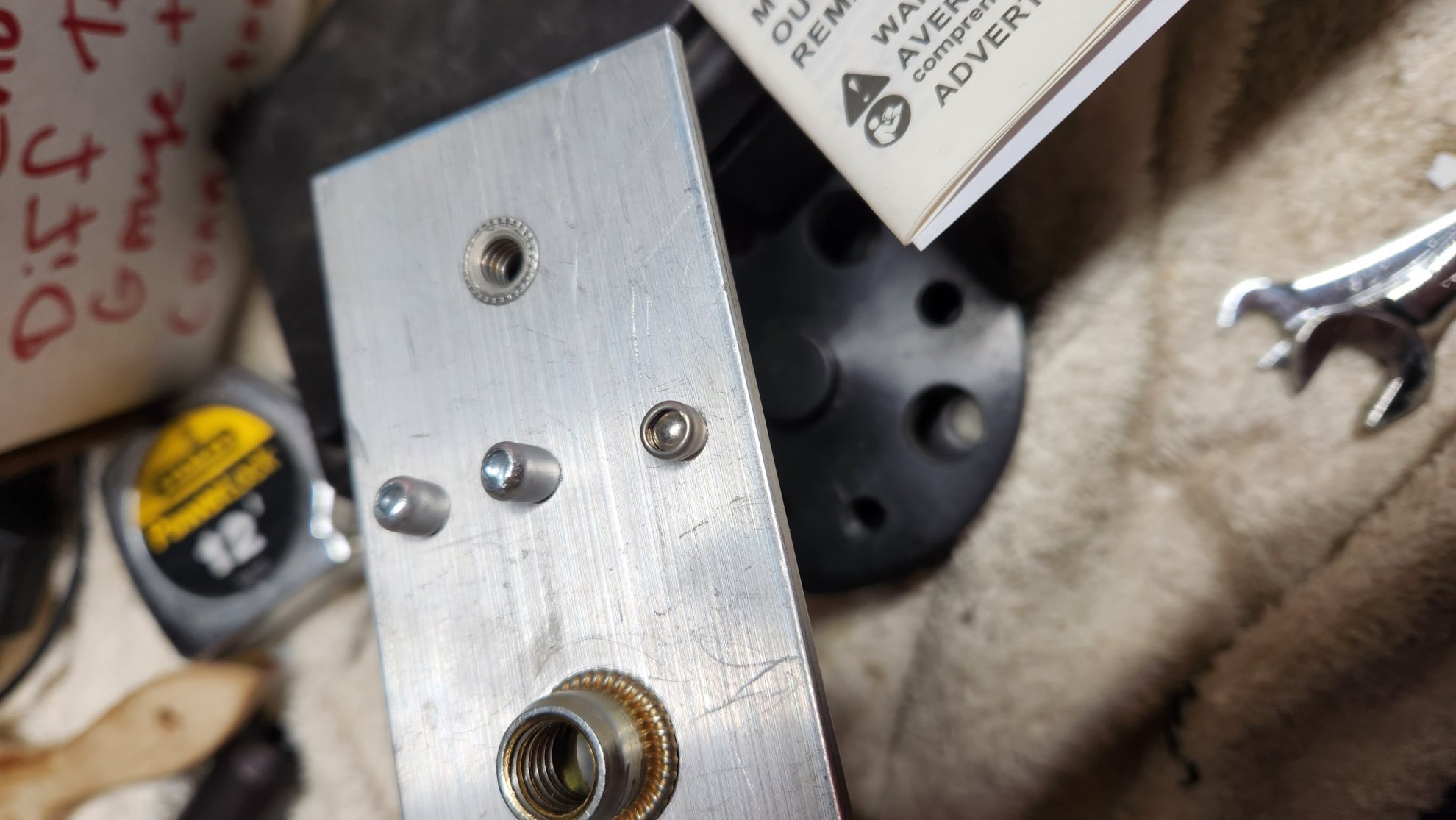

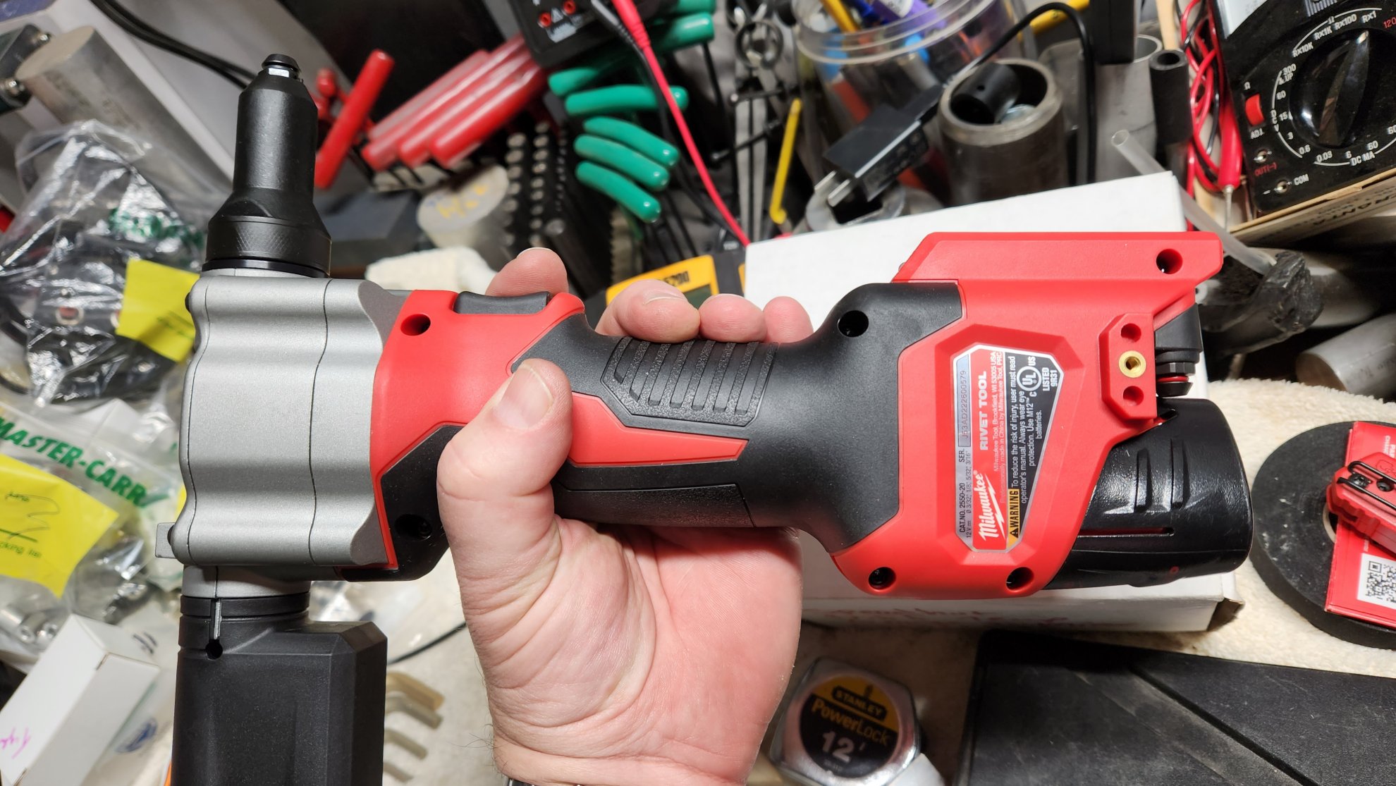

Got the Milwaukee gun going today. Pulled some aluminum and stainless 3/16" rivets without any issue. On the one that was really too long I had to pull 2x to make it pop. Otherwise really no problem pulling the stainless. It's slower then the pop pneumatic one but feels more powerful.
Also got the 6" snout which I could see being useful in a hard to reach spot or where the too would not fit.
Pics below of it and the pop pneumatic.
