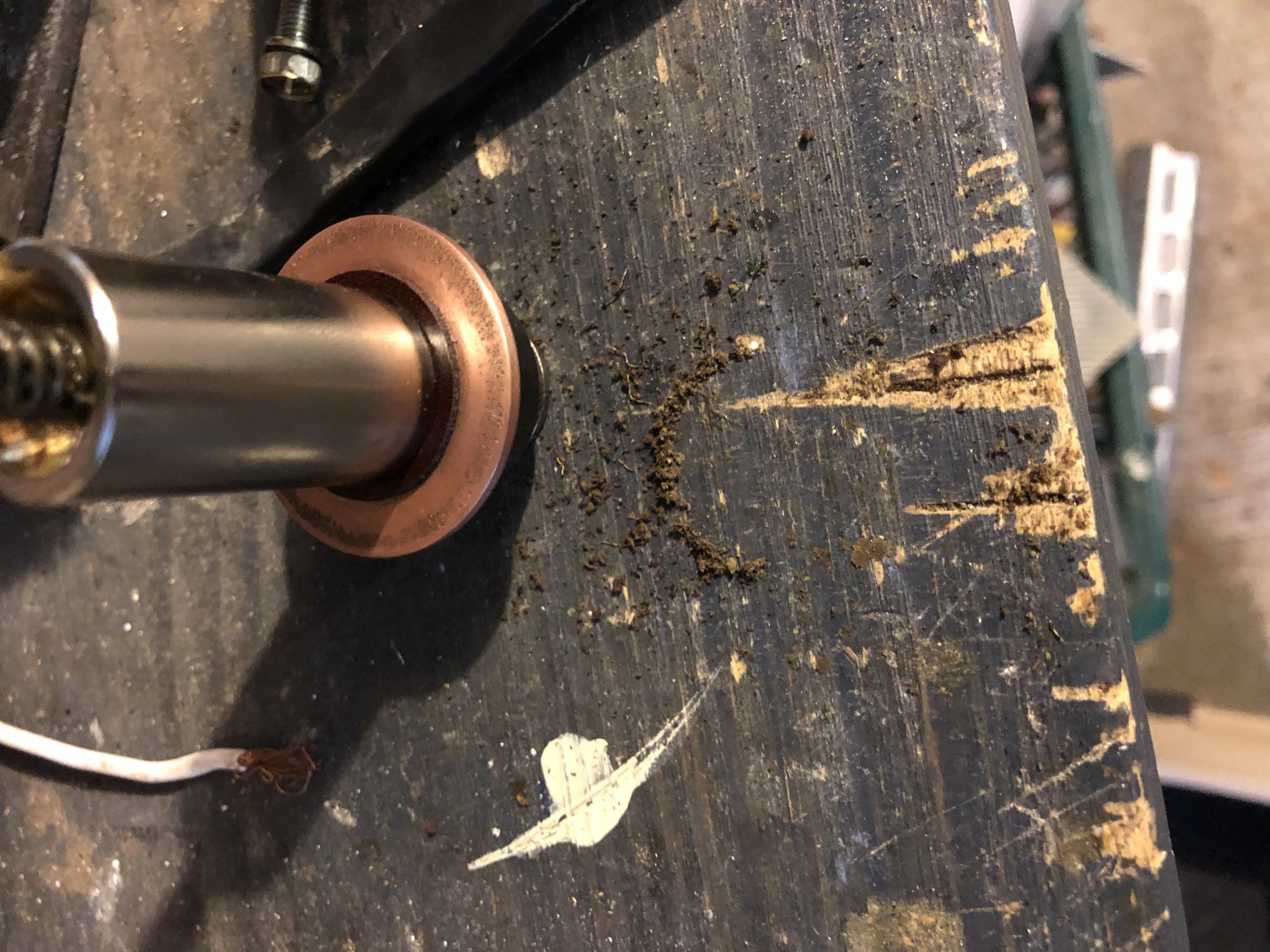

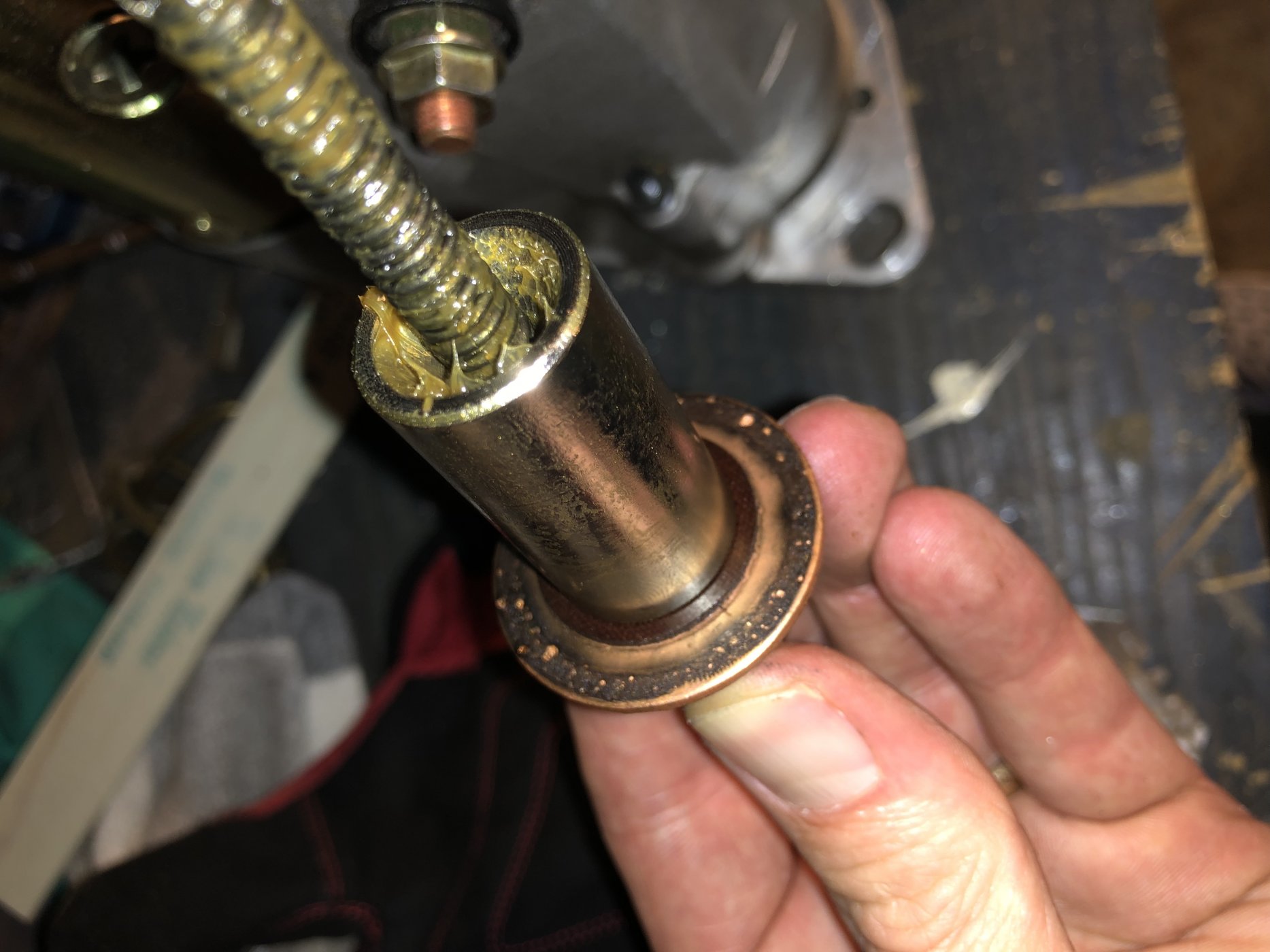

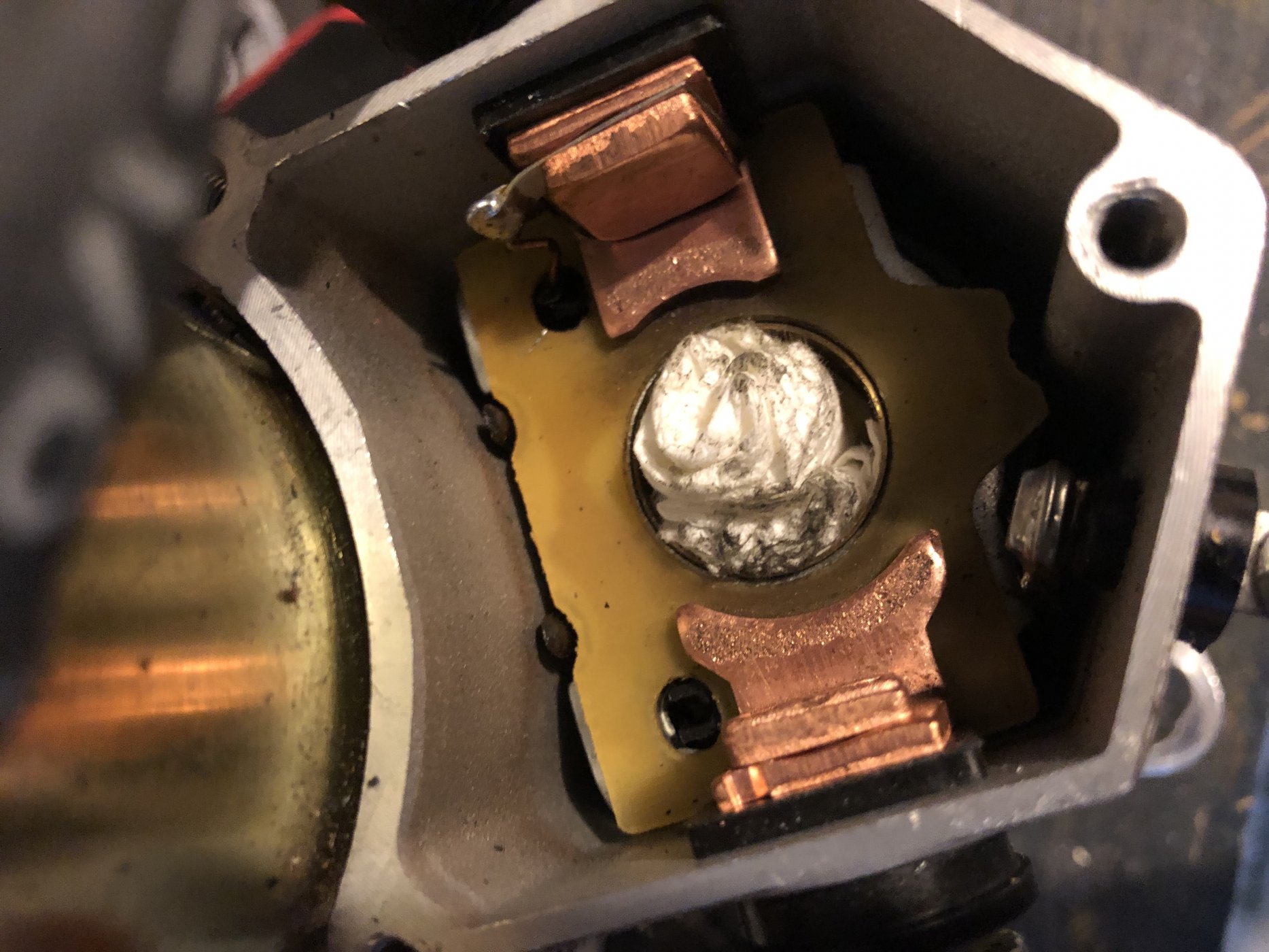

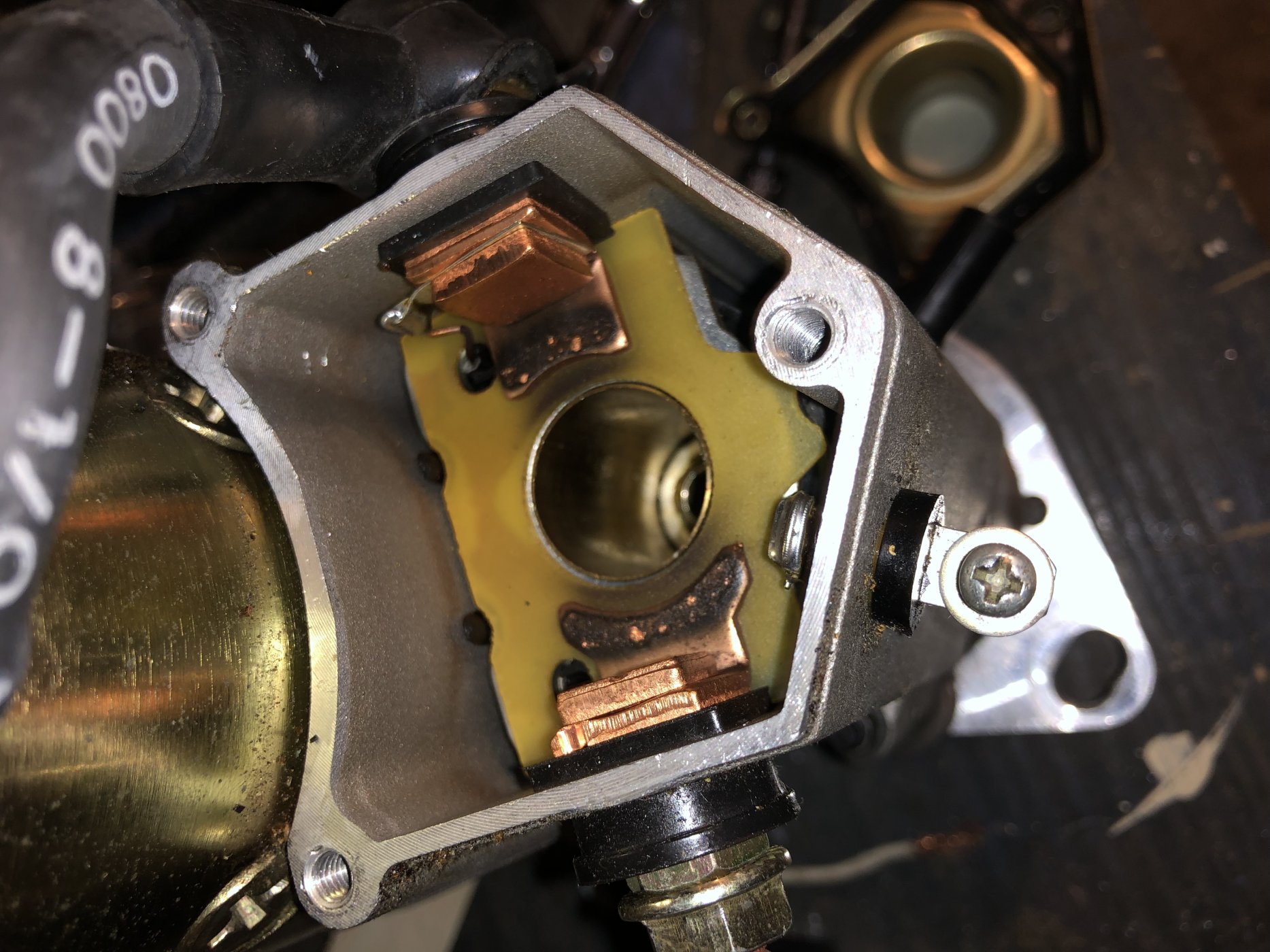

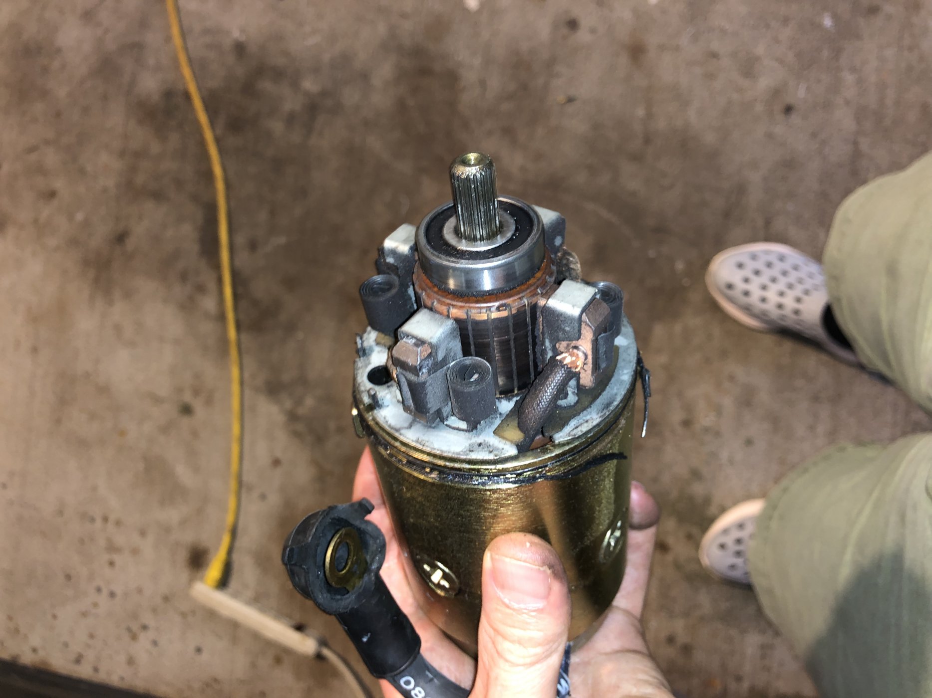

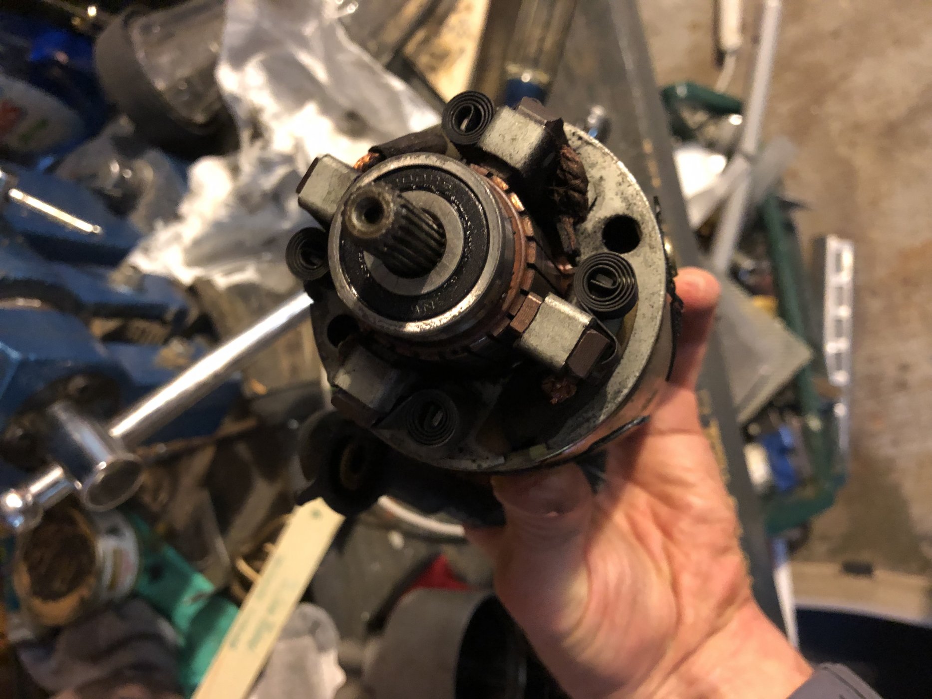

I pulled the starter and partially disassembled to look at the contacts and brushes - pics attached. Nothing here seems too worn, so I elected to clean the contacts, plunger and rotor a little and reassemble. Does anyone see something wrong?

Prior to installing the GM ECU, the car was very difficult to start, often requiring 10-20 seconds of cranking to get the car to fire. I'm hoping that my problem was just carbon buildup on the contacts that won't recur since it usually fires instantly now. There appears to be very little physical wear on the solenoid contacts, and the brushes have plenty of material left on them.

^ have not done so, didn't even know what a growler was. I elected to reinstall starter after cleaning everything, will remove and have it rebuilt if problem recurs.
