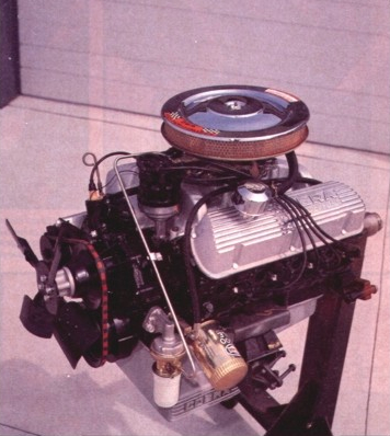

I was talking with a coworker today mainly about the 289 HIPO in 1965 and 1966 Mustangs and told him Ford painted them all black in the K code cars and I figured this may of carried over to the GT40 302 engines? Not sure though about the 302.
Was the 289 HP ever Ford Blue?
Was the 302 GT40 engine ever Ford Blue?
Below is a picture of my engine and what struck up the debate. He says a friend had a HIPo Mustang with a Blue engine that was factory correct. I beg to differ from my past information though.
Correct me if I'm wrong please....
Ford changed the engine color to blue for the 1966 model year.
Before that blocks were usually black with different color valve covers and air cleaner to identify the output level of the car.
On 1966 and newer fords valve covers and air cleaners are also corporate blue.
There is a lighter corporate blue for later model engines.
K-code motors were black with gold valve covers in '65 and all blue in '66.
Hope this helps.

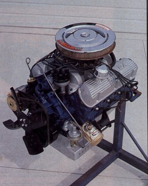

Here are pics of 100 point perfect restored Shelby GT-350 motors
The '65 motor is on the left.
Now that looks like my 65 Mustang HIPO Motor.
Blue in 1966 I didn't know and is probably why he was so adamant about the color on his friends 66.
Corporate decision Allen - Ford Blue all the way across the model lineup for the '66 and newer.
Shelby was so cheap that he reused the valve cover bolts from the all black or all blue hipo motors. Hence a perfect restoration has painted valve cover bolts holding down the CS-powered by Ford covers.
All 302s are blue also.
If the chrome Dress-up Option was chosen for '65 or '66 Mustangs the air cleaner bottom would still be engine color and only the air cleaner top and the valve covers were chrome.
