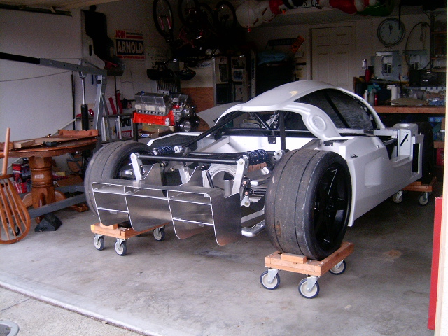

Make some
Howard Jones
Inexpensive casters will do. I think mine are rated at 300 pounds each and they have lasted for 20 years sofar. Remember there are four per corner so pretty much anything will work.
Try and get at least 4 inch wheels and make your wood thick so you can lay under the car when it is on its wheels up on the roll arounds. You will find you crawl under the car all the time to fetch stuff you drop, check on a tight nut or bolt, even drain the oil, etc. Go for about 8 or more inches total height. This will give you about a foot clearance under the lowest point on the bottom of the car. That's enough to do most minor stuff and not too high to reach into the engine room from the top.
Here's an example of some wheels on Amazon that would work. Google 4,5 or even 6 inch light-duty casters. Don't get a locking caster, you don't need them, and get solid tires not air-filled.
A few pieces of 1/2- 1 inch thick pieces of plywood glued together are plenty strong for the tables. Put some stops on the ends to prevent a roll-off.
You'll use these for the rest of your life.

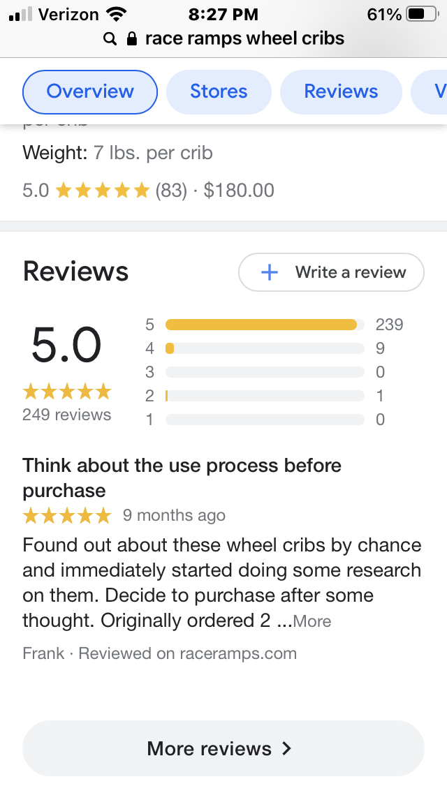

Brian Kissel
Thanks for that Scott. I hadn’t seen those before. When I checked online, they had 239 five star reviews out of 249. And 9 four star reviews. Will be adding those to my shop soon.
Regards Brian
