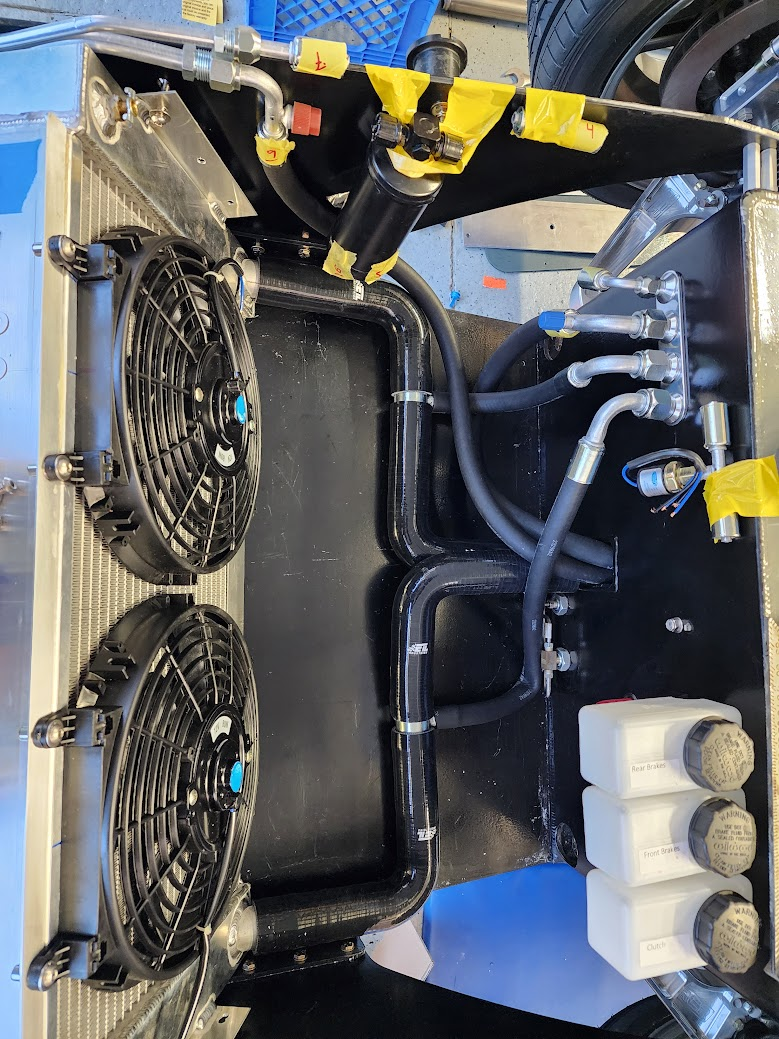

I use LORD GLUE.
https://www.chemical-concepts.com/p...F3Si1Zo5rzoXb31EXIPS_OIhkrOvvYFEaAtkMEALw_wcB
Been using it for 20 years... and never failed me.
Used it to install 90-degree L on the top of radiator, to hold fan mounts:
