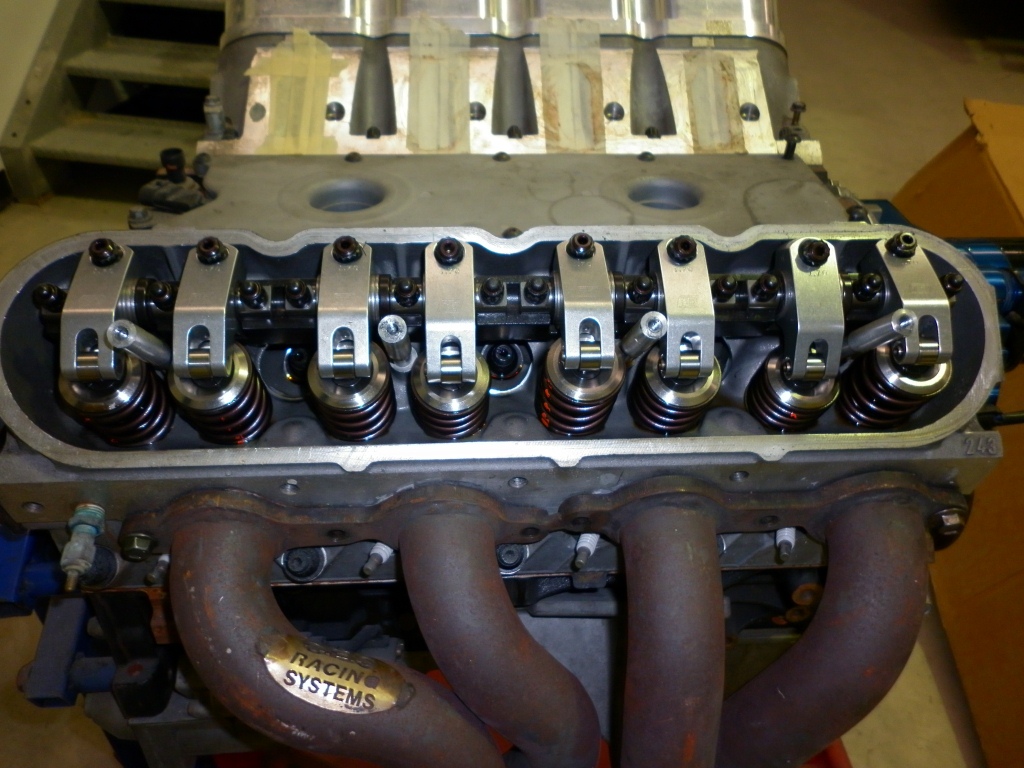

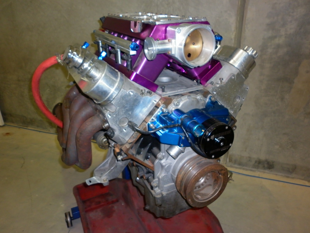

I had an LS much like you have asked about, 410 cubes, 760hp and went beyond 8,000rpm.
It wasn't cheap more than the money you have mentioned above (but things were more at the pointy end then)
It had Ti intake & Inconel exhaust valves, Competion Cams solid roller (290deg @ 0.050" & .750" lift), T&D shaft mounted rockers, triple valve springs, ultra light weight pistons, titanium rods, Cola Crank,Custom intake we used an Iron block for strength, an aluminium one probably would have done well too but the weight penalty isn't that great.
It sounded awesome too

Well spotted, those heads had thousands spent on them too, we sure maxed the air flow potential out.
I had it in a Holden VY ute that I drag raced
