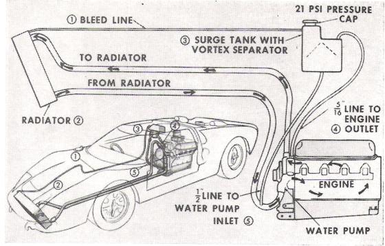

I would design the power train placement to dead level and a low as possible (clearance to ground interference) with attention to driveshaft angles being my primary consideration. Then I would deal with trapped air in the coolant system as a separate problem. Self bleeding systems in GT40s are well known, inexpensive to implement, and 100% effective.
1 or 2 degrees (front up) will have little effect in bleeding air from the entire coolant system. Maybe a bit in the engine but not in the rest of the car, especially the radiator. Assuming seals that seal and full of proper oil I don't believe that the gearbox lubrication efficiency will be impacted at all. Here's a pic of GT40 self bleed system. If you search bleeding air from the coolant system and other similar searches you will find a great deal on the subject. This problem has been solved for years.
