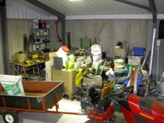

Hi Bill, Sorry I took a while to post here but for once priorities kep me off social things!
As Charles said I have pretty much finished my new garage so my first thing to say is to make it as big as possible as no matter how big it is it will still fill up with junk! My garage is 28 ft wide by 55 ft long or another way to say it is 3 cars wide by 3 cars long. With space to move about them in comfort. The picture below shows it as it is tonight and as you can see there is still some set up work to do.

The boat is not mine, so if you have a big garage be prepared to be asked to store stuff for family and friends. Or learn to say no. My brother has three weeks to get his boat out! I have also just had a 7.5 ton lorry load of furniture removed as enough is enough! And still the junk piles high!

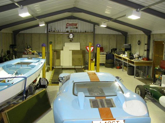

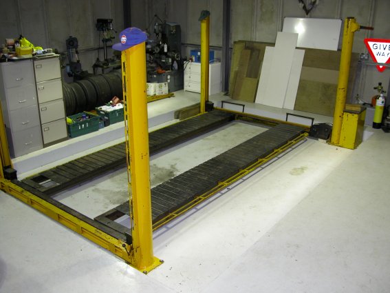

Sorry about camera shake on that picture. There is a matching pile of junk the other side of the garage! Between these two piles of stuff that is one third of the garage spoken for.
I am really please I put in my 4 post lift. It is a wheels free 3.5 ton bradbury lift. Bought second hand but professionally serviced and then installed. £1250. I made the dropped floor area 2 inches deeper than required so that the lift reaches full height with a regular car on it without hitting my ceiling. When lowered, the ramp is dead level with the floor so any low ground clearance car can go on the lift. The underside of the ridge is 12 ft 4 from the main floor level and 9 ft at the sides. You look like you have A frames for your roof structure so you may have difficulty getting a lift in. But they are worth their weight in gold as far as I am concerned.

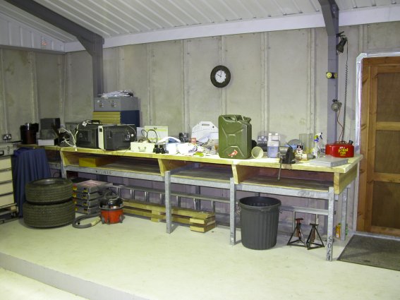

The ramp and the mill are both three phase, as is the rolling road brake testing machine installed but not visible in these pictures. I do not have three phase electricity but a three phase converter. Just plugs into a normal domestic socket. I can only use one machine at a time so one converter is sufficient. Mine is not a new funky digital one as they now can give out better results than the type I have. Transwave made mine and it can cope up to 4.5 HP electric motors. It is the blue box in the back ground in the above picture.
In that picture you can also make out a rail at waist height. That is my metal trunking for all my electrical circuits. Same price as plastic conduit but much tougher. I am installing 25 double sockets around the garage on three separate ring mains. Left, right and machine shop area.
I also have two separate lighting circuits so if one fails I can get to a backup light to find my way out the garage. When I finish installing it that is. My main lights are metal halide 250 watt units. I have 6 units for the whole garage. I plan to have flourescents over the work bench and each machine gets it own regualr work light. I also have two flood lights inside so that when I forget my brain and having turned off the main lights I can go back in without having to wait the ten minutes for the metal halide jobs to strike up again. Outside lights are useful for getting to and from the house if you are any distance away.
The garage is also wired for TV, cable, telpehone and is heavily alarmed. No windows at all.
Have you thought of putting in a loop sensor in your drive way? Cut this into your driveway in front of the garage doors and no one can get a car out without triggering the loop. What you switch on with it is up to you!
This workbench cost me £10. It is 15 ft long by 3ft 8 deep. All came out of a skip except the screws holding it together. Only have one workbench as otherwise you will have one like this that is piled high with overflow junk. The netal frame is a pallet that was made to carry plastic soffit and fascias. It is now upside down and has been shortened to this lenght. The woodwork top is my creation and is designed as strong rather than clinical. If I want a dead flat surface I can put a metal plate on it to suit my needs. As an amateur a 2 ft by 3 ft metal plate 1/2 to 1 inch thick will do as an engineers surface for my skill levels. Bolts in each corner allow level adjustment.

Gee, guys reading my verbiage as I write it. On the wrong side of the planet too! Now that is cool.
Ron, get your ars* over here!
Bill, I really plan to remove the piles of junk. I am planning on getting more shelving in. Current shelving is only 10ft by 8ft by 2 ft deep. 4 shelves. Bottom one strong enough for gearboxes and the top one designed as a tyre rack. I want to extend this to 35 ft long. If you ask really nicely supermarket home food delivery chaps are not always keen to take away the delivery containers and these make excellent storage bins. But it is going to get worse before it gets better on junk. I have three other garages here, all full of junk. One is to be converted in to a habitable room and the other (double) is to be demolished to build my new home office. I have other storage that once re positioned will hopefully become a dry junk store leaving my garage free for metal and petrol related things. But in the meantime guess where it will end up? YARDSALE? Funny you say that as today I was at auction selling all that furniture. Did you know that the bottom has dropped out of the old furniture market? All proceeds spent already on new tyres for Wendy's Saab and 92 copper beech trees for a garden hedge. Dang it!
The lights are Fitzgerald low bay warehouse units. Full retail price is £154 but I talked them into letting me have them for £65 each. Julian is pl
