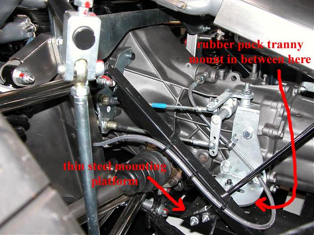

No guys. It is NOT the motor mounts and does NOT have to do with the Monocoque.
The transaxle mounting platform is made of normal steel. It is part of a sub-frame assembly that bolts to the rear of the stainless monocoque.
It is what the rear bodywork hinges on, what the pneumatic body shocks mount to, and that the tranny mounts to via 2.75 inch diameter cylindical rubber pucks
SEE PICTURE
That labeled thin steel mounting platfor is only 18 gauge steel at best that is merely stiched welded at the edges. The welds are cracking through and the plate is buckeling.

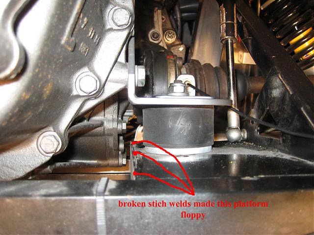

NOW. The mounting pints in the picture is the ONLY support place for the drive train other than the two motor mounts.
Between the softish rubber puck and the flimsy metal, I am getting alot of deflection.
I know it is an inch of deflection because you can see where the tranny has moved downward enough to hit the fram in the rear that is about an inch away.
I have ordered polyurethane from McMaster Carr to replace the rubber with a hard durometer material.
I will strenthen the crappy mounting platform and go with that.
I decided to go this route because, as you can see, the left tranny mount is also a mount for the shifter and this way things stay stockish.
I feel this will work well, but will require more work to strenthen the platform that just solid mounting.
I will let you know how it turns out.

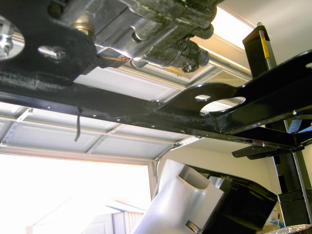

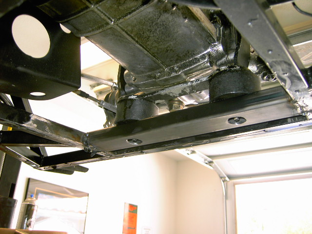

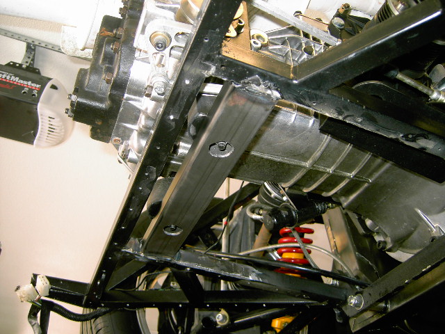

I cut out the sheet metal and welded in a 1" by 2" rectangular steel mount and that strengthened that area quite a bit.

I took off my sub-frame today and am ready to beef it up.
I noticed that the left side has been broken in the past and rewelded and that is why it is OK now. The right side is VERY broken and the mount is doing little good.
I will post pictures of my sollution.

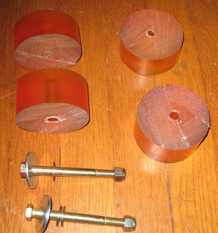

The polyurethane I have ordered from McMater Carr has this part number. [FONT=Verdana,Arial,Helvetica']8784K983[/font]
[FONT=Verdana,Arial,Helvetica']It is coming today, so it may not be quite what I want (durometer), but I have good confidence that it will be just right.[/font]
[FONT=Verdana,Arial,Helvetica']It is my intention to cut off two 1.6'' sections that will support the resting weight of the tranny and that will be under compression under acceleration forces. I will also cut off two 1.25' sections that will go on top of the tranny mount to accept engine braking and deceleration forces. I may change the dimensions how I see fit, but those are good starting points.[/font]
[FONT=Verdana,Arial,Helvetica']Think about this if you don't get it. There will be one long bolt that goes through this new assembly.[/font]
[FONT=Verdana,Arial,Helvetica']The stock rubber mounts work to dampen both acceleration and deceleration forces because they stretch on deceleration.[/font]
[FONT=Verdana,Arial,Helvetica']Since I can't bond a small bolt to either side of one Polyurethane puck, I will have one puck on top of the tranny bracket that will compress under deceleration. If you only ran one poly-puck and ran a bolt trough it, then you would have NO damping forces under deceleration forces as you would have the bolt in tension and metal-to-metal contact only.[/font]
[FONT=Verdana,Arial,Helvetica']I will post pics later of the Polyurethane, how I cut it, my new subframe strengthening, etc.[/font]

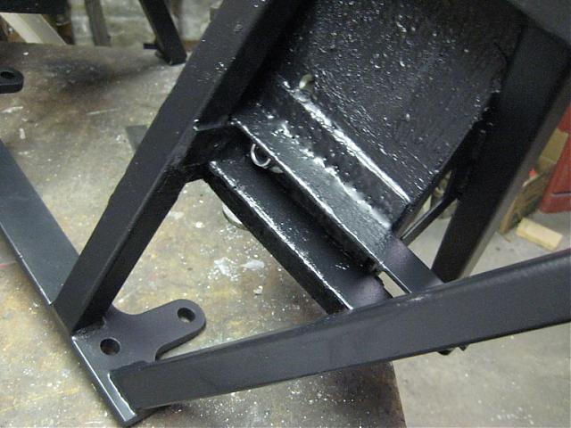

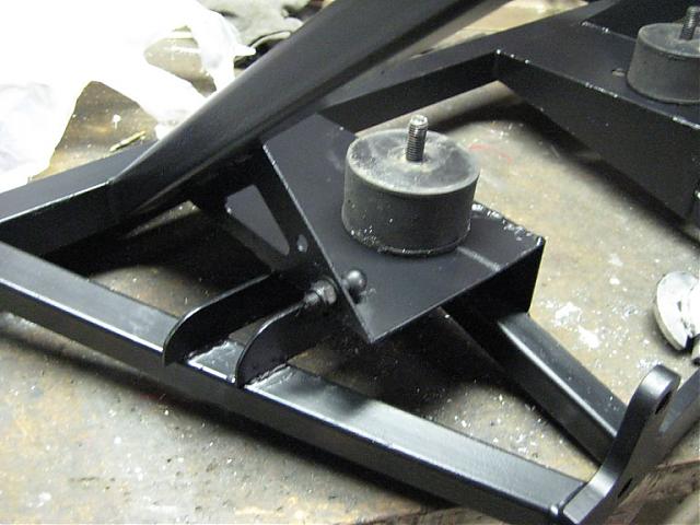

Lameo FedEx didn't "execute" my delivery today, but here are pictures of my strenthening project.
Mind you, I decided to put some undercoating in this area because I know water would get trapped here and you dont see it anyway.
The stock platform remains unaltered.
The two cross beams are incredebly ridgid and are welded to a new platform that fits against and below the old platform. The mounting bolt goes throught the old platform and the new one with JUST enough room to sapre between the cross beams for the nut. The placement of the cross beams is so that the load goes as directly into them as possible so as not to flex flat plate stock like if they were farther apart.
Also, notice the extra length of steel that is welded to the new smaller platform, the cross beams, and the 1 inch square tubing of the sub frame. this is to strenthen the area like crazy so the welds of the cross beams don't break under deceleration forces that want to pull it upward and away from the subframe.
I didn't add much metal to do this project and very little is visible from above. I am very happy with this fix and am confident it will be strong.
Casey

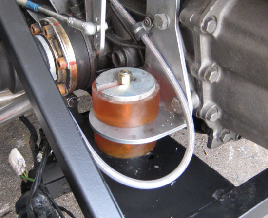

I finished my tranny mount project. The part number I lested from Mcmaster Carr a few posts ago was just right. I am very happy with its characteristics!
The polyurethane was 3"x6" and I was able to cut the right slices off so there was NO excess. Two 1.6" ish long ones and two 1.25" ish long ones. The smaller on top.
Now, I HIGHLY suggest you beef up your mounting platform like me if you use the polyurethane mounts.
The drive train bouncing and shutter is gone and there is NO noise or harshness.
The clutch this engages with a shutter, but that detrimental drivetrain bouncing is gone. I can live with the car now.
This was WELL worth the effort and the car is more solid and will stay together better.
I think all CAV's should have this mod done to them and for everyone to forget the dumb rubber mounts.
Casey
ID:	26432  Click image for larger version

I found an easy solution which has been perfect for my RF, hockey pucks. They are through bolted and lower the transmission approx 1". I don't experience vibration or shudder, cheap and very easy to find.

Nice Job!
What size bolts did you use?
I ordered the poly tube; I think I'll do the mod this weekend.
Thanks for the excellent fix.
