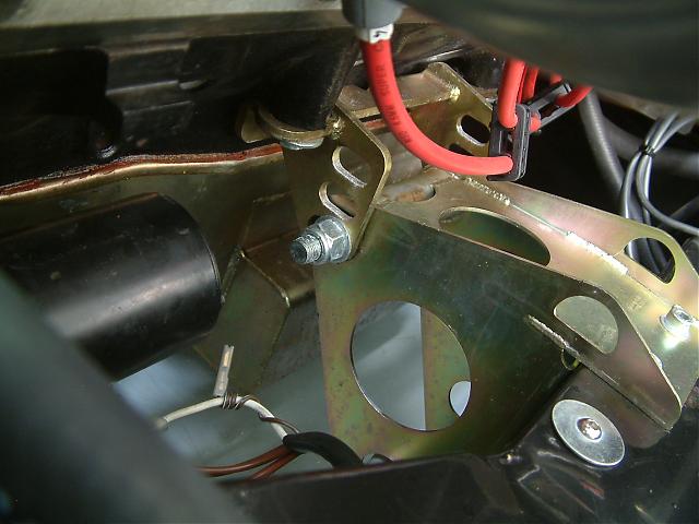

Hi Guys
I have tried many times to post these, so here goes..( again)

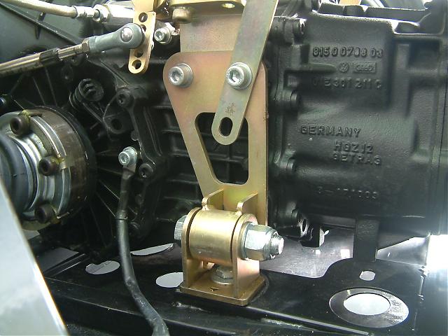

...and gearbox mounts for Audi 6-speed

Thanks for the pics, Jean.
Those motor and tranny mounts certainly look the bit. Just to make sure before I place my order, do the motor mounts bolt on directly to existing holes in the chassis (pre-100 car)?

Hi Ray
Yes they do, but you would need to drill the top two holes into the pre-100 chassis. A threaded plate is supplied, which fits inside the chassis from underneath.
MUCH stronger than 'old' CAV mount.
Jean
