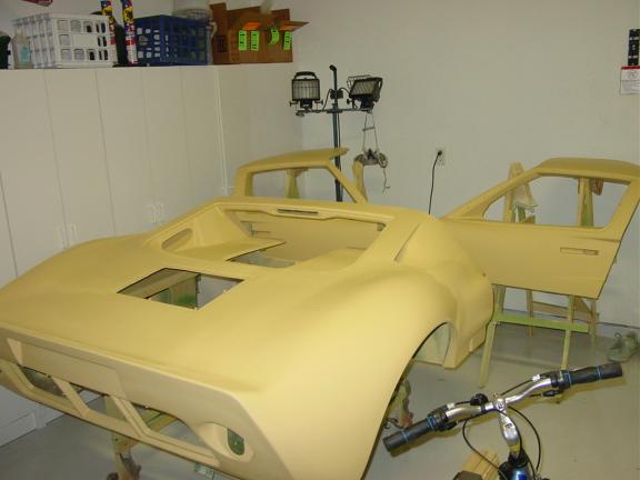

Second round of primer. Trying to apply color in two weeks over Memorial Day weekend

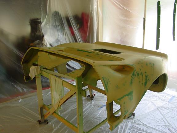

And after priming. Adjusted gun and actually sprayed much better.

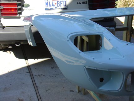

Well after many months of forced time off, I have been able to start back work. This past weekend I got color and clear on the front clip, spider, nostril and sill covers. Started on one of the doors but got a run and had to abandon it. Next step is to shoot the rear clip and doors, then mount it back on chassis in time for Christmas when my brother is here so I can make him help lay out stripes. Long day - 10 hours to do just this much work!

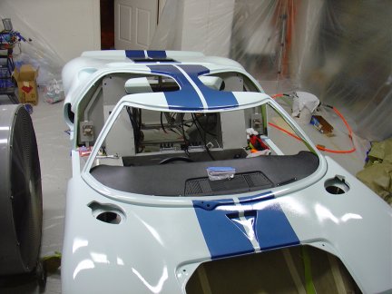

Old 12-01-04, 11:05 PM   #35 (permalink)
patbarry's Avatar
Gold Supporter
Join Date: Apr 2002
GT40: Houston, Texas
Posts: 678
Re: RF52

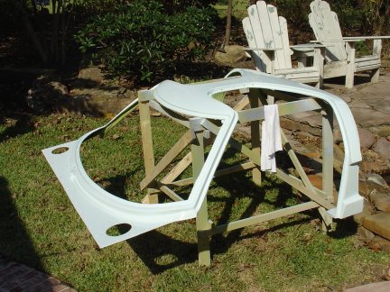

And spider. Color is from 1968 by Ford called Diamond Blue. Stripes to be Acapulco Metallic Blue.

Old 02-16-05, 09:17 PM   #36 (permalink)
patbarry's Avatar
Gold Supporter
Join Date: Apr 2002
Posts: 678
Re: RF52

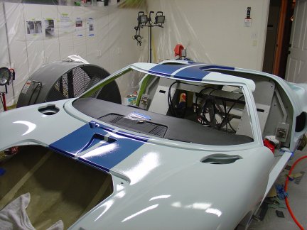

Well, yesterday I got the stripes done on the three main body sections. What a job! It took longer to lay out the stripes than it did to paint, touch-up and clear. Feels like I cleared a huge impasse, and may be actually see the finish.

Old 02-16-05, 09:18 PM   #37 (permalink)
patbarry's Avatar
Gold Supporter
Join Date: Apr 2002
Posts: 678
Re: RF52
And another. Still need to sand, buff, all that stuff, then coat the undersides.

Old 02-16-05, 09:19 PM   #38 (permalink)
patbarry's Avatar
Gold Supporter
Join Date: Apr 2002
Posts: 678
Re: RF52

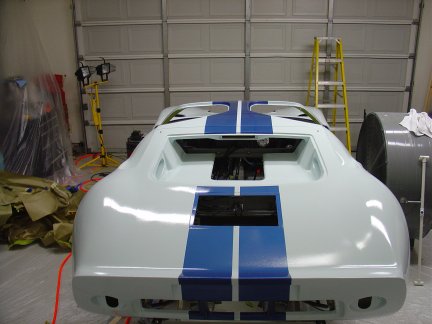

I can safely say, that while happy to have done this (for over a year now), I will never paint another car!

Old 02-16-05, 09:53 PM   #39 (permalink)
Join Date: Dec 2004
GT40: New Orleans, Louisiana
Posts: 114
Rep Power: 5 MichaelHarvey is on a distinguished road
Re: RF52
That's a really nice color combination. How many coats of clear did you use? Keep me posted if you ever bring your car to any shows on the Gulf Coast. I'd love to check it out.

Old 02-16-05, 10:10 PM   #40 (permalink)
Faili F's Avatar
Faili F
6 Tenths
Islamic Republic Of Iran
Join Date: Aug 2002
Location: Axis Of Evil
GT40: A Fake one
Posts: 699
Rep Power: 14 Faili F is a splendid one to behold
Re: RF52
Very different and very nice combination. Are the wheels going to be painted? One of the english guys had similar color combo with wheels painted the same as the strip, looked good.
