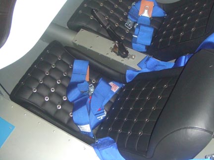

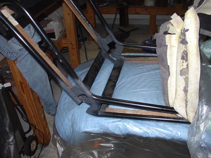

Mark, I did some cutting and bracing on my seats for the 5 point harness. Here's some pictures.

Hi Pat, great job, and congrats getting it down the road! Can you tell me besides modifying the cross-member just under the pipes , what else did you do (frame under gearbox mod? engine, trans mounts) ? I installed my engine ,pipes and box in stock trim just to see where its at clearance wise. I want to "de-angle it" as much as possible. Any help much appreciated. Dan W
Dan, I did the 'hershal' modification. I got rid of the crap under the gearbox and just used the two uprights sitting on 1" thick rubber spacers. I cut and rebuilt the crossmember. All this screwed up the location of the muffler brackets, so I welded on tabs to the chassis and then fabricated some real simple muffler supports. Absolutely nothing fancy. I reinforced the gearbox mounts with an additional gusset plate added to each mount. I made no changes to the frame. The absolute biggest pain in the rear was modifying the exhaust pipes. Once I know everything is good I'll send them away to Jet Hot - the Eastwood stuff did not work.
If you would like pictures of something in particular, let me know and I'll snap away.
