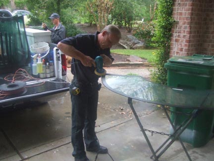

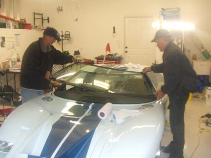

Glass in, hopefully gearbox in this weekend. Had to do some sanding on the glass, total time about an hour and a half. Still fighting a guerrilla war with air in the cooling system.

How much sanding was required on the glass??

Hilly, he took about 1/4" off both lower corners, then just smoothed all the other edges out. Went through about three or four 80 grit sanding pads.

I assume that you used ‘normal’ sanding products. No special exotic types!
Were there any concerns with overheating the class during sanding? I was afraid of cracking the class if it got too hot.

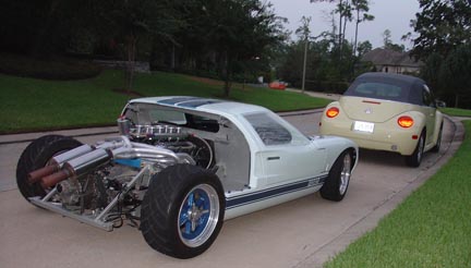

Finally made it out of the driveway for the first time. Up and down the street a couple of times. Clutch pedal is long, the brakes a bit long, my cooling fans don't run and the car bottoms over the end of the drive, but by God, it finally went somewhere!

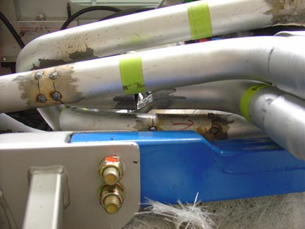

Header pipes required a lot of cutting, shortening and lengthening before the collectors would fit. Then the collector needed to be cut off the muffler to get the mufflers to line up. Then new muffler brackets had to be built since I had lowered the transmission and fixed the pipes.
Now I just have to stick on the heat blanket and re-install the rear clip.
