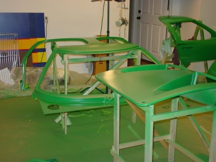

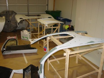

After months of sanding, ready for paint. I am sure, however, that after the prime coat is applied I will find, many, many defects. But hey, I'm a rookie!

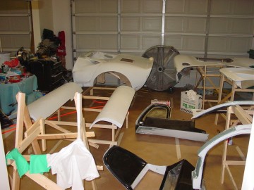

And again...

Re: RF52
Pat,
Hershal and I are just haveing a few stubbies and everything looks great from here [img]/ubbthreads/images/graemlins/tongue.gif[/img] (only had ONE beer)
Keep up the good work,
Robert & Hersh [img]/ubbthreads/images/graemlins/smile.gif[/img]

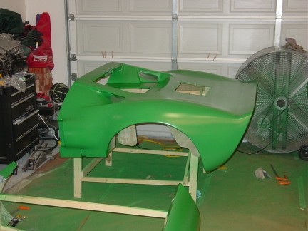

Thanks guys, I'm fixing to get myself a stubbie as well! Got it primed yesterday, what a bit of work! About four hours to prime. Boy do you find out where more work needs to be done. Will hopefully have the imperfections corrected and spot primed by next weekend so I re-sand and get ready to shoot color.

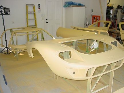

and another

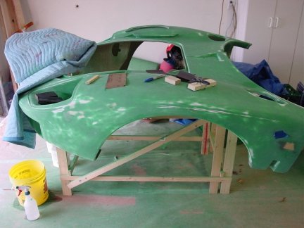

last one

Yes and no! I was planning on using Ford's Grabber Green metallic with translucent stripes (black mixed with clear coat), but now I'm wary of metallics. There are so many contours on the body that I have to question my ability.
Hershal, any thoughts?????

Let me speak for Hershal on this one--Hersh I hope you don't mind.
A wise man once told me "when you think you are done sanding, sand it again, then come and interupt the golf game on TV, until then just get back to work"
Have fun,
John

Pat,
You're either gonna keep sanding until you are happy or you will just say F@#k it! and paint it.
Hersh
Pat,
Hersh can not hold his Ausie liquor (not licker and no ears jokes) and the quality of finish is directly related to the quality of prep work done / needed.
The primer will show any defects so look closely and use your fingers. They are very sensitive and will feel all bumps etc..
Best wishes,
Robert
PS John, Hersh will be home soon and you have done some sanding or he will be mad (I think he is anyway !!!!) [img]/ubbthreads/images/graemlins/grin.gif[/img] [img]/ubbthreads/images/graemlins/grin.gif[/img]

Pat, it's looking great...you're making good, steady progress.
All, I think Pat's concern was in getting the metallic finish sprayed on evenly so that the metal flakes don't bunch up or flow, not his ability to do prep.
I got a fair amount of sanding done myself this past weekend, but Pat's way ahead of me. My goal: 20 hours per week through March and April.

Looking really good Pat, dont worry to much about the metalflake, take your time and spray light, light coats,
I'm sure it will turn out great [img]/ubbthreads/images/graemlins/laugh.gif[/img]

Thanks guys, appreciate the encouraging words. Mark is right, I am questioning my ability only around the air intakes feeding the engine on the rear clip. I think I can get everything else pretty well. I have yet to break out my touch-up gun, maybe that's key to success on the intakes. I'll know come this next weekend, hopefully.

Heh, look at all that green on Pat's dust mask...

You noticed! After a break I forgot to put it back on and it didn't take but a minute or two before I had to stop. I do like HVLP though, a regular convential gun would have put a lot more paint in the atmosphere.

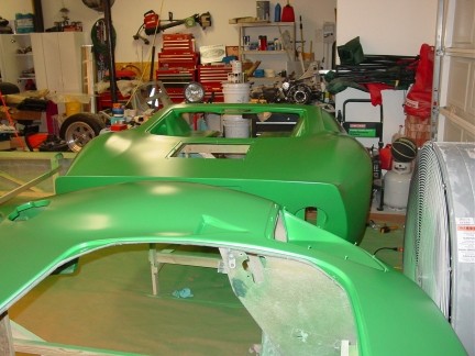

Just before second coat of primer applied...

And primer applied. This stuff dries way too fast for me, very, very easy to get dryspray if you're not careful (I did and will have to re-sand the rear clip and re-shoot). Going to see if there is a slower drying version available. Anybody got any tricks to spraying the engine air intakes? Very tough to manoever the gun in there.

Pat,
It's got nothing to do with the primer. It's the thinner. You need to buy a thinner for a warmer temp. They make three different kinds. There is a fast dry, a medium dry and a slow dry. Talk to the supplier and he should give you the right stuff.
